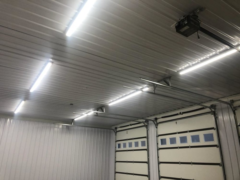

Biggest drive in doors you can get, brightest LED lights you can get, best insulation you can get, and great cooling and heating..
