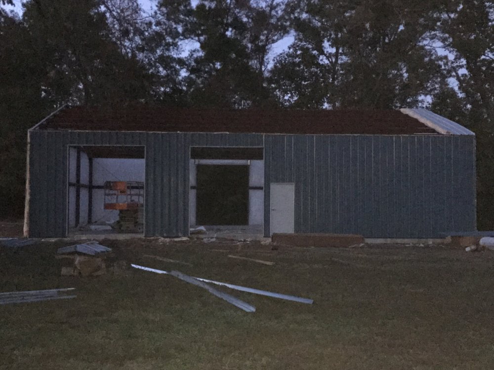

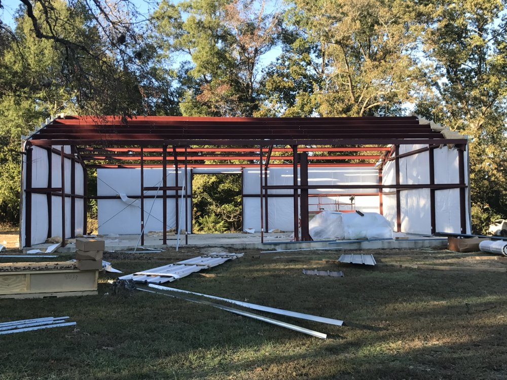

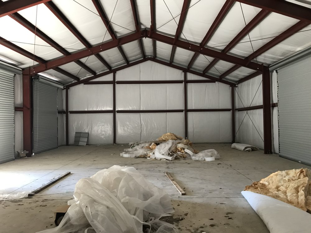

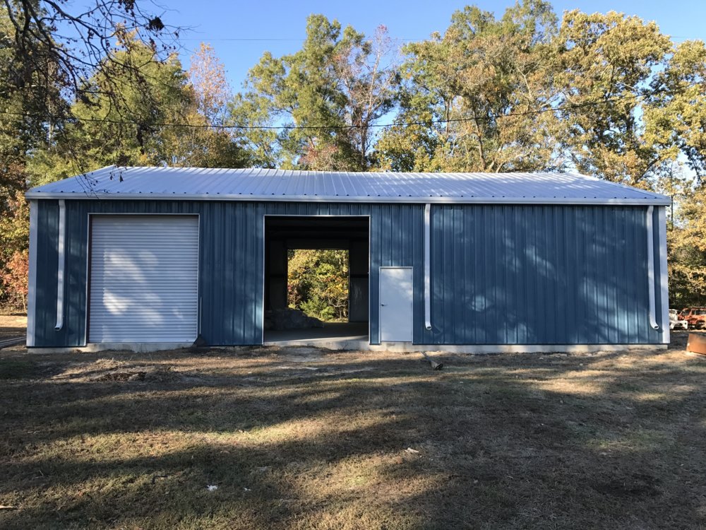

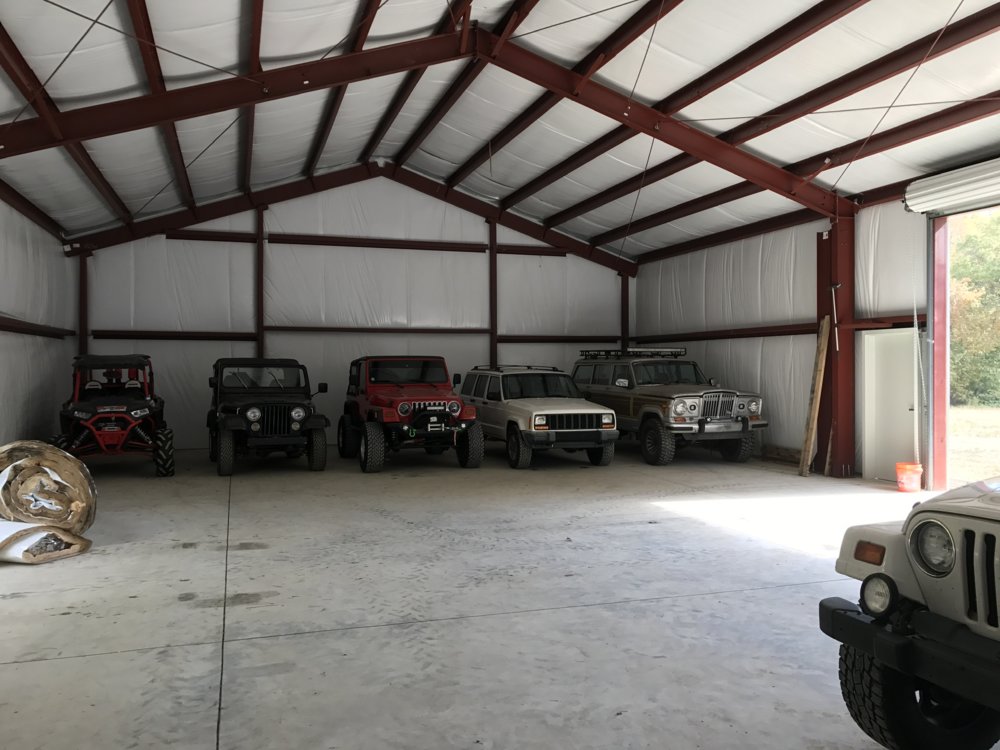

E30326D4-BBBD-4A84-9CE6-2354099E623C.jpeg 97B3C293-3BF7-4792-91A1-95419A63ED62.jpeg 8676DE2F-02DF-473E-B0CA-9F3E2D520581.jpeg FDF54CEC-3918-476A-8CBB-E719982FC56B.jpeg 10E320F7-6014-4F04-B09D-281EF741F3D9.jpeg
I had my shop built 2 years ago. Turn key, although I contracted the concrete, building and construction, and electrical separately.
Mine is 40’x60’, 14’ walls and 5:12 roof pitch.
2 roll up doors and a man door on the front, and a roll up door on the back.
I had the concrete done by a family friend and got a screaming deal. Slab is thickened down the middle for lifts. ~$10k for grading and monolithic slab
The building was engineered by ARCO, to my wants and specs. It is built to commercial code, and way over engineered for weather. ARCO recommended and scheduled a contractor to receive the materials and put it up. 6” insulation on the ceiling and 4” on the walls. ~$26k for the building and ~$11k for construction.
I contracted an electrician for panel, wiring, LED lights and outlets, etc. I went super basic and simple to save money. ~$6k
WARNING: no matter what size you go with, it will fill up quick! I went bigger than I thought I wanted, and it got full seemingly overnight. Budget constraints are one thing, but go with the biggest you can afford. I’m looking into other options for small parts storage now, and it’s only been 2 years.
If you’ve got more specific questions, you’re welcome to give me a shout. I think ARCO has a referral program that will save you some money, and I’ll get a referral fee. You’re also welcome to come check it out in person if you want to make the trip up.
