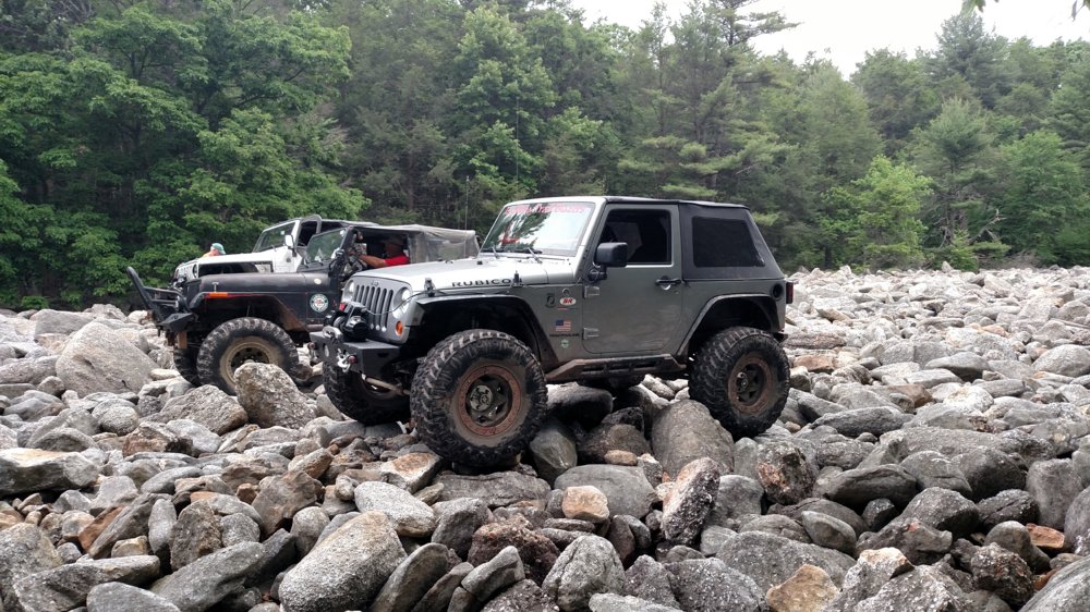

Rausch Creek, Made the entire Rock Creek trail from end to end unassisted . Pictures do no justice on this trail, been a lot of work to get the Jk to this point of capability, couldn't be happier!
Nice having something so capable and still ride pretty damn good on the street huh?
I did the Cali to nc trip in mine on 37" swampers so it's definitely do able lol

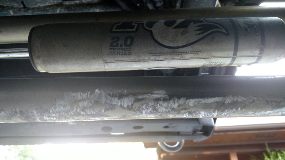

Well, I have decided to do a spring change. After the cage, gas tank skid, my fat ass and tools.The Jeep has gained weight, and while at speed on trail over berms I could feel the rear bottom out on both sides , I can tell the Jeep has sqauted after all this work. I orderd a set of 3.5 springs today, which will take care of this issue.
I thought about putting some 3/4 spacers in but decided that a spring change would keep it correct.
I spoke to the shock expert today about this and I think some tuning may be in your future.

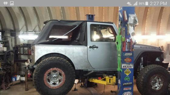

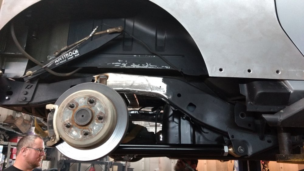

Stopped by today to check it out, fenders fit great, forgot to get a rear shot. It has been a ton of work already. Suspension is being started, the powder coated .250 wall lowers are super sexy!!
