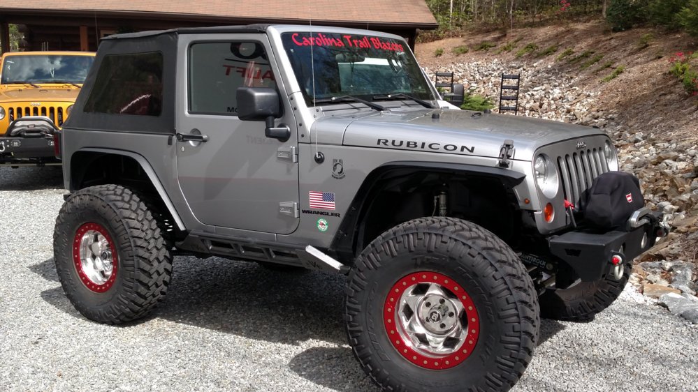

What is the benefit of the sectional beadlock rings? I'm curious because I have never seen them before.
Easier/cheaper to replace one fubar section than having to replace an entire ring. Plus you can go all mall crawler and have multiple colors.

That may be their sales reason, but manufacturing is alot easier with less scrap. That's likely the real reason they make them like that.
I'm not completely sure about the reasoning on the sectional rings, but I can tell you they were a breeze to assemble, checked air today, zero leaks! Just got home from Clark Tire morganton, they balanced very well, 3 averaged 4 ounces, one took 8 ounces.

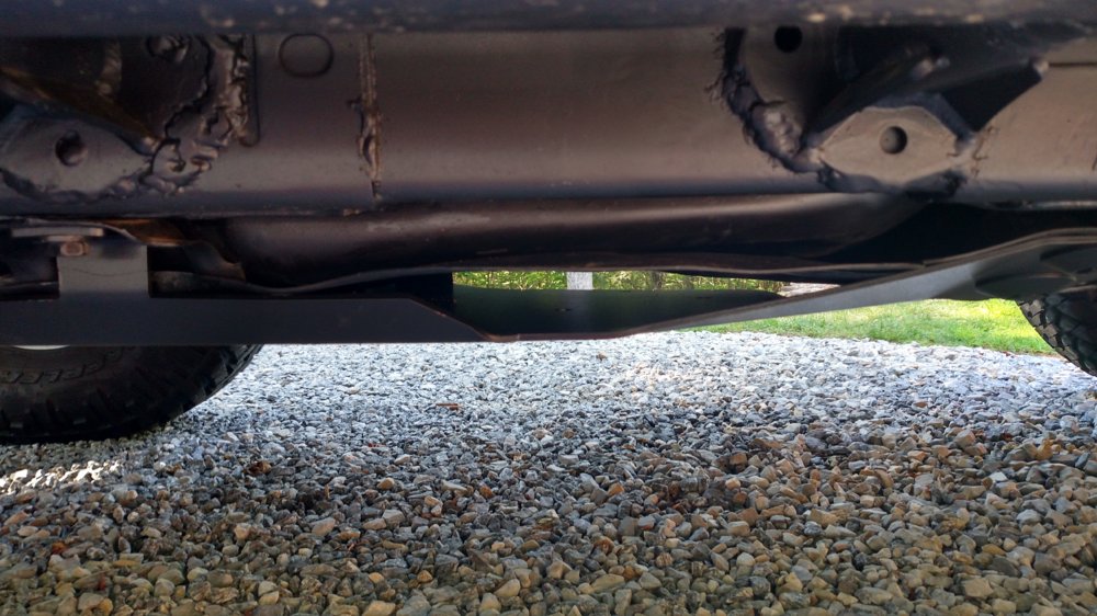

Got my gas tank skid done , and finished up my trail cage. I needed the gas tank skid bad, had a hell of a time getting it on. It fits over the stock skid and with it being smashed/ spread out it was a real PITA. You can see the gap between the stock and the new skid.

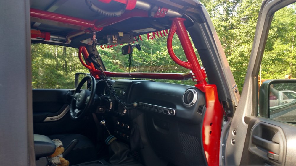

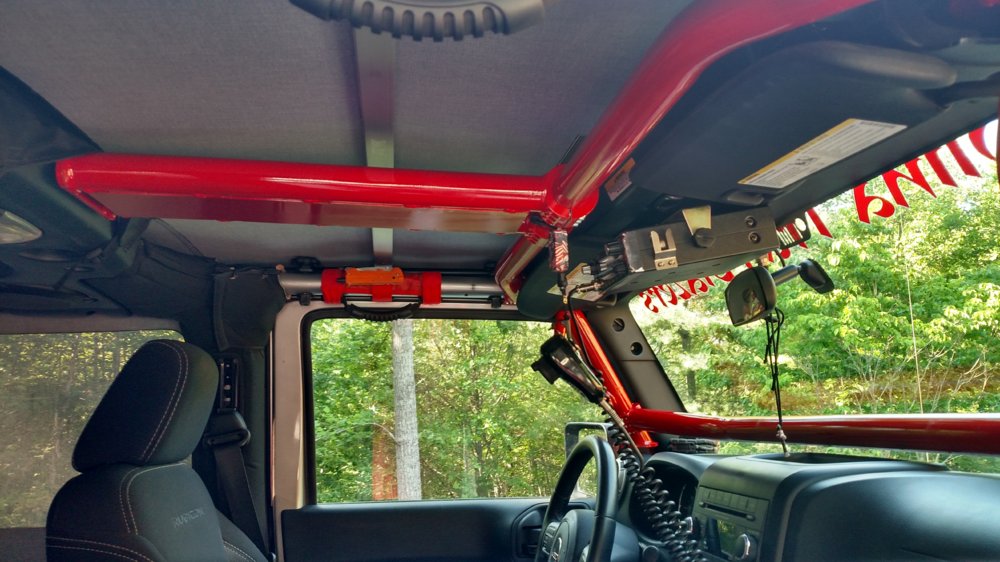

I am happy with how the cage come out, it took a good bit of time and a lot of trimming. This is the Rock Hard Trail Cage. No, it is not a full welded in cage, but it should keep the windshield off of me and help the Jeep hold up in a hard rollover. I researched this cage before buying and it has proven itself in rollovers, should do just fine, and didn't cost a fortune.
