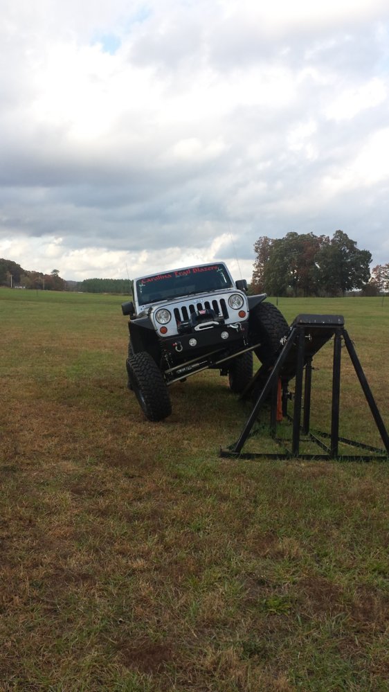

Jason was crazy enough to let Joe and I take it up the road. Boy has he created a monster. It's like driving a large go-cart on the street and in lo range it's just stupid lo.

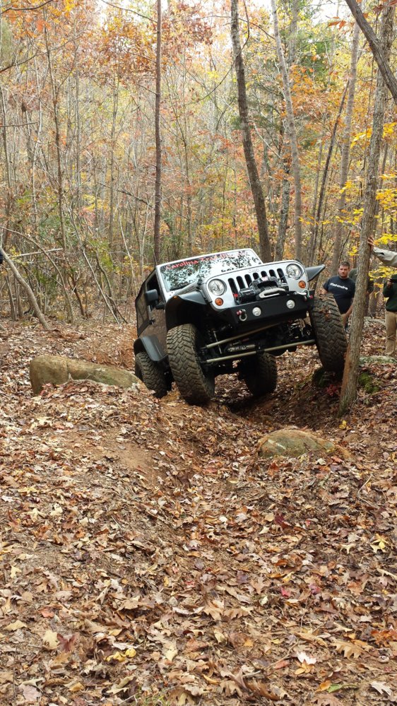

Finally got a really good shake down at Big Creek on sunday, worked exactly as it should, no mechanical problems at all. Jeep is a beast and performed above what I expected.

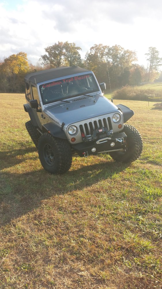

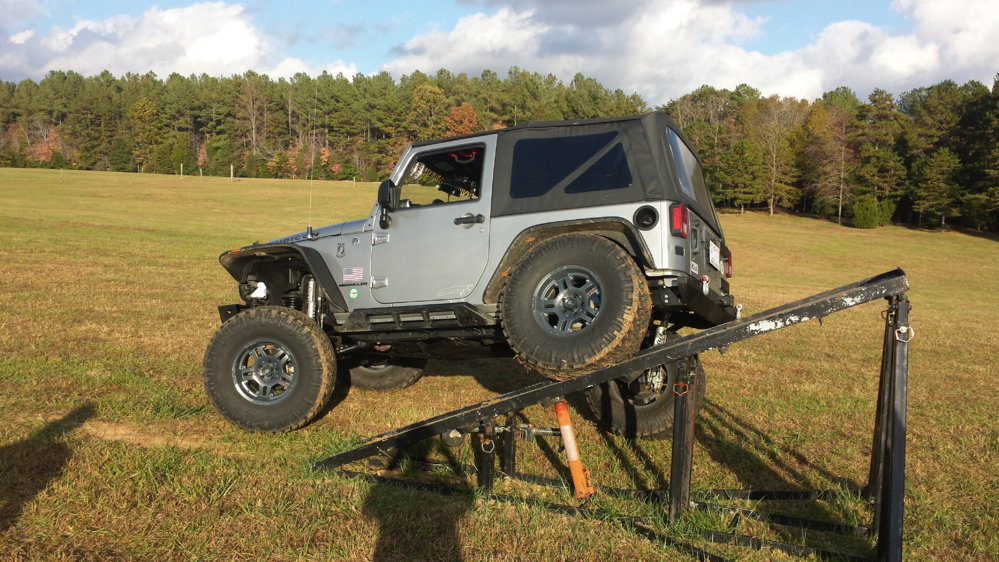

I figured it was eventually going to happen and crushed/ tore the right side bushwacker flat flare almost off. They just stick out to far, decided to reuse the stock flare and trim them down very slim, about 2.5 inches or so, I would rather hit tire first, not flare. Lesson Learned!

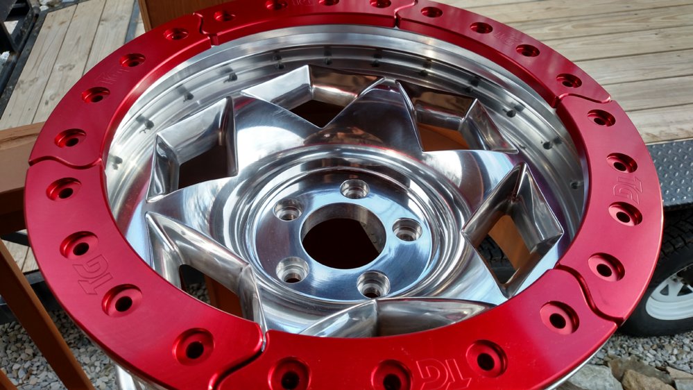

Medikshn is still performing great, but time for upgrade. Beadlocks soon to come!! Put another dent in the door at windrock, right above the last driver door dent, things aren't going well for that door.

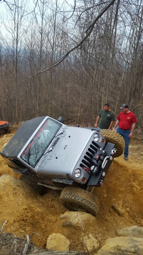

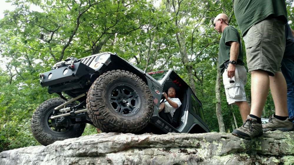

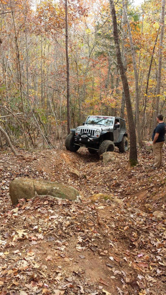

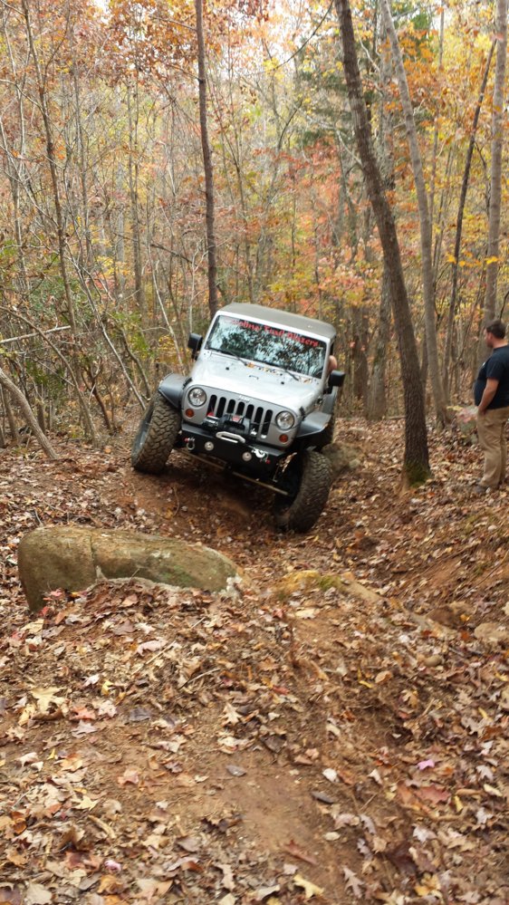

Just about hydrolockrd it, in the Pic above I ended up in that passenger lean for a while trying to get through. Started smoking like hell, shut it off, winched out, turned the key and wouldn't roll over. That was a bad feeling there, let it sit for 5 mins, it fired up like nothing ever happens. No Skeeter's for 200 yds!!

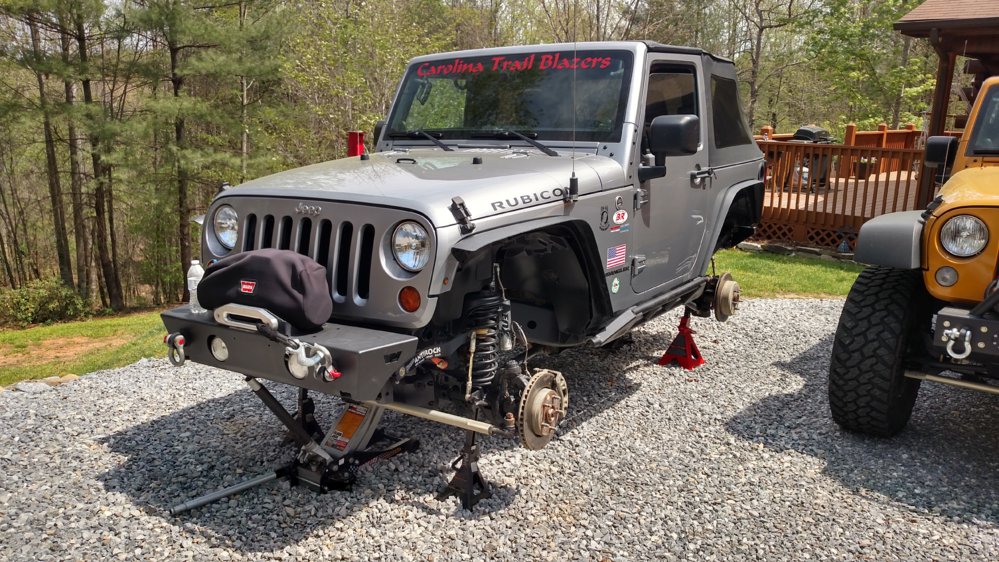

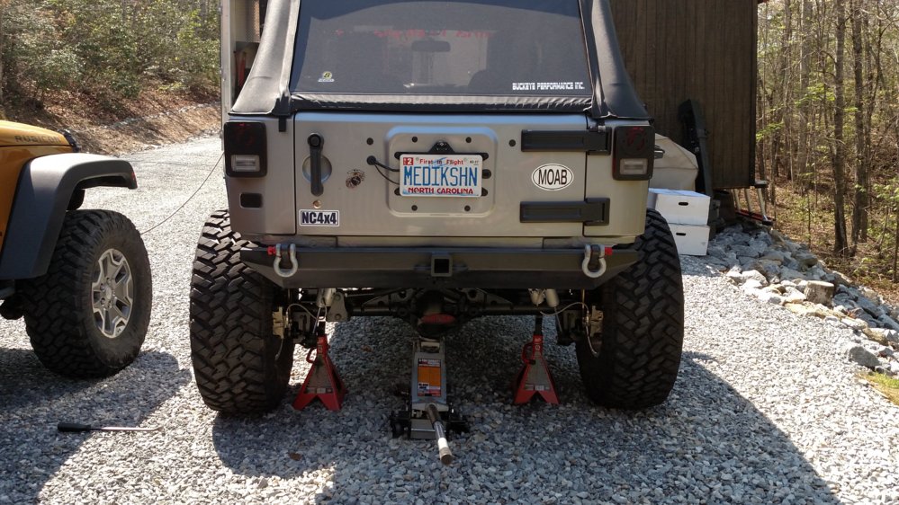

Got the wheels and tires off and Jk on jack stands, and surprise, ball joints are trashed. I knew that running the spacers with 4.5 backspacing wheels would be wide and wheelin hard would kill them. Installing these 3.5 backspace wheels should help that. Done screwin around, time for a set of dynatrac prosteer balljoints!
Looking a little closer, the current ball joints are alloy USA joints, I remember them being synergy. I am going to order a set of synergy joint for now, I have seen many have great service with them and they are half the price of dynatrac

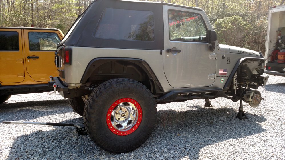

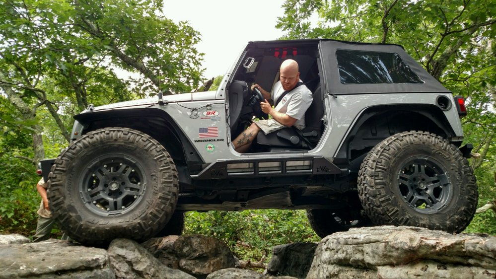

The wheels slimmed it down a little which is what I wanted, doesn't look like its on one tons now.
Installing the tires on the wheels by my self is a hell of a job, heavy as shit, but they are done and I am very pleased. Wheel fit and finish is top notch, thanks trail gear!
