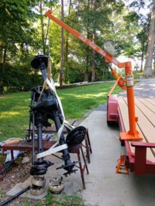

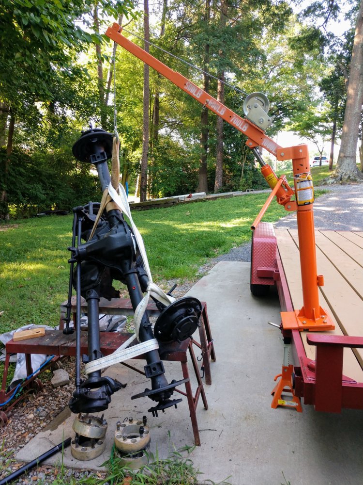

O No! He's at it again. First you take your 1/2 plate, that's laying around, mark & drill 5 9/16" holes. Started with a small hole & worked my way up. Took a lot of damn Batteries! Now I need a bracket, which necessitated a spacer between 2 1&1/2"sq. tubes. Hey, use what you got! Broke out the Hobart 175, this time. Don't worry, this will be lightly loaded, when used, & it's Not for the Edger!:lol:
Here's my finished mount [may need modifications]. Had to repair the trailer fender, before getting back to this. Tested with lifting a D30 front, AMC20, & J10 D44, complete, less brakes. Couldn't get the load centered, but their off the ground & saw horses. No reason to go higher. Doubt I'll ever lift this much again. Probably should have had this in the Trailer section.

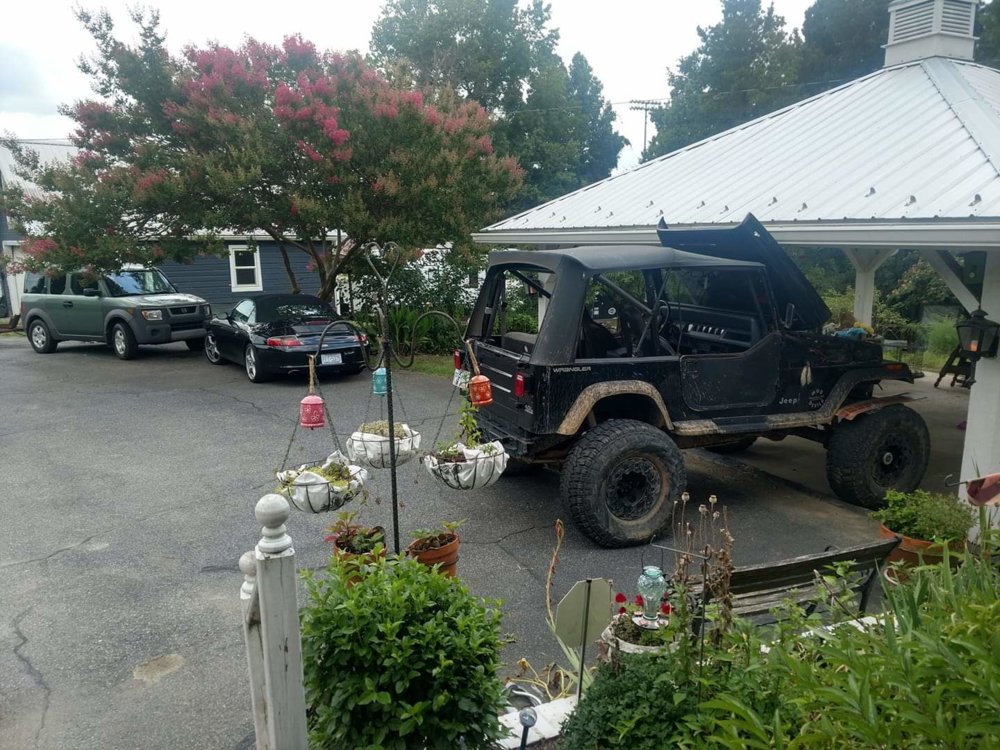

Got the heat shield on and the rear of the hood raised to give the heat somewhere to go after I cut it off. It was running fine just getting heat soak.

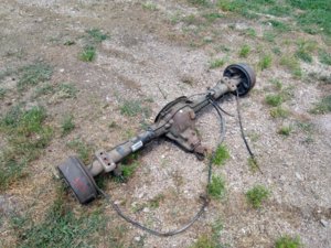

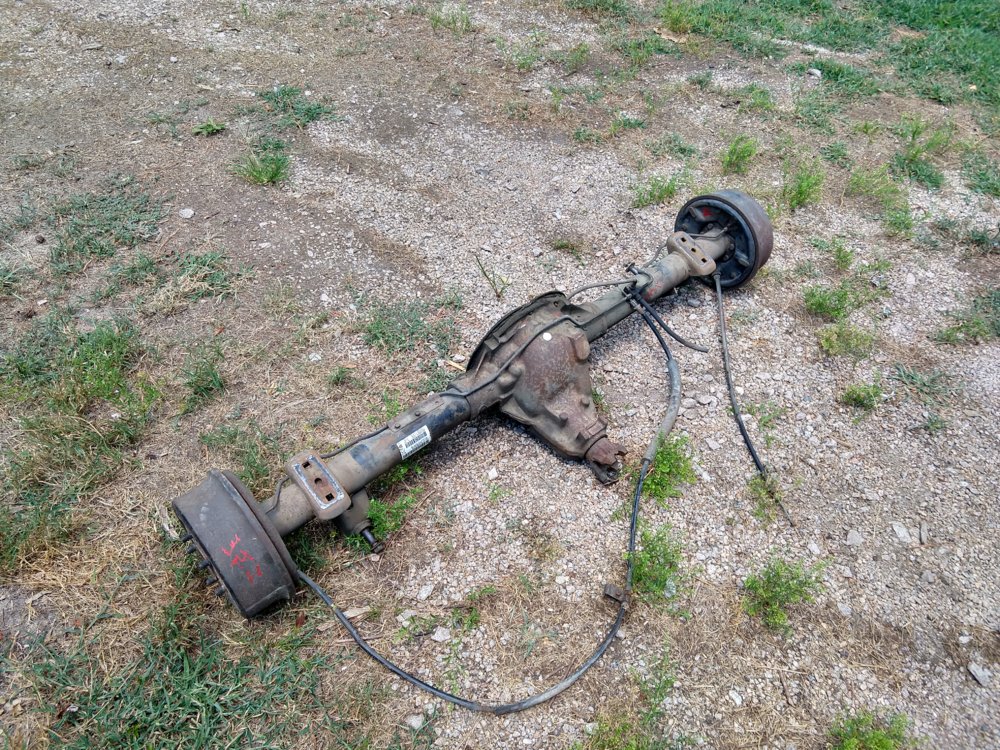

Dragged a C8.25 out of the lkq yard today (40% off). It's a 29 spline axle setup.....I didn't NEED it....but I know I won't be able to bring myself to put $1 into the D35 when it gives up the ghost.
It is the same ratio as my D35, So I will probably ZJ disc swap it before the swap.

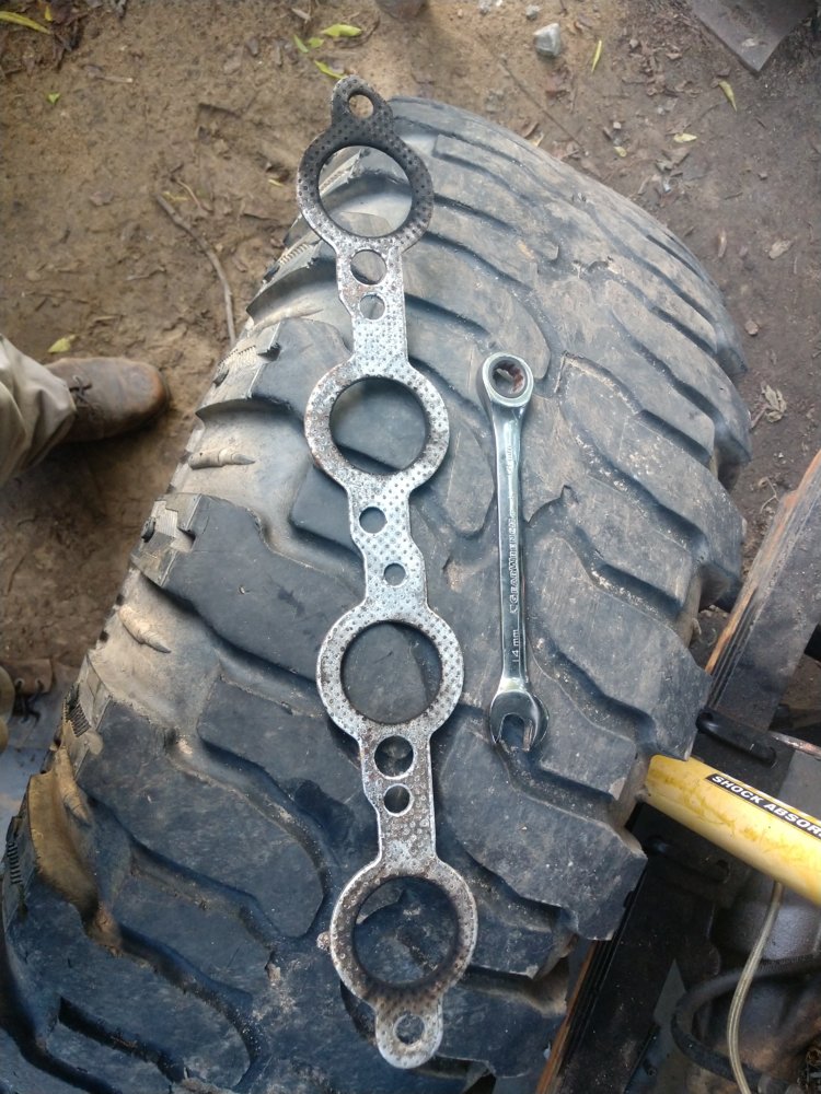

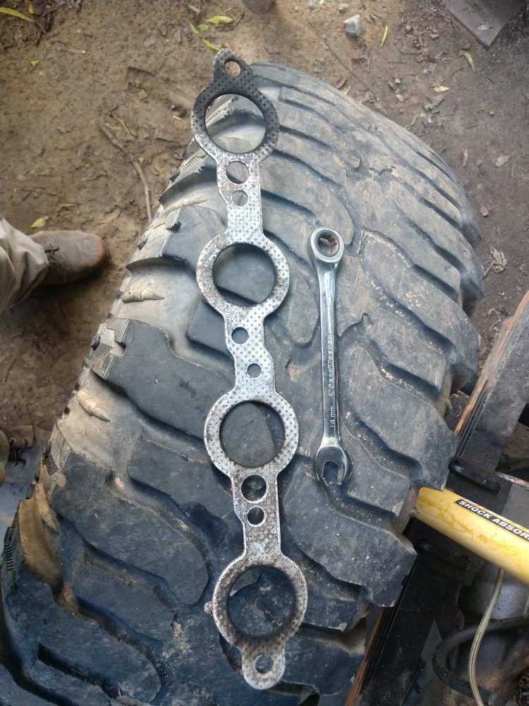

Chasing exhaust leaks. Something tells me that these headers may need to spend some time on a belt sander, and I need to stop by a part store today.
Chasing exhaust leaks. Something tells me that these headers may need to spend some time on a belt sander, and I need to stop by a part store today. View attachment 297733
You could also use your tires as a straight edge...they seem pretty dang flat across the tread.
