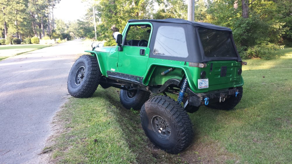

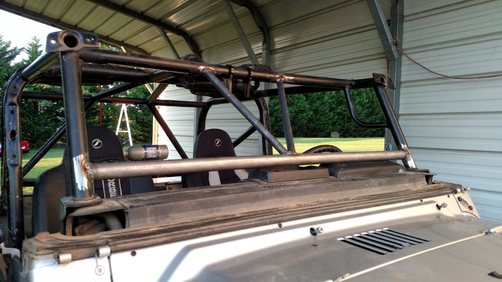

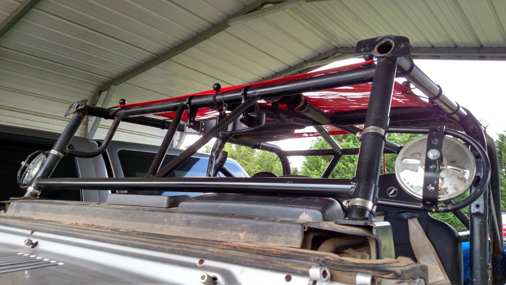

Got a majority of the tube work done for my newly redesigned rear cargo and fuel cell area
I'll wait until the cell is secured before welding the tubes in.
Also going to add a dedicated cooler mount right behind the driver's back glass

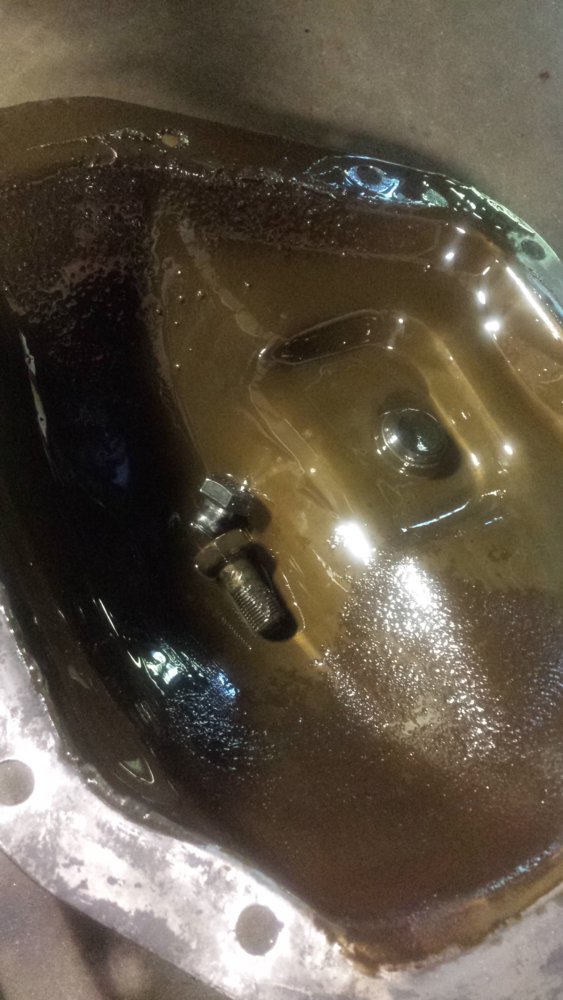

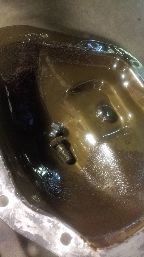

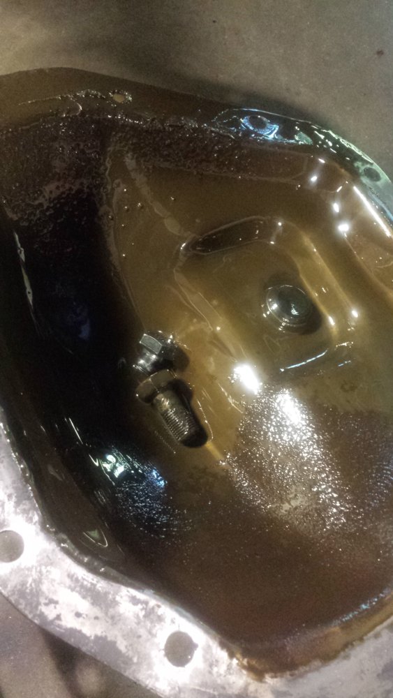

Not my rig, but my buddy's. Went to pick it up in Raleigh and brought it back to New Bern since he's moving back. Got it back to his shop, unloaded it, and had to check the flex because...why not? He then mentioned it was making some noise and it bound up in reverse going back to the shop. You don't have to use loc tite on ring gear bolts, but it helps. It does help. Three had fallen out, three were loose, but threaded all the way in, and the rest were backed out quite a bit.

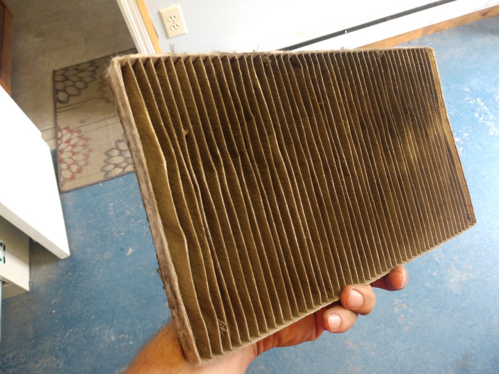

The AC in our International 7600 has been on the fritz. Got an estimate of $1500 to fix it. I verified the charge with my gauges, removed the blower motor to inspect the blend door. Evaporator was cold on both sides, but only hot air through the vents.
So I replaced the cabin air filter for $15 and fixed it...
Depending on work conditions, the condenser, can get clogged with dirt which turns to mud, too. On a Sterling, it's mostly on the outside firewall. Pull the fan motor, & you can see the condenser. AC hates Dusty sites!
