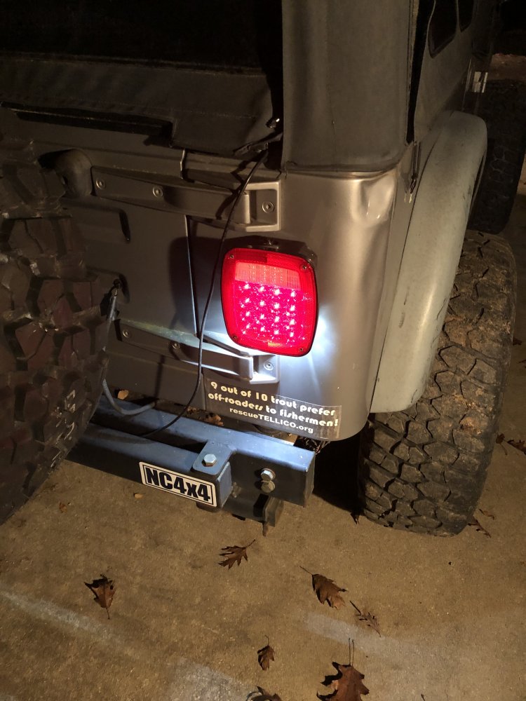

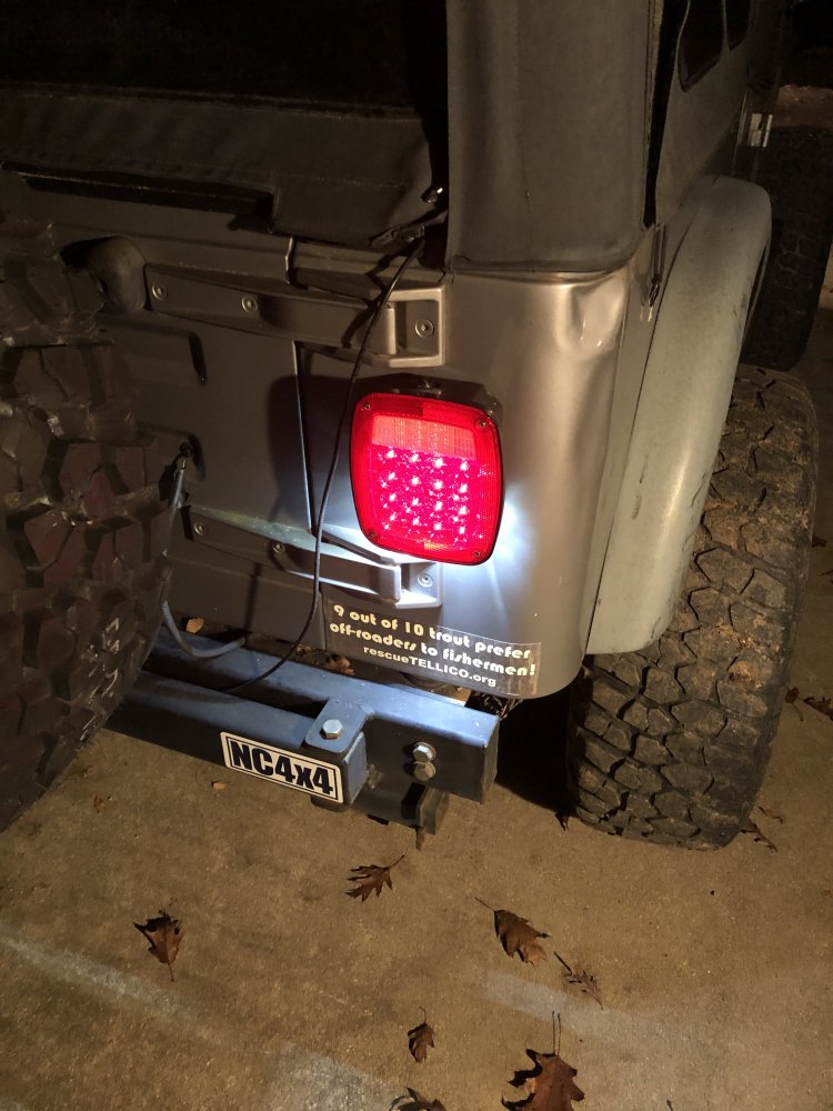

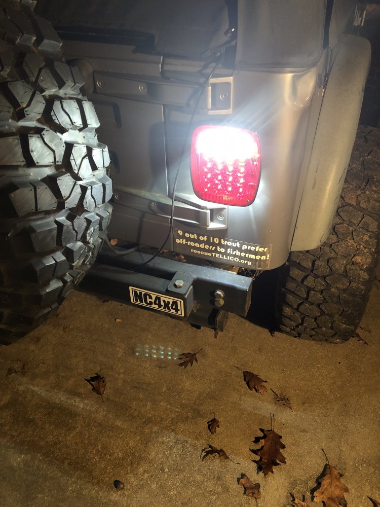

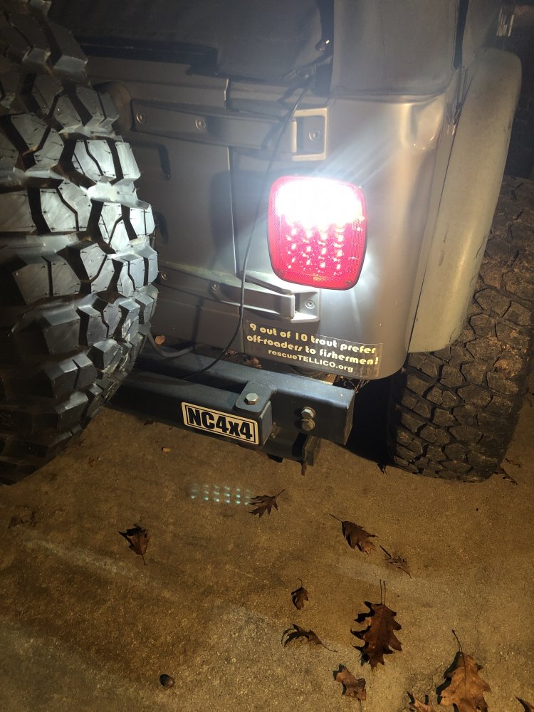

it’s been a long time since I’ve worked on the Jeep. When you don’t wheel it for a few years, nothing breaks. Wheeled with CTB a few weeks ago and busted a taillight. I thought about going to flush mounted lights but ended up ordering the cheapest set of LED taillights I could find on Quadratec. I didn’t get a pic with the brake lights on because I’m here by myself, but they do work.
Not quite plug and play. The lights come with wires, no connector, so I cut the connector off the old lights and spliced it in. Also, the factory lights have bolts that go thru threaded holes in the body. These lights come with bolts, nuts, and washers. They aren’t the same size, and you can’t use the original bolts because the plastic light housing is so much thicker. The bolts are a larger diameter too so I had to drill out the original holes. Not bad though.
it probably was only an issue for me due to body damage, but I had to trim the plastic license plate holder to make enough room for the driver side light.
both lights have a downward shining license plate light, where the factory lights only had that on the license plate side.

Jesus. That rescue tellico sticker didn’t age so well.

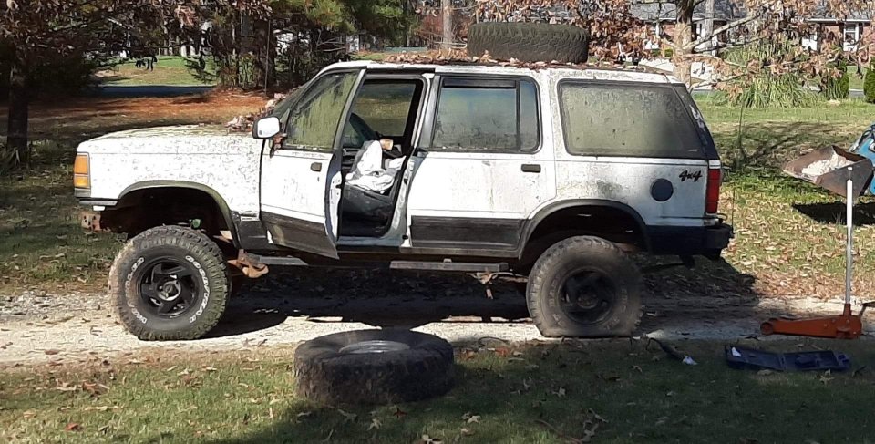

got the rear sway bar and shocks on...between kid birthday parties.

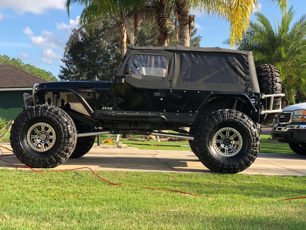

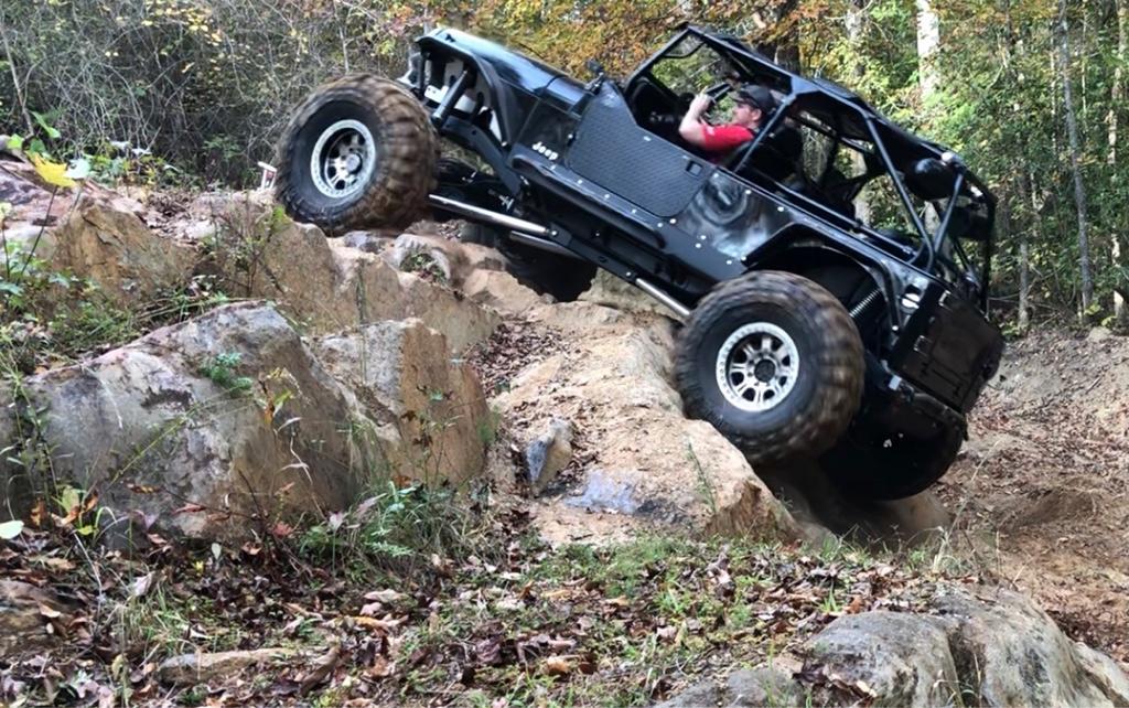

Spit shined her after a good weekend at RiverRock
This thing got a spotlight from Flex, Rock Rollovers recently, didn't it? Thought I recognized the rig when it popped up.

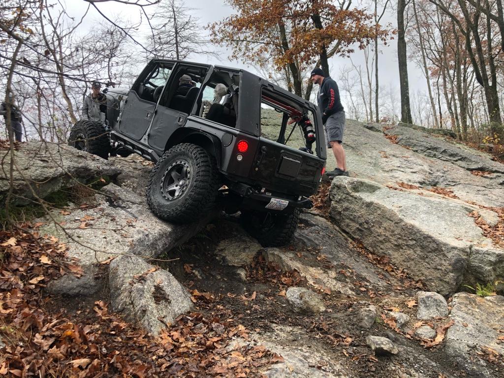

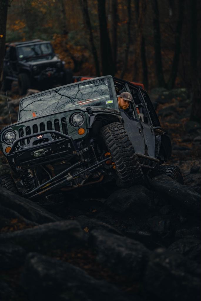

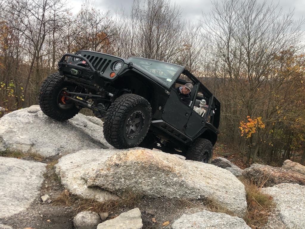

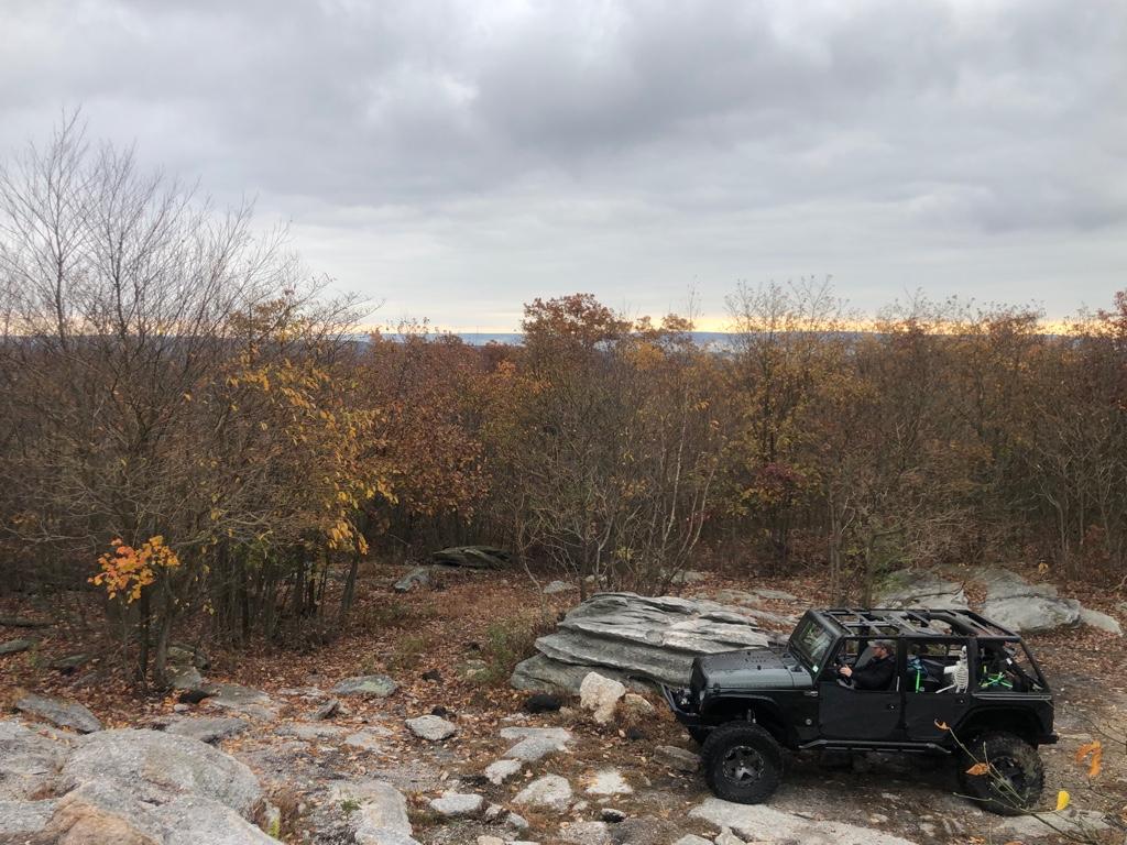

Went to Rausch Creek Halloween weekend and wheeled Saturday. Sunday was a total washout. Wheeled this past weekend at Uwharrie and saw a few of you up there. That far right line on Daniels rock garden is tough. Talk about a squeeze. Made it through after bumping it on up. Rear locker is not working again so I’m going to be working on that and the flat belly this winter. Getting ready for windrock in April.

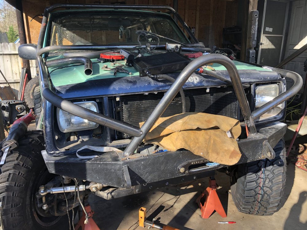

got the rear track bar on and the axle centered. now just need to get the caster angle and the rear pinion angle dialed in
