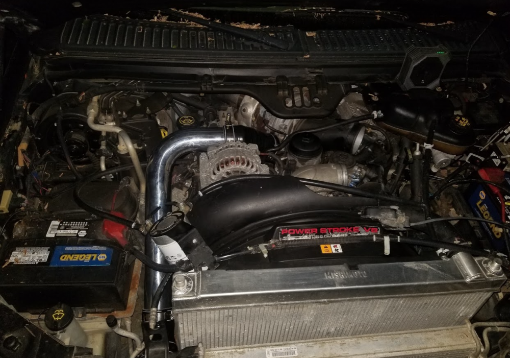

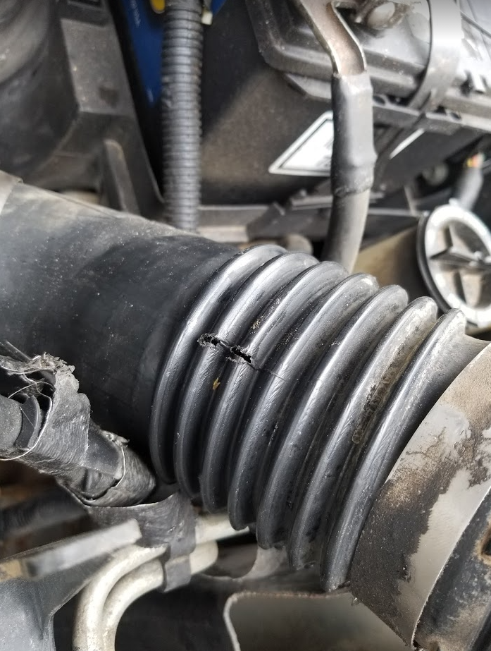

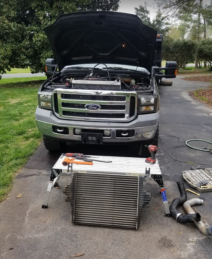

After my last trip the The Ranch, I decided to pull the intercooler and give her a clean-out. EGTs were pretty high compared to @CasterTroy when we were pulling grades, and I also knew I had a crack in the stock, plastic cold-side pipe (oil on hood above air filter). I typically only see low-20s in boost (my understanding I should be seeing mid- to high-20s) so I was thinking this was also the culprit. Took the advise of @77GreenMachine and a page out of @Curtis_H's book and got some HVAC coil cleaner and thoroughly cleaned out the fins of the intercooler.
After 3 shipments, finally got the parts I ordered (new Mishy pipes and boots). Started putting them on last night after my youngest son's tball game...in the pitch dark, in my driveway with only a headlamp.
I'll get the pipes wiped down from my grungy handprints and put everything else back together this evening after work.

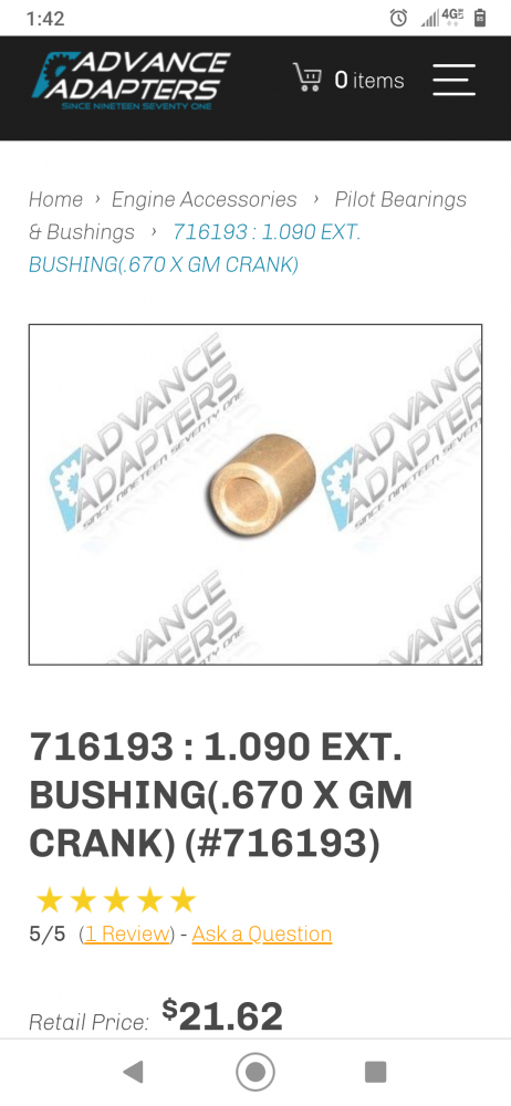

With the 465 do you run a pilot bushing or can you run the big, sealed roller bearing?
Ahhh ok. Too bad you can run the roller bearing in the end of the crank, but I'd rather have a bronze bushing over a needle bearing pilot.
Edit: the little tiny needle pilot bearings, that is. When I swapped from a long crank 4.8 to a short crank 6.0, the new bearing was massive in comparison. It'll probably last a lot longer.

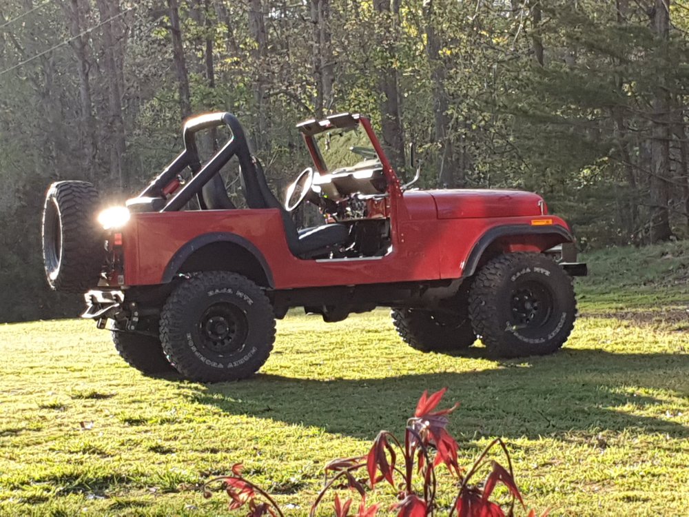

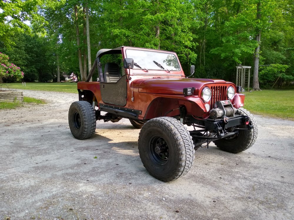

Drove the cj to work. 76 miles one way
. Averaged 65mph and a little better than 13mpg. I was just glad it made it. That's the longest hwy ride I've ever taken in it, pretty much had the 258 at full throttle for an hour and a half...
