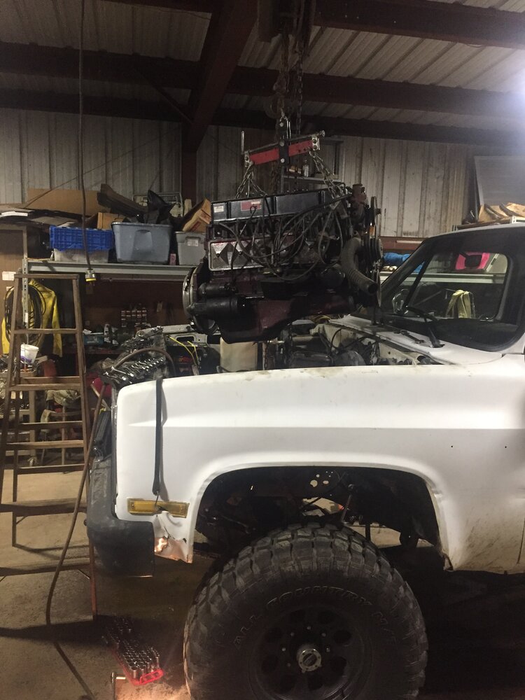

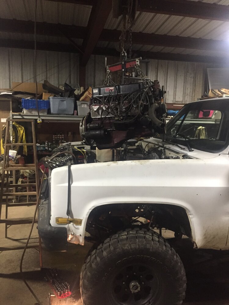

Snuck in a few minutes the other night to finish pulling the 292.
I love that truck, what you putting in its place?
If you ever think about selling give me a holler.

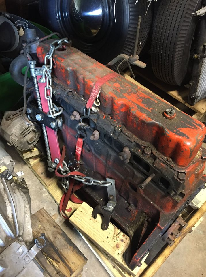

Thanks...hoping to hold on to this one for a while. If things change you’ll be the first to know. The 292 will go back in for now...Just pulling to check out the internals and regasket. At some point a PO installed a "custom" push rod that appeared to be a solid push rod ground to length on both ends. That resulted in a loose rocker arm that wore out the top of one of the valves. This is where @Croatan_Kid tells me it's time for the cummins swap. (Trust me I would love to!)
It's backwards.
In case you didn't know
I had my suspicions that something was off when I pulled it...couldn't quite put my finger on it though.
Lemme know if you wanna sell the motor, unless @YotaOnRocks wants it.
Gonna keep this one for now. I've got another 292 sitting on a pallet that I would let go though. Bottom of the blocks been welded up at some point

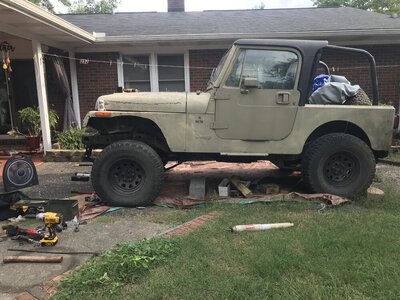

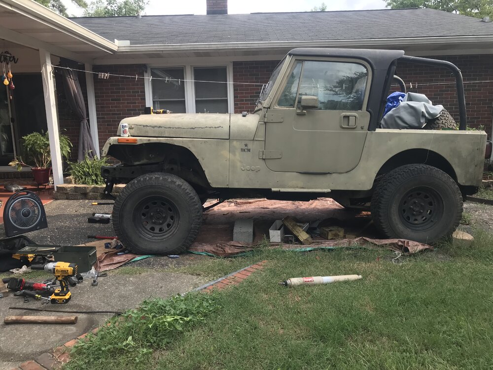

Did my front leafs on today….first time doing stuff like this, I still need to connect the brake lines, and shocks tomorrow
next weekend I’ll do the rears
And so it begins...
And so it begins...
So quick story behind “LISA” I bought this for my son 10 years ago for his 16th bday as he wanted a HEEP, (paid 950) for it had a rebuilt motor( I have build sheet) anyway I told him NO off road shanannagins until we had it looked over…(sounds reasonable yes ?) anyway his sister conned him into an off-road/mud excursion….and BAM got stuck in the mud (over the hood) , as the 4x4 did not engage although the light came on….so he left it sit in the mud for a week…and He went a bought himself a new car the following week and it’s been a weekend project ever since. Mind you I’m a medical dude with less then any mechanical experience 😂😂😂😂but tween y’all here and YouTube I have tossed in a new holley carb/painless harness/fuel tank/fuel pump/and now a 3.5 inch lift and t-case drop until I can rebuilt the 231 tcase…

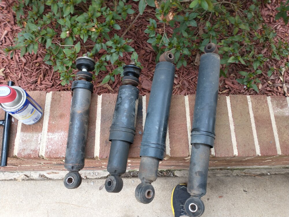

Just replaced all 4 on my f250 not long ago. Only one was semi functional. I installed Bilsteins as replacements. I've yet to decide if the extra money was worth it or not though.
I thought about bilsteins, but couldn't justify the price, unless they are magic the impact to a torsion bar / leaf spring suspension can only be marginal.
