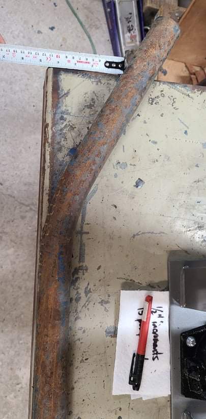

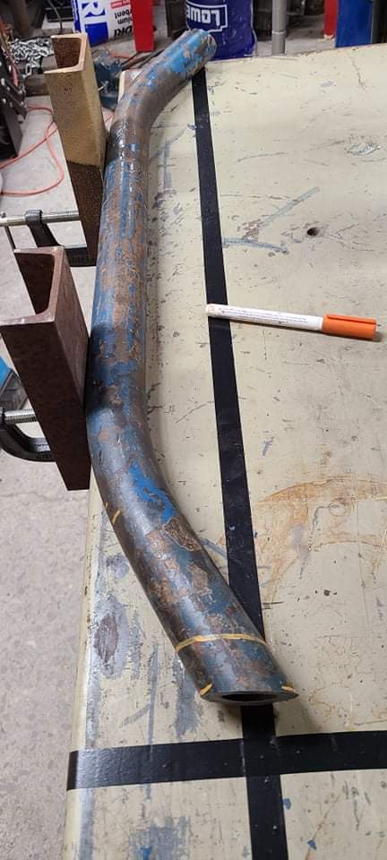

Hot damn, progress! It's been a while and I'm too lazy to go back so I'll just recap. I built a crossmember for the 205. I bolted that in today and let me tell you it's a PITA. This is what happens when you try to engineer when you're not an engineer. Nothing fancy really but when your frame looks like a smashed ladder that's catty whompas at best, you do what you can.

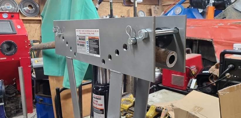

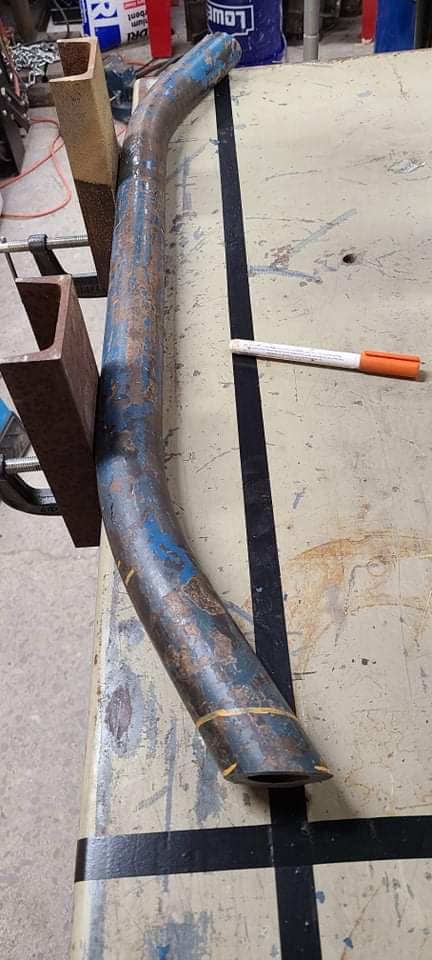

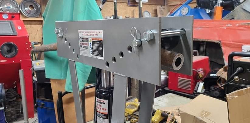

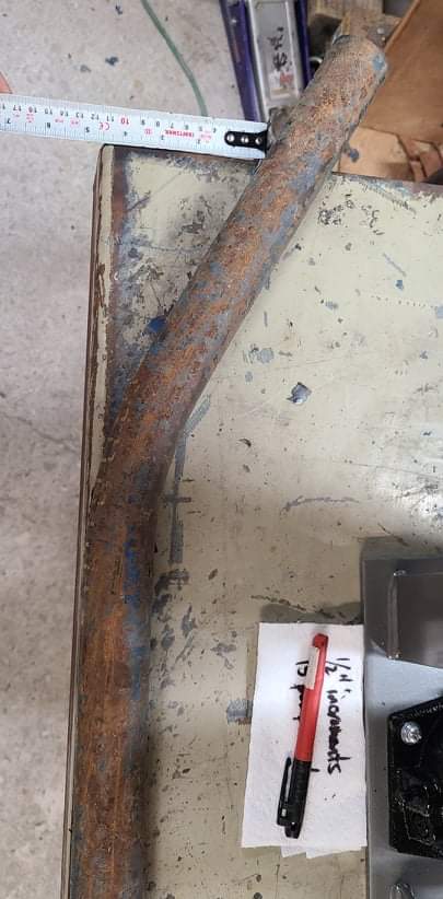

Today I also got to try out a new toy. The local business in town claimed they could do cool shit. When I asked them about bending some toob for me they said we don't do that cool shit. I went and bought the 16 ton pipe bender from HF. I was looking to bend a piece of 1 3/4" that had a 3/8" wall. I watched a YouTube video and figured I was set. Long story short, I over bent the piece then tried to back up with the help of my HF 20 ton press. It may have worked. Regardless, I got it into shape and honestly it handled it with ease. I was expected something dramatic but I was pretty pleased. No kinks or weirdness. Maybe I'm just an old pro at heart.
I got it in and tacked into place. I don't plan on burning it in till I get the 4 link bracket tacked and make sure the driveshaft won't hit because I'll be honest, she tight.

I have both of those tools as well 🤠
HF fabrication bros!

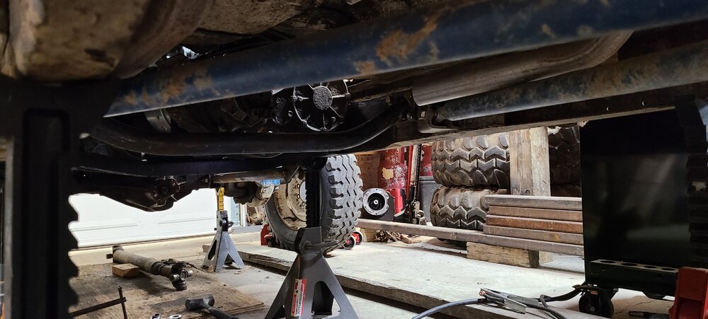

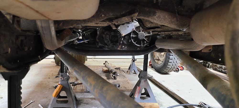

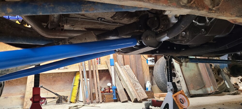

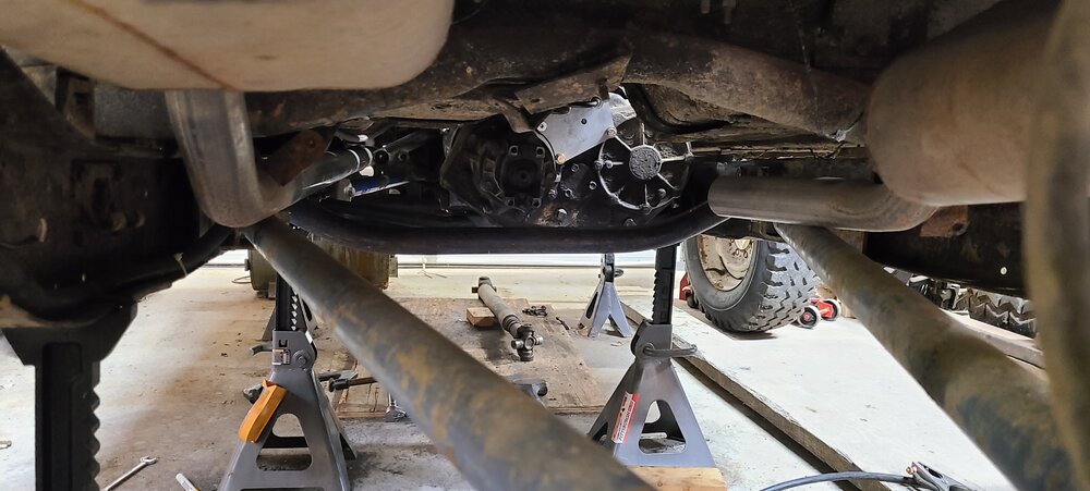

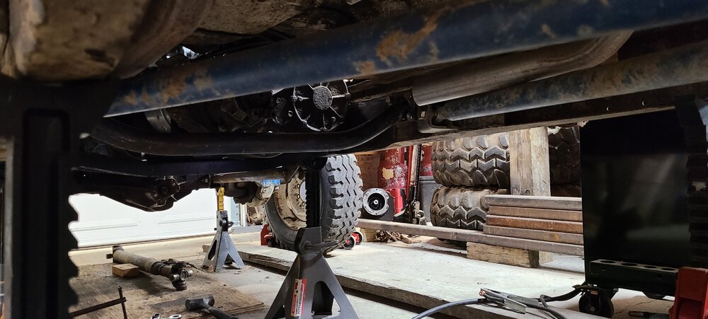

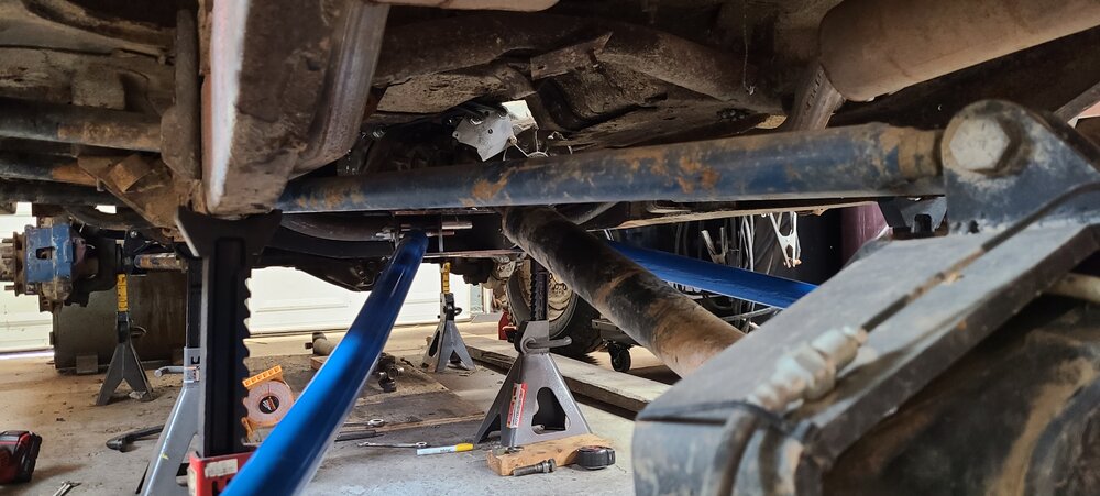

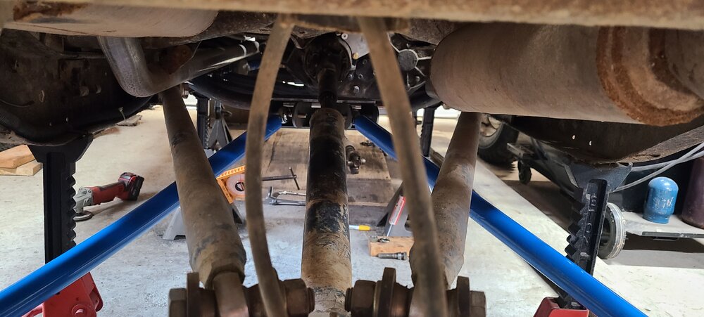

Jumped in the shop for a couple of hours between shifts. I put the driveshaft in and checked for clearance against the 4-link bracket. Looks like we're all good in the hood.
Then I put the links in just to see if I'll have to modify the lengths. It's tight but I think it'll work. I may need to lengthen the driveshaft but at full droop I have about and inch of spline showing. I'm sure for some that would work for some but I'm suspect.
Lastly, I tacked in the 4-link bracket and pulled the crossmember out to burn it all in. I got the outsides burned in but I'm waiting to hear from Barnes before I burn the 4-link bracket the rest of the way in.

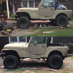

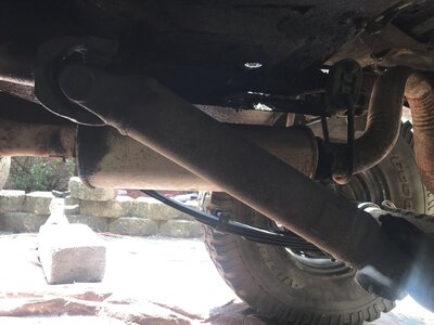

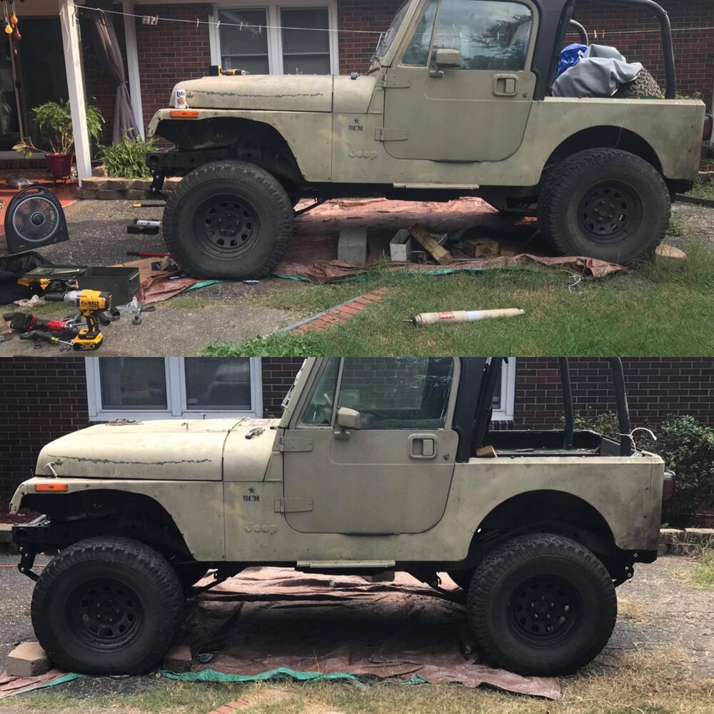

Well finished the leafs this am still need to do shocks, brake lines (on back order), tcase drop until I can do the SYE thing my shaft is at 29degrees The top pic is right after the fronts were done (duh😂😂)…

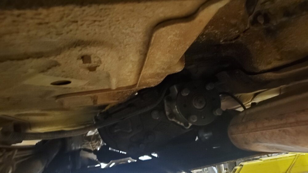

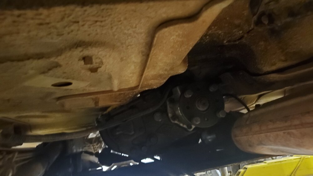

It ain't much to look at, but it's in! (That's what she said!)
Big thanks to @willness33 for helping motivate me to get it done and wrassle that case in and out about a dozen times.
You wrestled. I supervised. You had to do it the hard way though. A hammer could have had the job done in 20 min.
Yeah, but now I can sleep easy knowing I did it not the way you would have :laughing:
Turns out your way worked but mine would have too ;)
Clearance on that tcase is pretty stellar now though. Your way is better long term. Even if there is only 5 bolts holding the case to the trans.

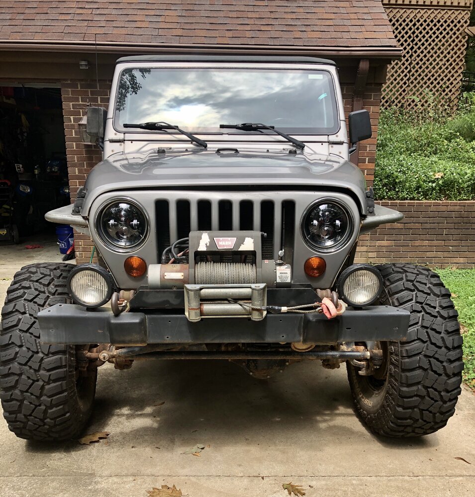

the 21 year old headlights were so dim I felt like I was driving with a flashlight. Which wouldn’t have bothered me before this summer because I drive it so seldom. but I’ve been driving it more lately. So I found some cheap Amazon LED headlights. I wish they looked more like the original headlights, but oh well. Tried it out tonight and I can see again! Worth every Penny of the $66 I spent.

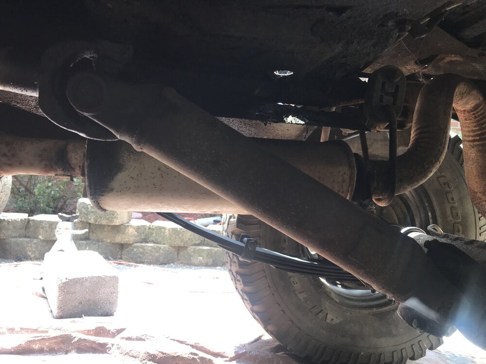

drive shaft angle is 18degrees is that good?

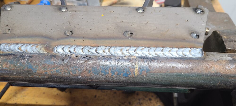

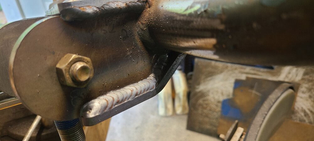

Welded up the 4-link crossmember. I'll give a tip of the cap to Barnes on this one. It's very well thought out and it's almost dummy proof. Super beefy and delicious.

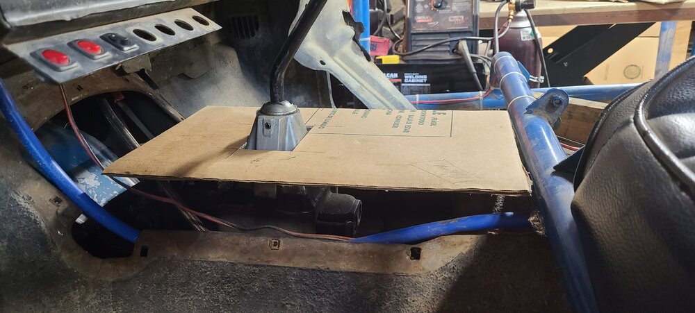

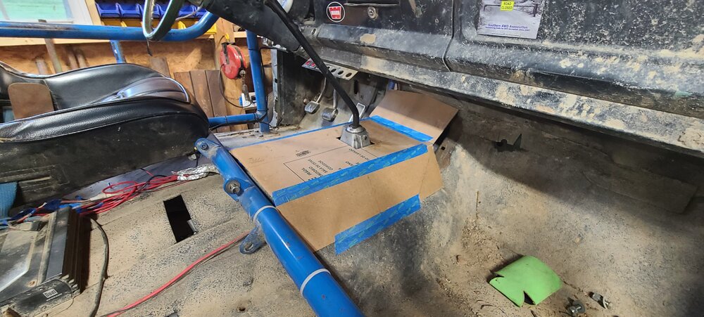

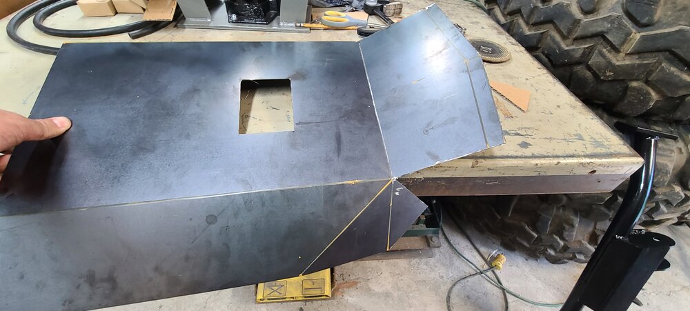

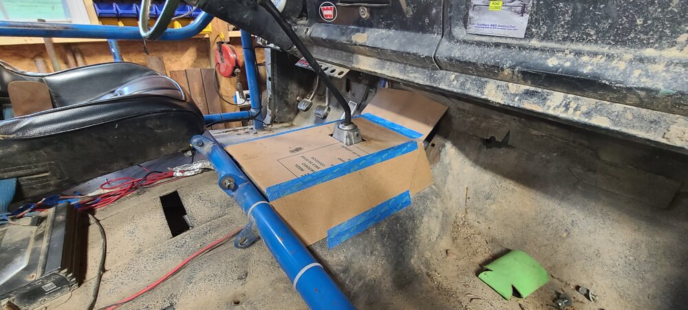

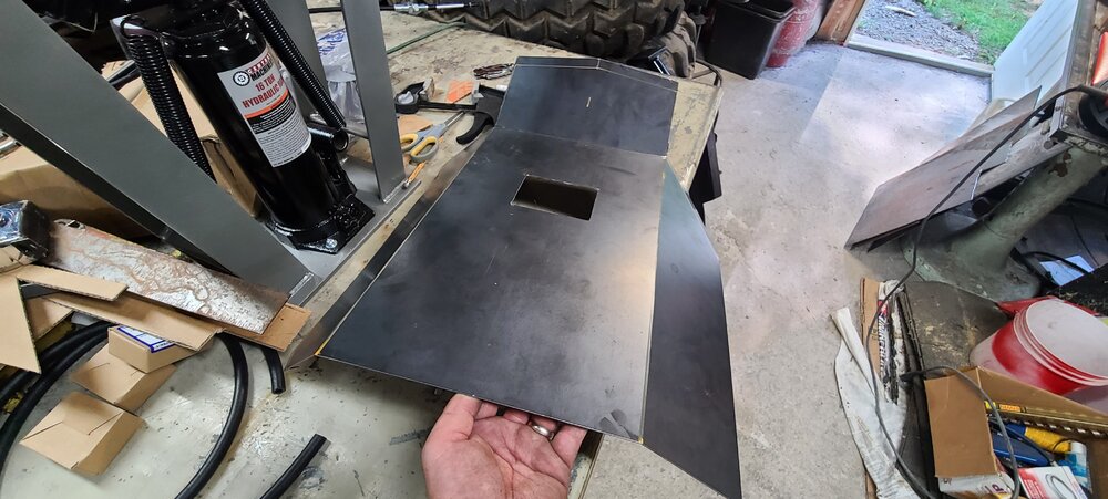

Then I worked on the trans tunnel. I needed a better one than what I have. I need to mount the JB Fab shifters and the old one wasn't going to cut it.
And yes, that is blue pex being used as conduit.

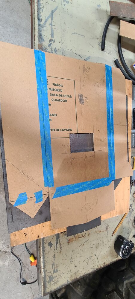

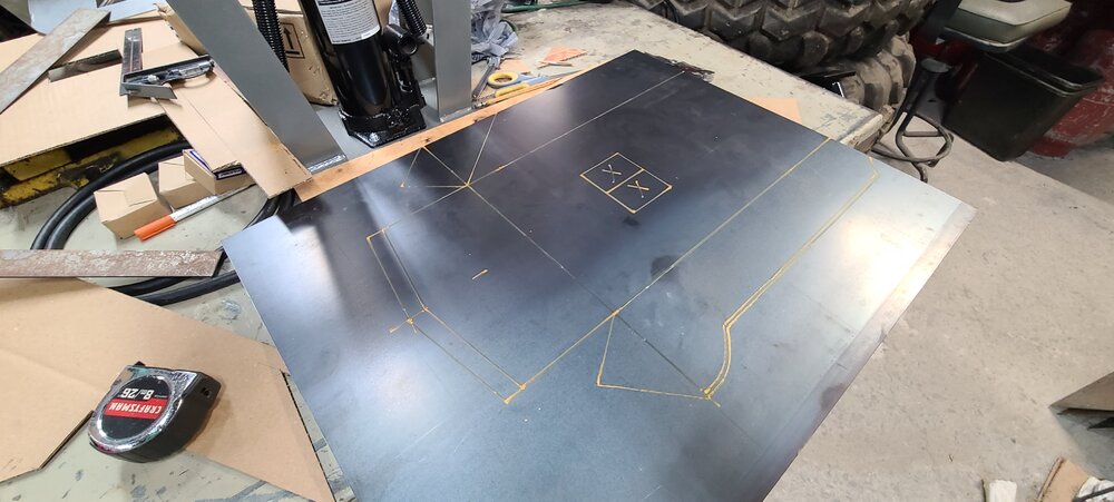

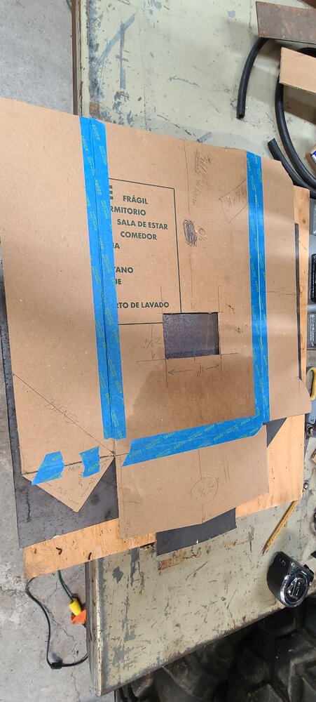

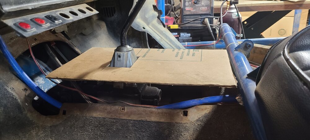

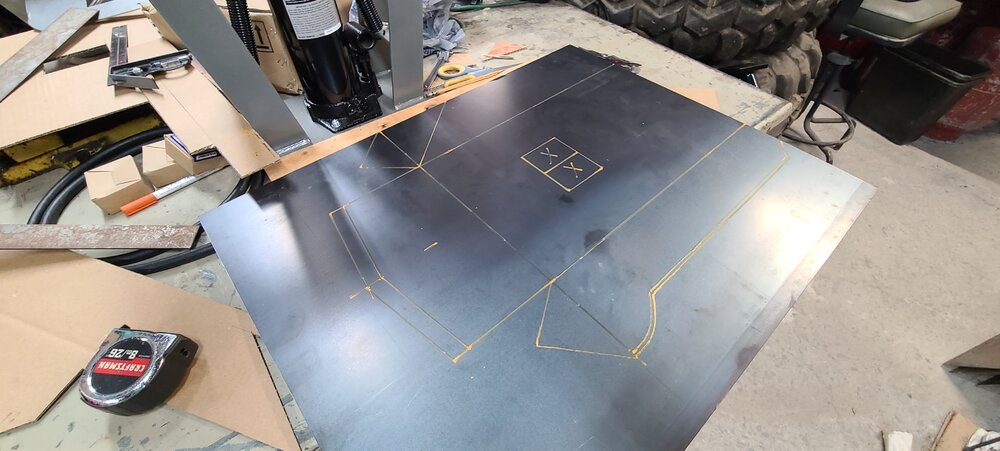

After a little measuring and what not I got my pattern made.
And yes, you've correctly identified a Network Lumber Distributors coozie in the floorboard. Good eye!

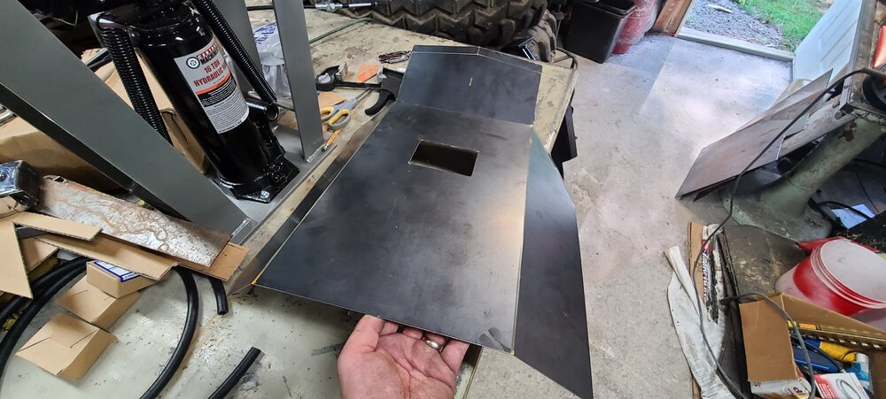

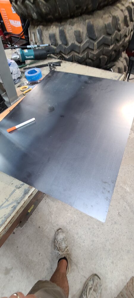

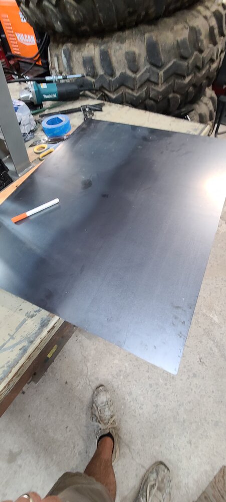

I didn't have a big enough piece of sheetmetal and being in the big city now I went on the hunt. 15 mins later I had my piece ready for pick up. There's a local place that will cut to size so you dont have to buy a full sheet.

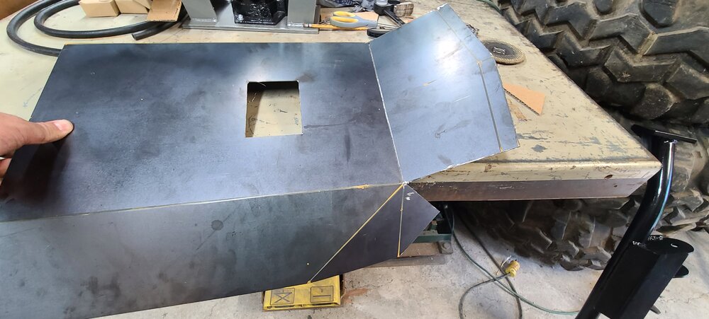

Lastly, I made my marks, let the sparks fly, and then gave everything a rough bend. My son had a tee ball game so I had to stop. Hopefully, I can finish it up today.
Edit: I know there's a triangle missing out of the side but I couldn't accurately measure it with the cardboard pattern so I'm going to bend it up and get it in place then measure it.
That's some really nice layout work. GG 👍
