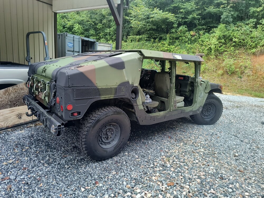

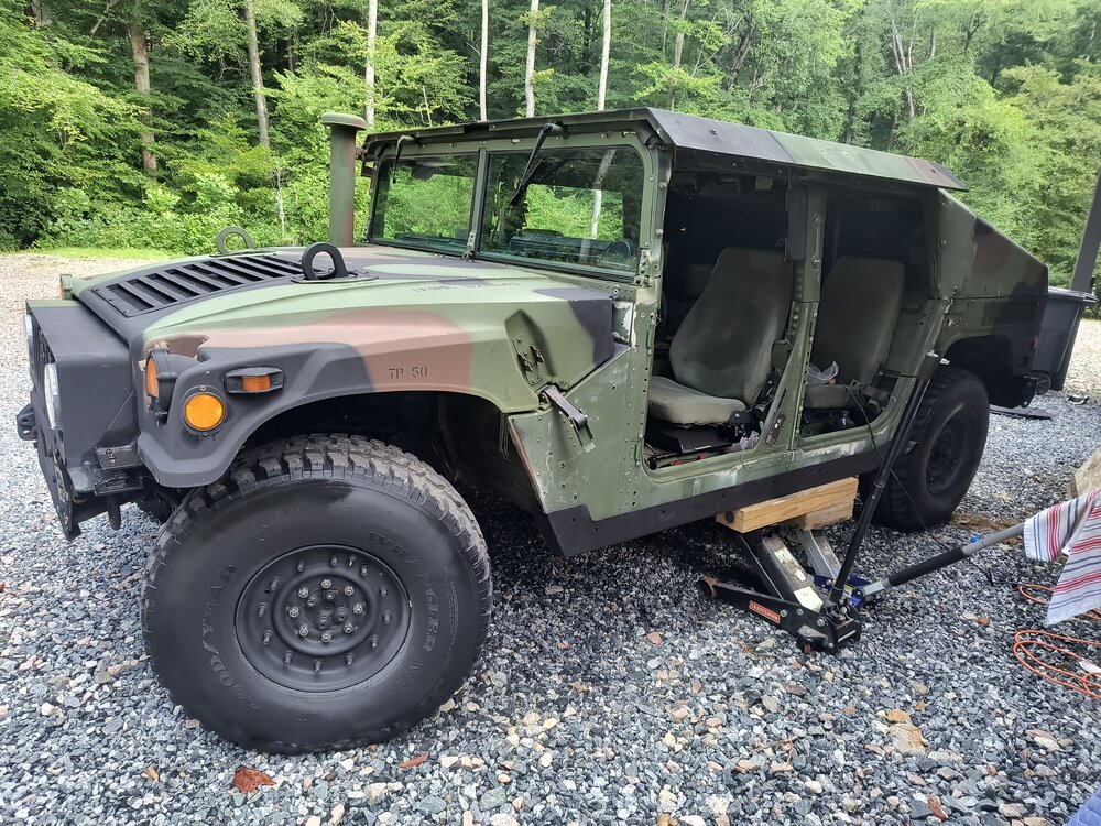

So December 6th-8th?Added sliders to the HumVee
View attachment 423085View attachment 423086
Hopefully getting the fiberglass doors on next weekend

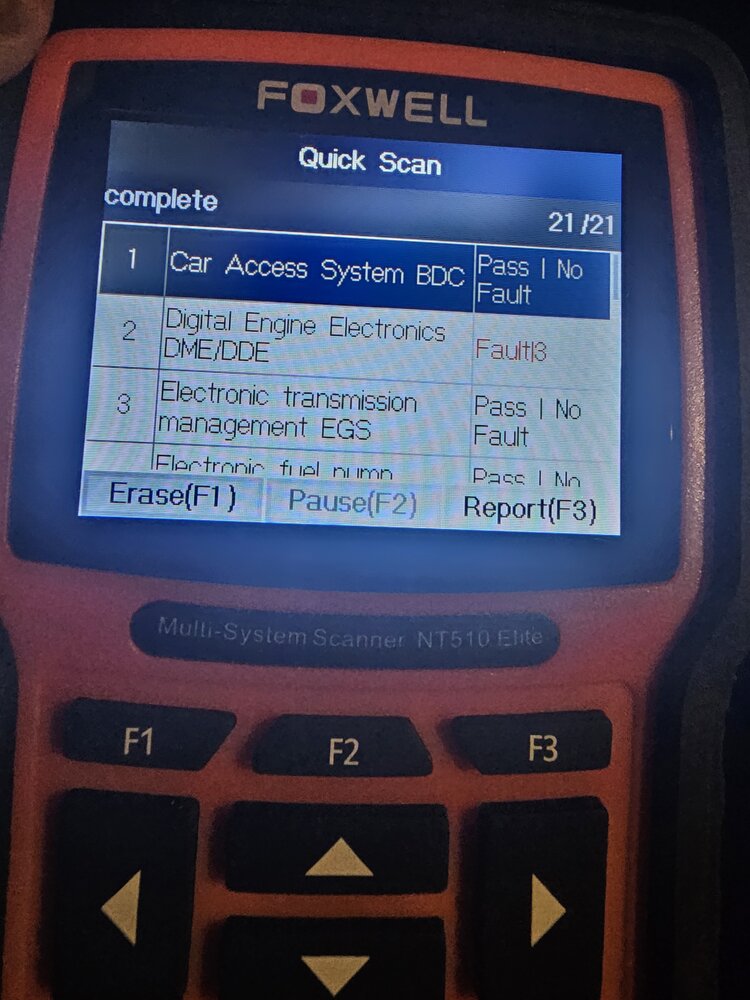

Sounds like it needs a carburetor conversion lolI have a couple timesHad the timing chain replaced a couple weeks ago & it's now throwing VANOS exhaust code intermittently & going into limp mode. Took it back to shop & they couldn't get it to throw a code. Switched the intake & exhaust solenoids last night & cleared the codes to see if it's a sticky solenoid.

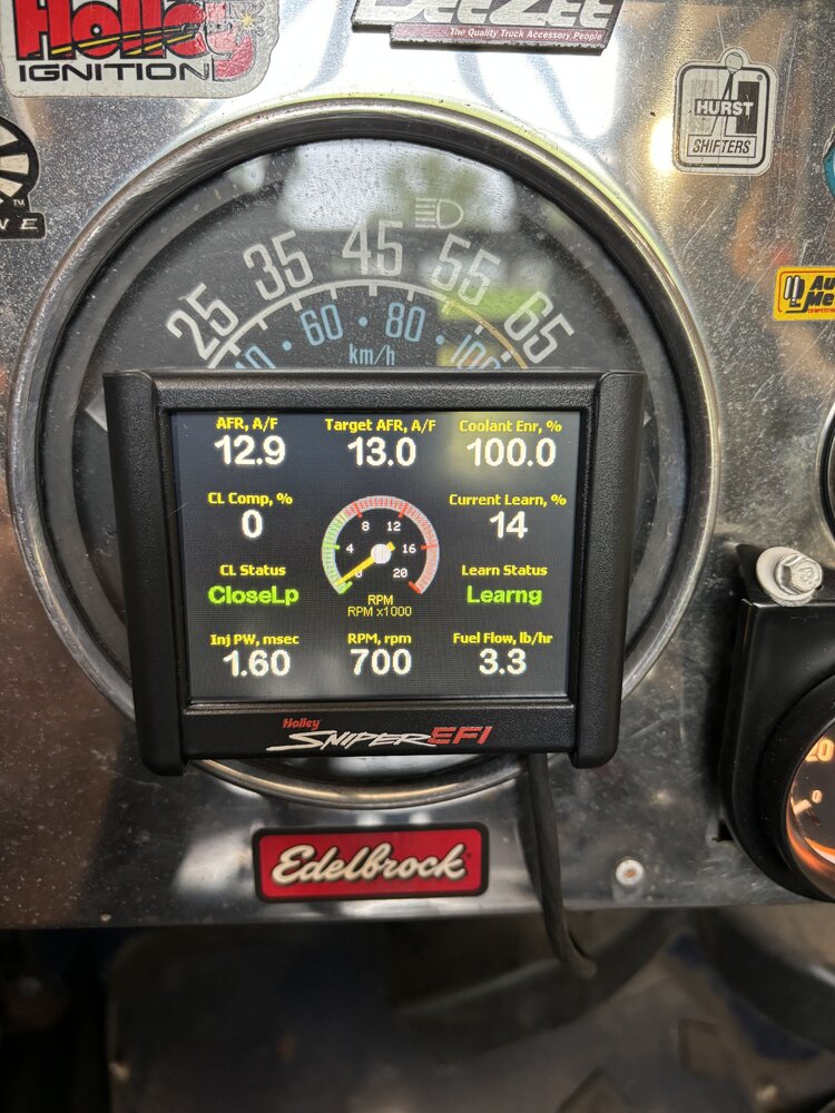

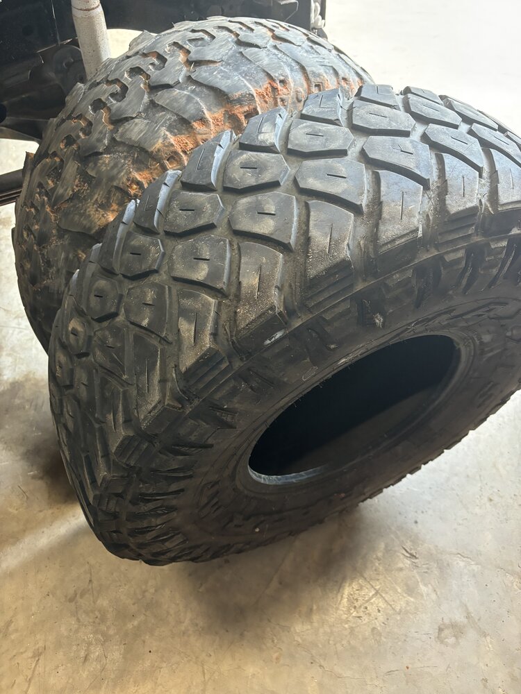

Added Holley sniper to the old inline 6 and got some new to me shoes Maxxis 40’s.

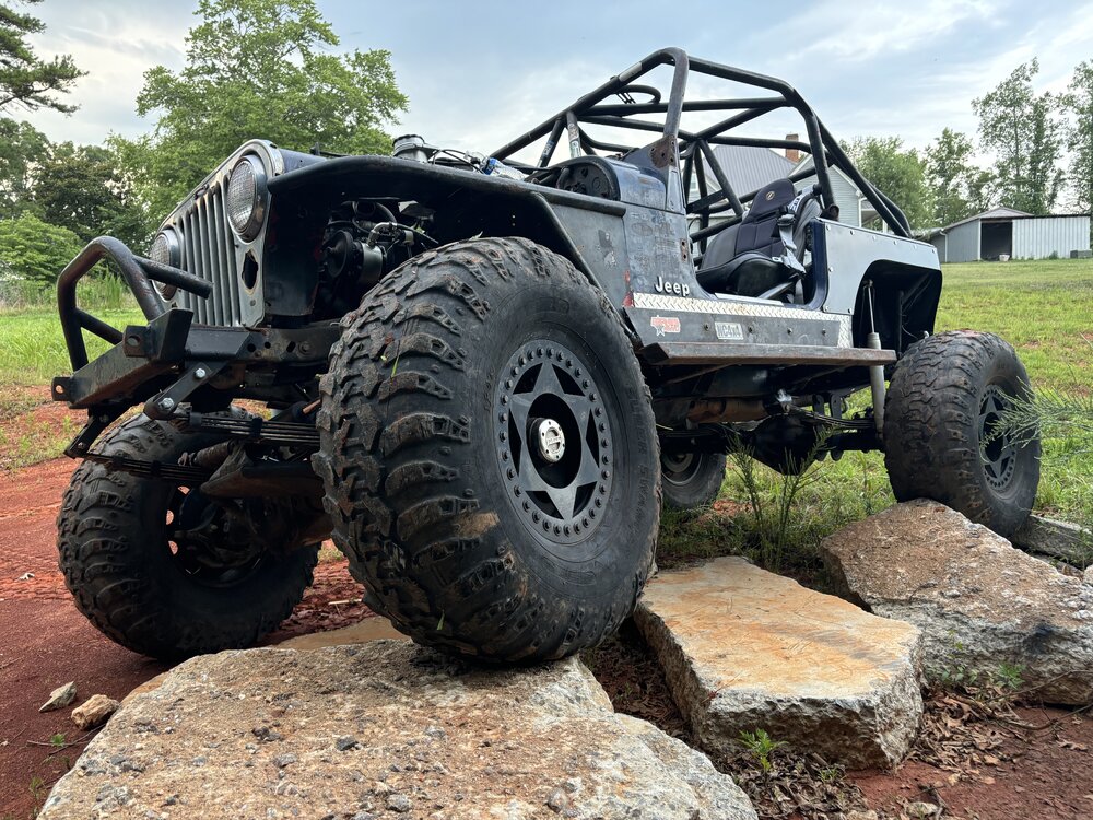

Just an old cj crawler I’ve had for 25yrs. 83cj7 Laredo package, had the standalone a/c under dash. Leaf sprung and stretched to 112”. Dana 60/70 5.13s locked F&R disc, Full hydro steering, 40s. 258i6 with Holley sniper, t5, 4:1 D300, swapping in a SM465 this winter. Cage with corbeaus.Need more pics and details on your cj
The most surprising thing of that whole build list!
Agreed. But It’s still kicking. I have a 465 to swap.The most surprising thing of that whole build list!![]()

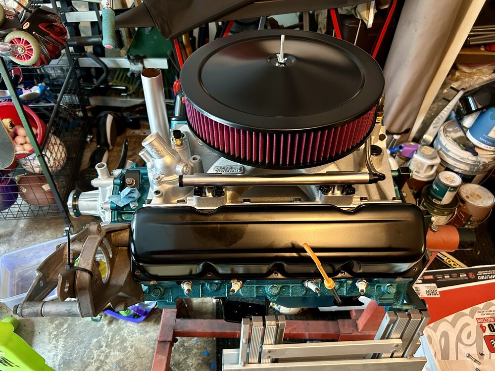

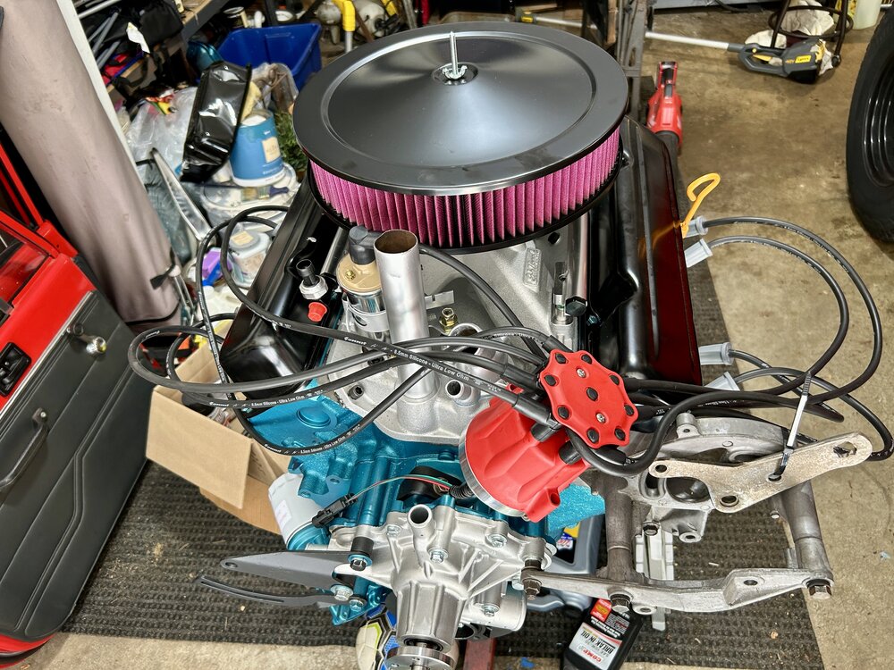

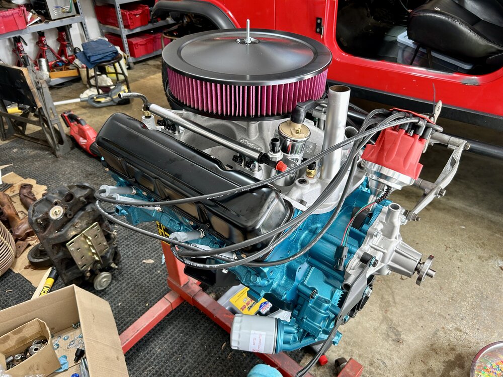

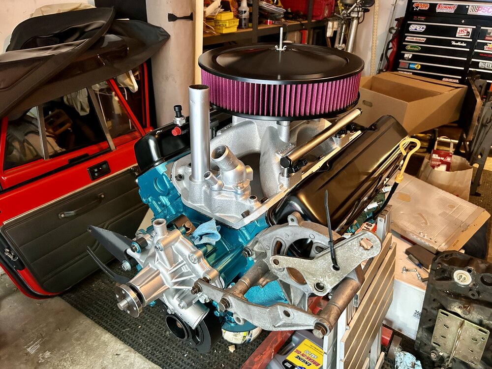

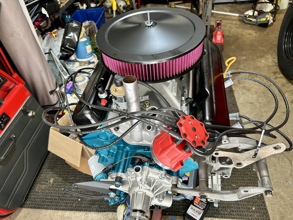

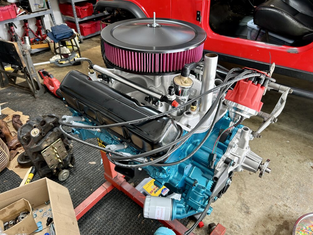

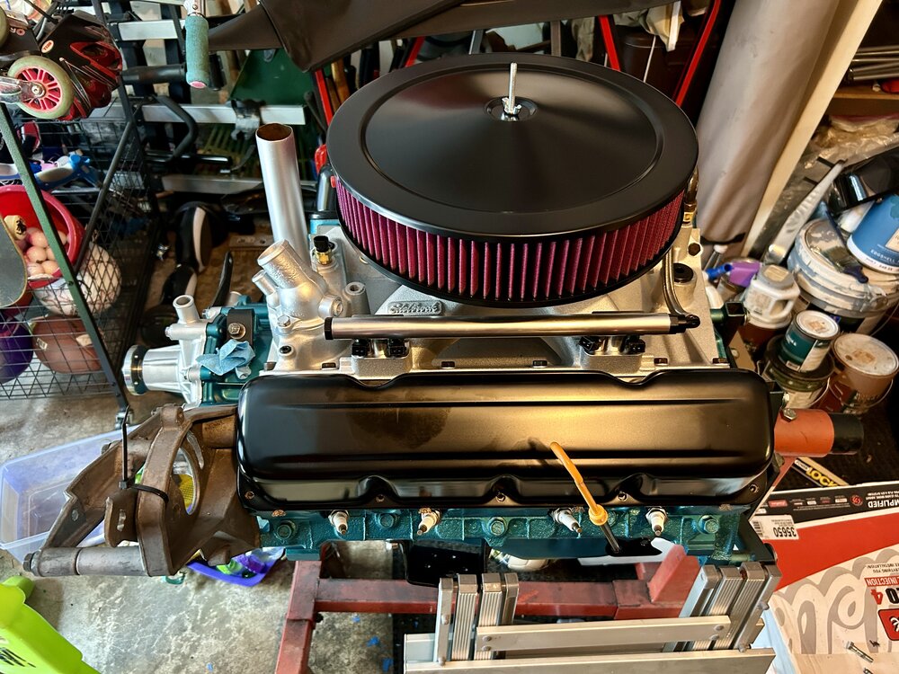

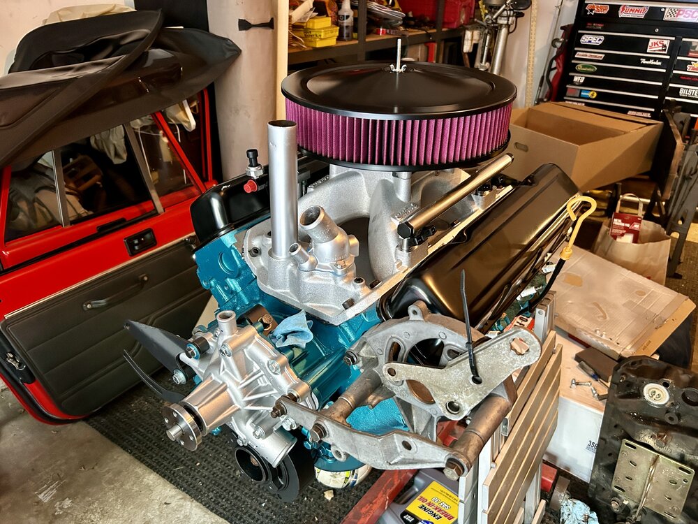

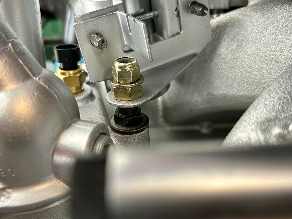

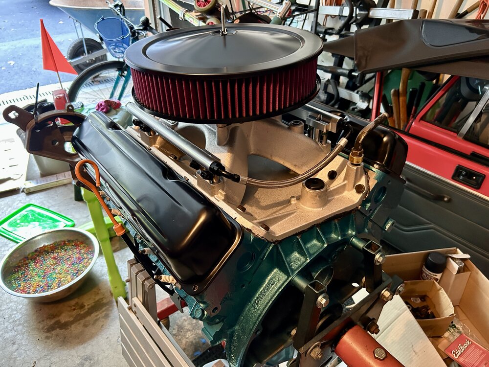

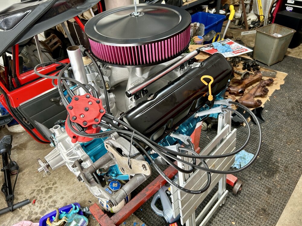

Curious about if you reused the distributor gear from the original distributor? I didn’t and ended up buying a matched set after it got chewed up in a very short time. It’s not a lot of fun doing it after install and knowing that there’s metal floating around in the engine.Coil mounted, distributor in, plugs and wires on.
I used a summit racing wire set, I’m not real pleased with how it laid out. I’ll make a set eventually but the summit set was on sale.

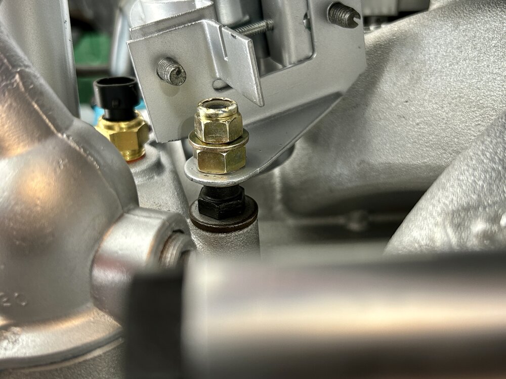

I also used one of the OE rocker studs to mount the coil. Thought it was neat to reuse some of the original equipment, but I’ll probably replace it as well.
View attachment 423137View attachment 423138View attachment 423139View attachment 423140
I didn’t buy a matched set, but asked the edelbrock tech about it, as I’m also running a comp cam. Should be ok according to them.Curious about if you reused the distributor gear from the original distributor? I didn’t and ended up buying a matched set after it got chewed up in a very short time. It’s not a lot of fun doing it after install and knowing that there’s metal floating around in the engine.
Hope so! I did buy an ebay distributor that had a harder steel gear than the gear on the cam. It went within a thousand miles or so and acted like the timing was jumping. I’m not taking any chances with this 401 I bought a matching set for it. Looking at yours makes me wish I’d spent extra coin on the fuel injection. I’ll be running FItech, but that Edelbrock system looks sweet!I didn’t buy a matched set, but asked the edelbrock tech about it, as I’m also running a comp cam. Should be ok according to them.

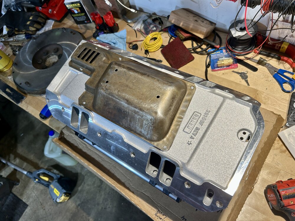

Lubed ‘em up good during install.
What injection system are you running?Still marking things off the mile long list
View attachment 422781View attachment 422782View attachment 422783
Yep. Pro Flo 4What injection system are you running?
