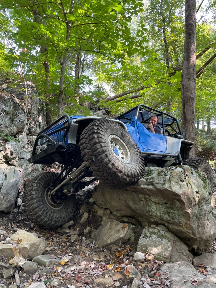

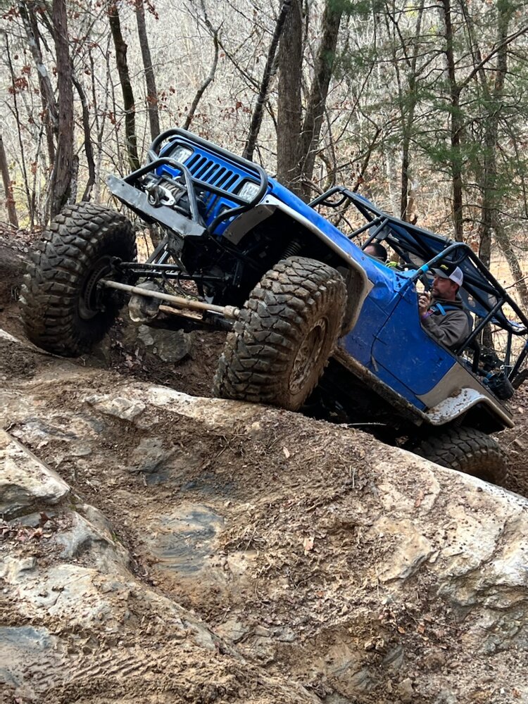

Day 1- excess woopow pushed the rear upper link into the exhaust pipe which pushed the muffler into the tub which knocked the baffles out of the Borla.
This thing is stupid annoying load now. I'll replace it next week.

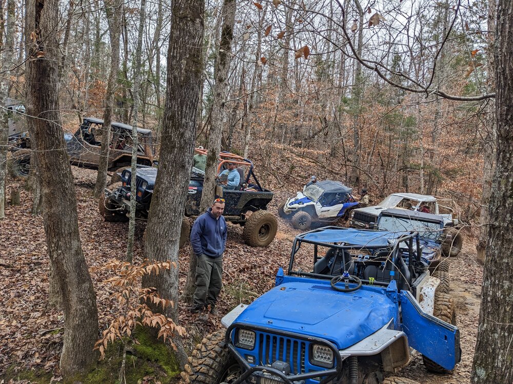

Day 2- kicked ass and rode all the hard stuff. Now the driver door doesn't work. But I made the exit of Cripple Creek. Fair trade.
The chop chop cam makes the brakes suck at idle and the converter is totally wrong as a result. Depending on what the next owner wants, I'll leave it be or swap in a PTC converter.

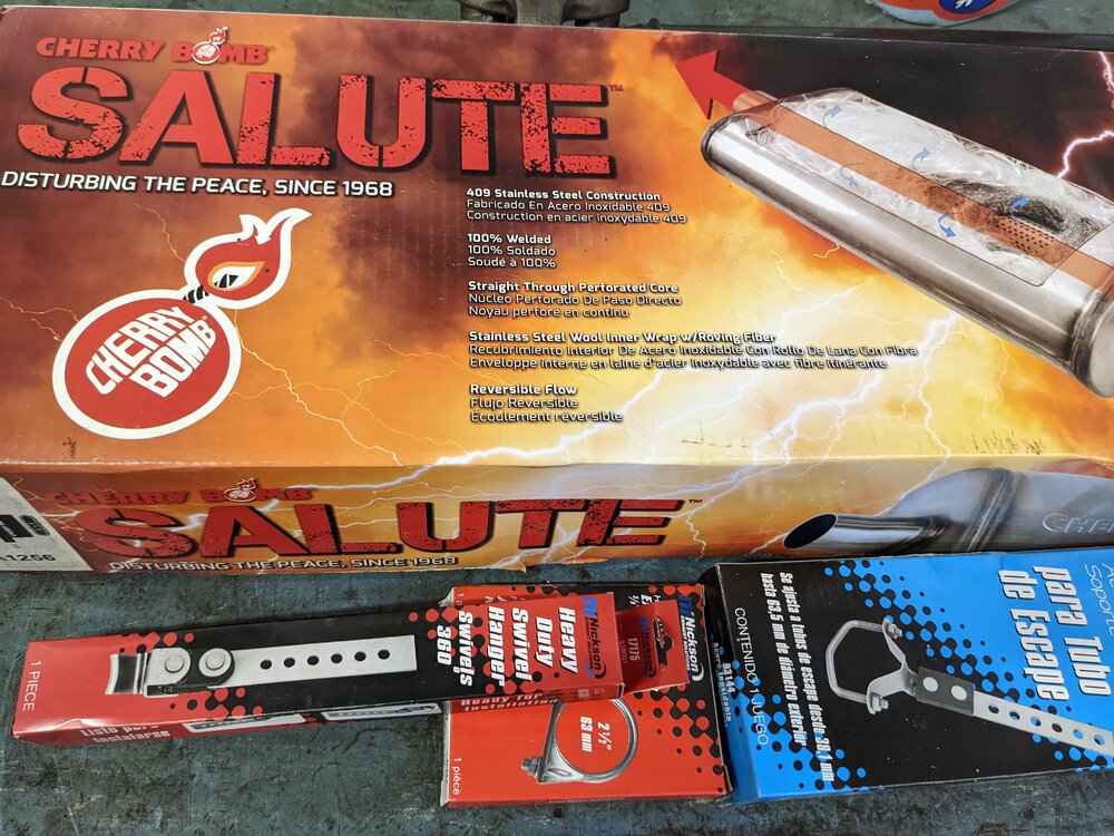

The Borla muffler is headed for the scrap bin. It was loud prior to losing it's baffles, now it's annoying.
Stopped by a local muffler shop and checkout their inventory. Decided on this Magnaflow knockoff (times are hard when you buy name brand Crocs) due to it's small dimensions and longer case length. Current muffler is 14" whereas this one is 18". Should certainly quieten it down a bunch.

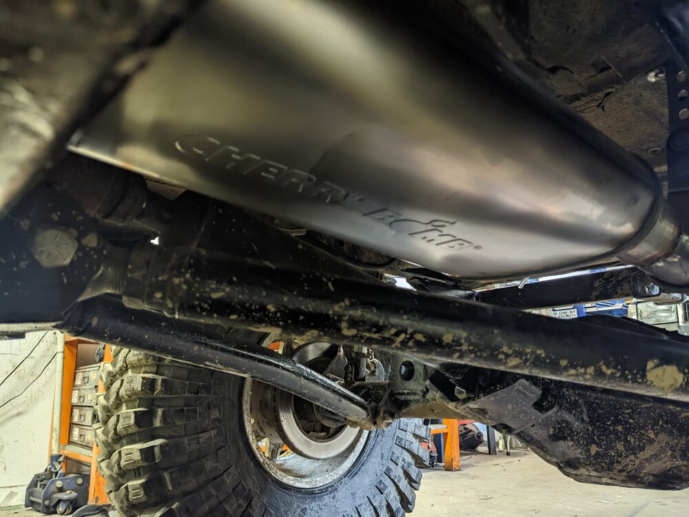

Had a little time after work to tinker.
New muffler and relocated tailpipe is on. It sounds killer. The Borla was essentially gutted, no wonder is was so loud
Also snugged up all the transfer case nuts since they were finger tight. Went ahead and welded nuts inside the skid so a wrench wasn't needed to hold them.
