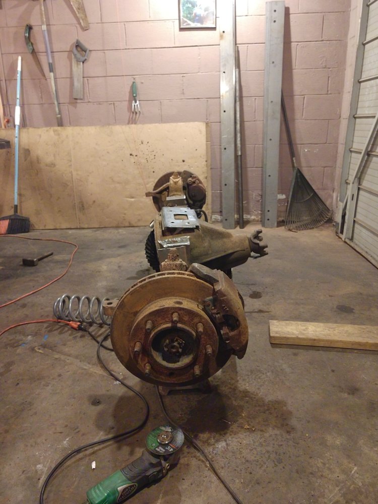

Is the caster on this ok, this is where I'd like to put pinion pointing if that caster is ok..looks to be right at zero, thank you

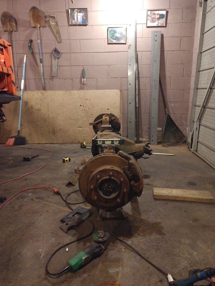

I don't know that I'd be okay with a 0 degree caster angle... Even exclusively for trail driving. If that's where you want your pinion pointing, you might need to do the ol' cut-and-turn just like on the Scout 44s. Depends on how you want your steering to act. 0 degree caster will let it have a good deal of wander at speed, but then again if you're only going to be crawling through the trails...it's your call. I'd level it by the spring pad cast into the differential and see where that puts your pinion, and see if that is something you could be happy with. From there, I'd measure the caster angle and then see if you have any room to change it. I'm assuming you're going to be using radius arms or links?
Yes going back to long arm probably 3link or 4. I'll check it level off the spring pads..
Shoot for 5-7° at ride height. If you're not running a cv/double cardon shaft up front you don't want the pinion pointed up at the tcase.
BTW, those aren't leaf springs pads cause this had coil buckets previous so what the world are they
Oops, my bad. Just looked at a bunch of pics for Dodge D60 and saw them there, too...still haven't found an explanation, but I'm bored...maybe I'll figure it out. Pics fo proof.
Sent from my SAMSUNG-SM-G890A using Tapatalk
I am gonna be running double cardan shaft and dual cases so I guess I'll be fine with this ..roughly 2degrees level with those pads
I'm also going for long down travel so that's my whole reasoning..I hate binfing/breaking driveshaft so pointing at the tcase has served me well for many many years
Still haven't seen pics of one of these axles in a stock pickup, but the only thing I can make sense of is it is a flat pad for a bump stop. That's my story and I'm sticking to it!
Gotta be, I'm sold lol
