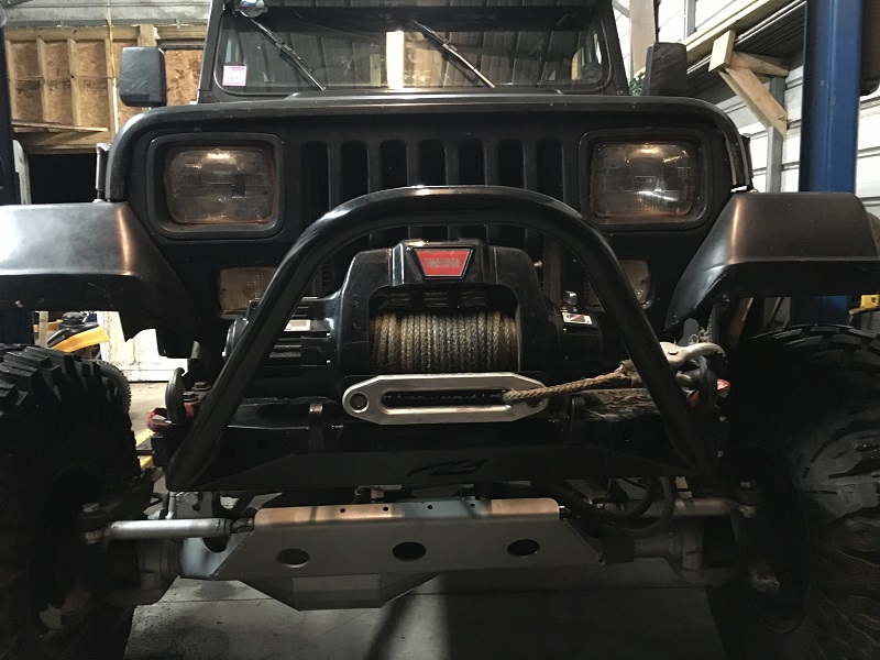

I really like those motobilt bumpers, can't wait to see the rear one he is coming out with soon.
I hope to have parts back in the shop later this week to start welding out. It shouldn't be too much longer.
Looking great Ken. Let me know if I can help with anything else. I am glad you like the bumper.
FYI... for others I have one sitting on the shelf with a stinger ready to ship. Call us at the shop or check it out on our website. Lets get one on the way to you.

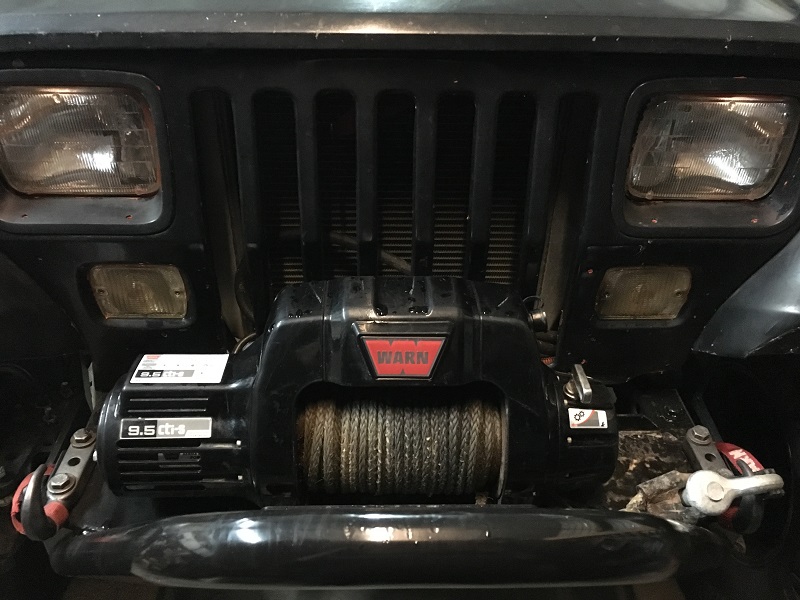

Yeah, and the bracket is pretty substantial. It probably hits on the little nubs for the D rings.
I am sure I could make one work :)

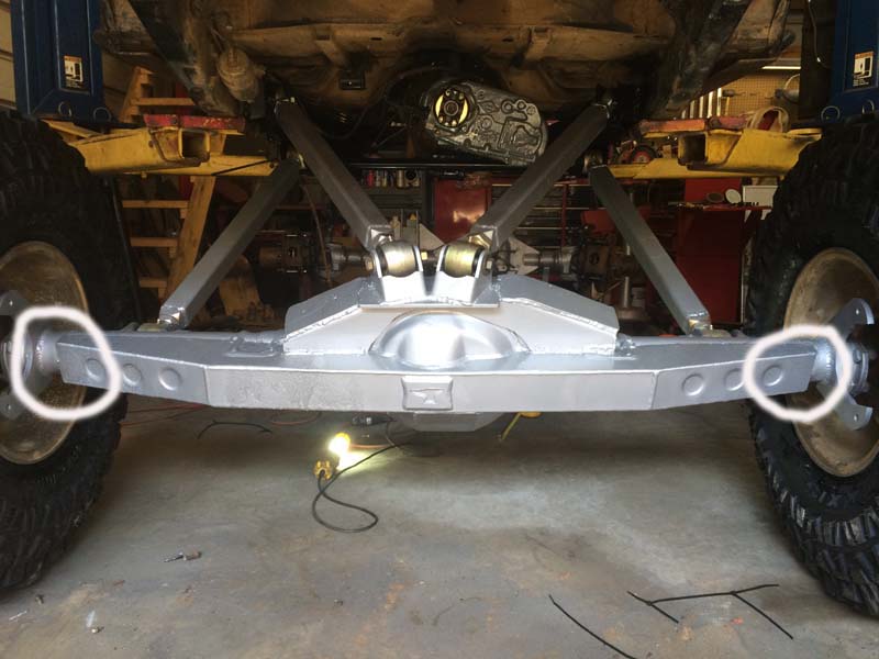

when I was on my moab trip I kept having gear axle leaking of my rear axle which I temporarily fixed with the RIGHT Stuff gasket sealer. we thought it was the axle seals but after many times of driving and wheeling we have figured out that we think the original breather tube in the 9" axle tube was never sealed when the rear brace was welded on or there is a hole in the tube inside the rear brace so gear fluid is leaking into the rear brace then dripping out the sides when I lean the jeep to the side.
the white circle areas are where I have now welded up the brace so looks like i may be carrying extra diff fluid if anyone ever needs any when wheeling :)

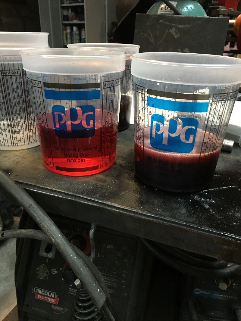

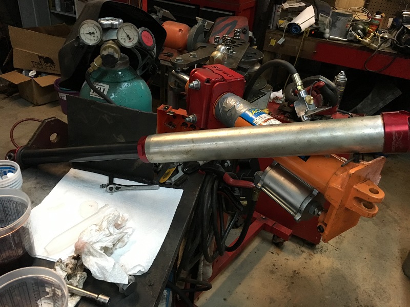

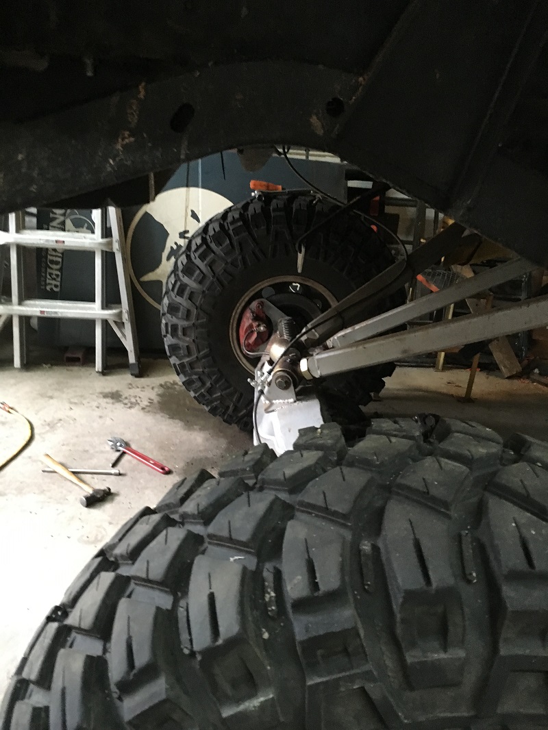

finally took off the rear air shocks and drained and refilled the fluid..hoping this helps a bunch when going over woops
they had about 275cc in them and we filled them to 400 to test and see the difference
difference in old oil vs new oil

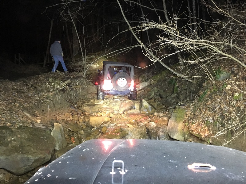

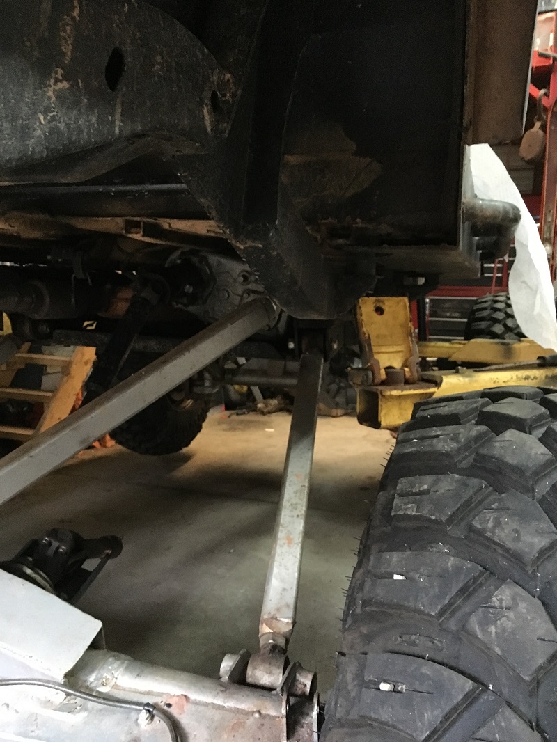

the 4 link kit flexed great and made easy work of some very hard trails in Harlan KY
Trails we did, lower rock garden, middle rock garden, upper rock garden, killing time, Lower Profanity, Upper Profanity, lions den and a few more I forget the names

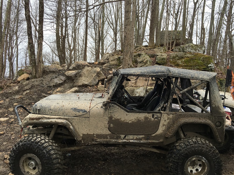

And how not to drive up the trail
