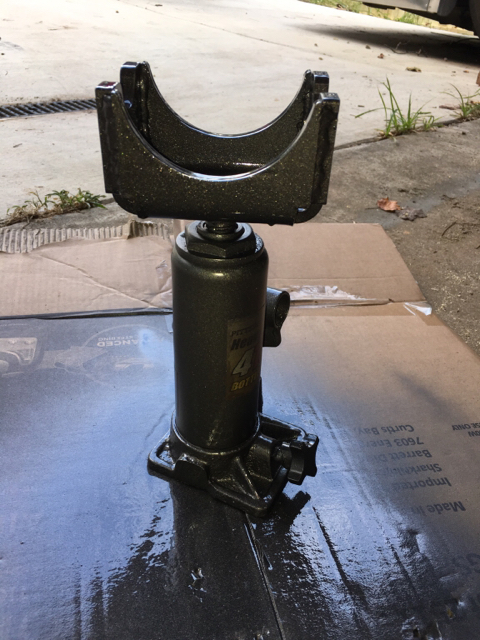

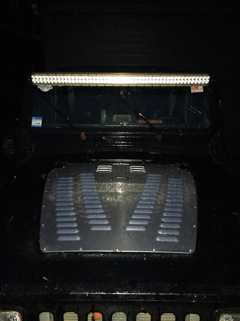

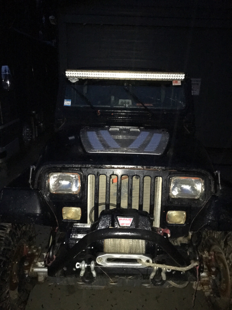

Small project for jeep.

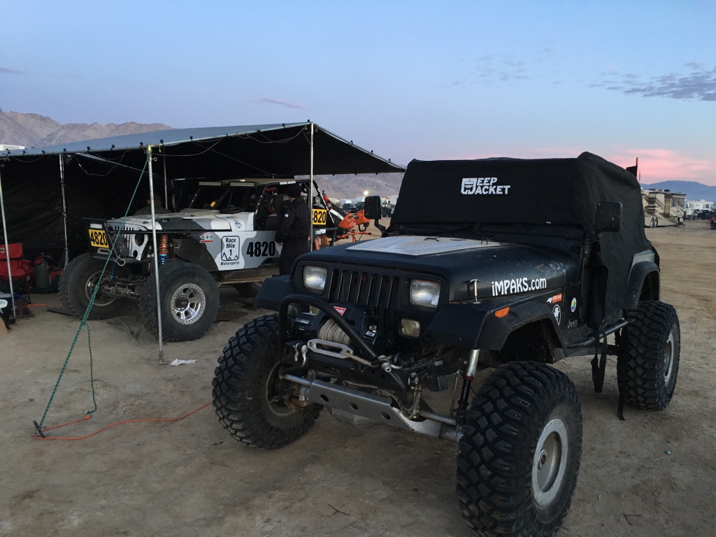

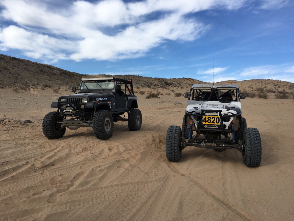

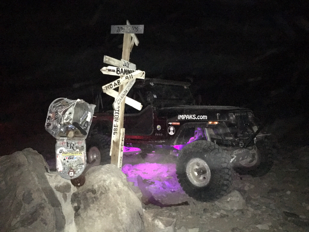

Took the jeep out to King of the Hammers. Walked chocolate thunder and even drove the ledge on sledgehammer. Jeep did awesome and was a great pit vehicle for the 4820 race team
Back side of chocolate thunder

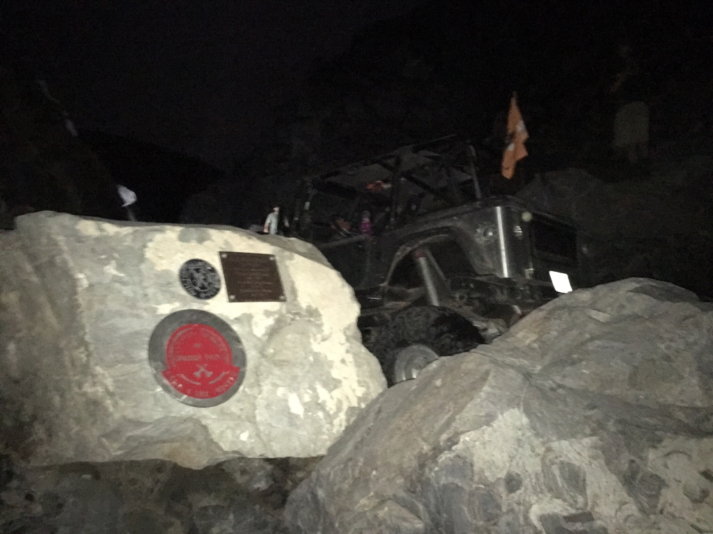

Sledgehammer plaques

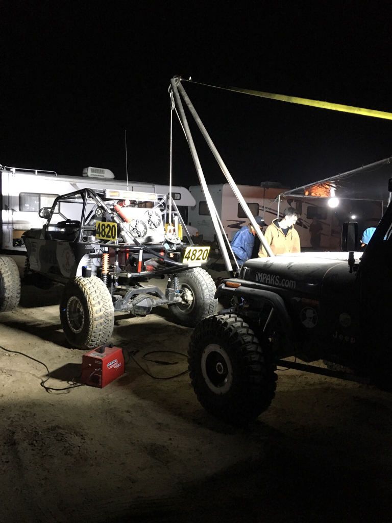

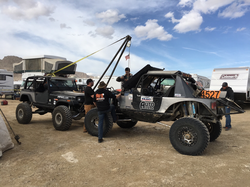

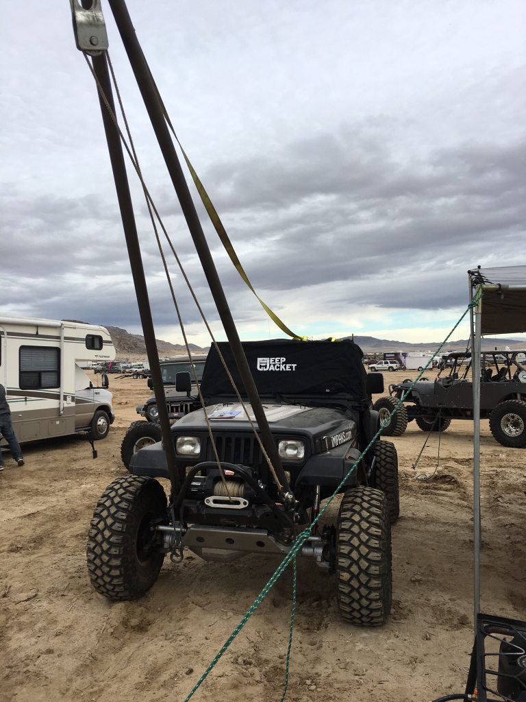

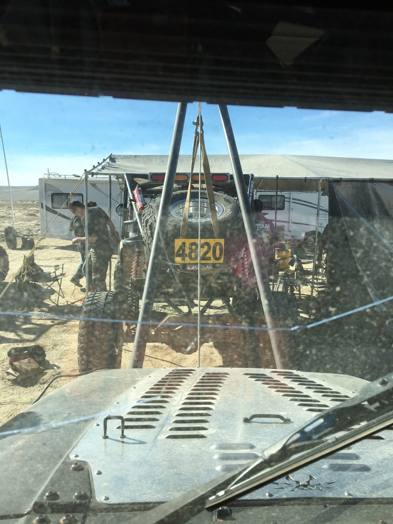

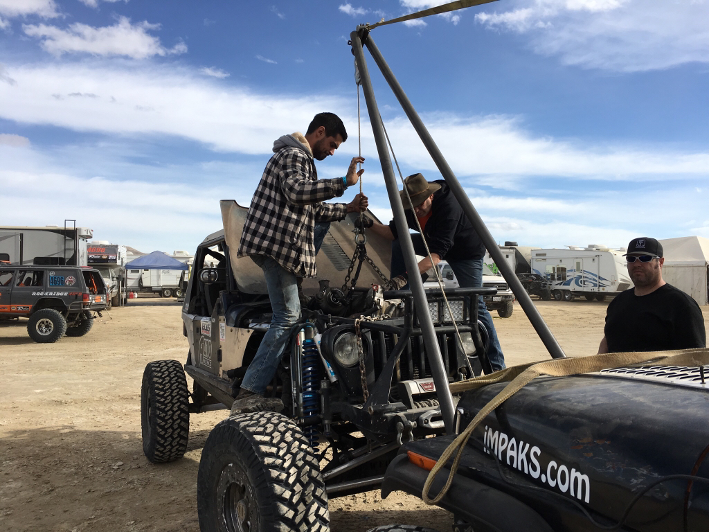

Helping the race team with the redneck crane

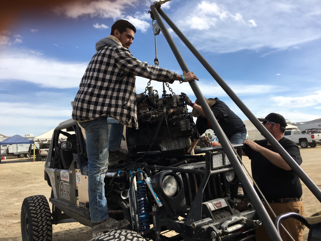

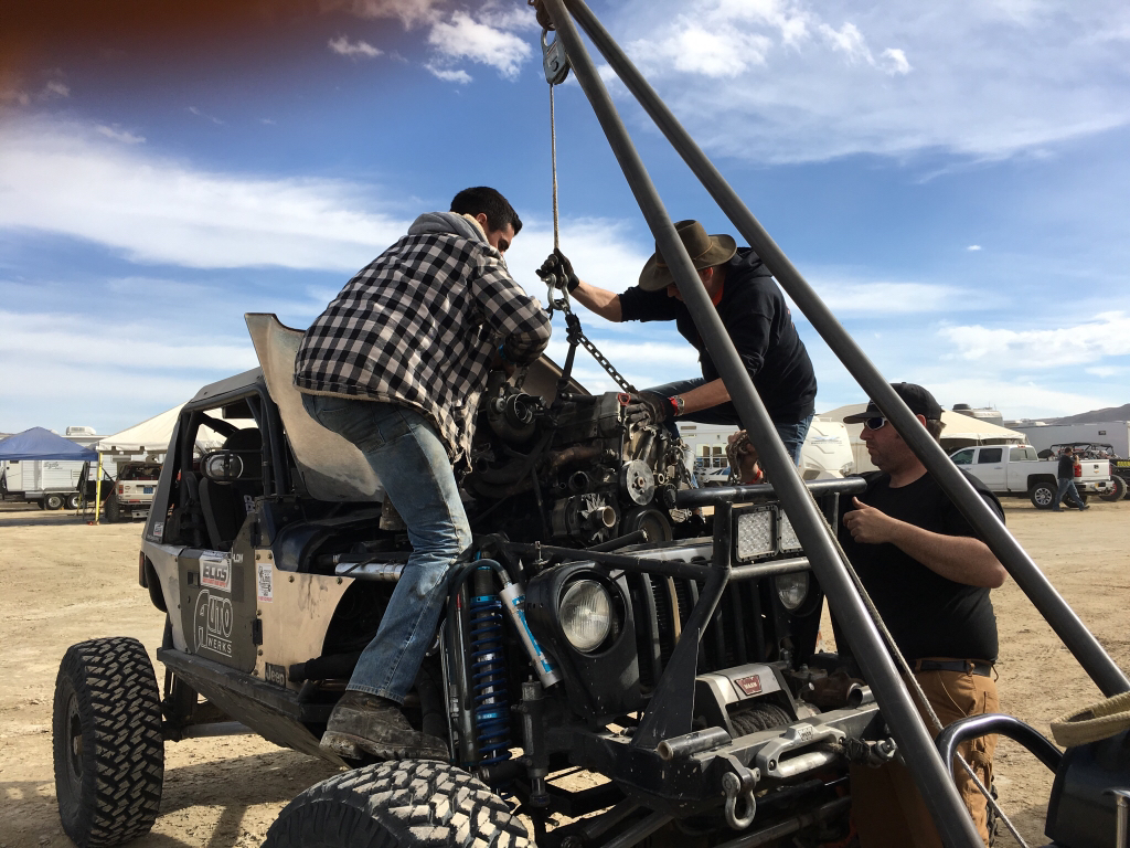

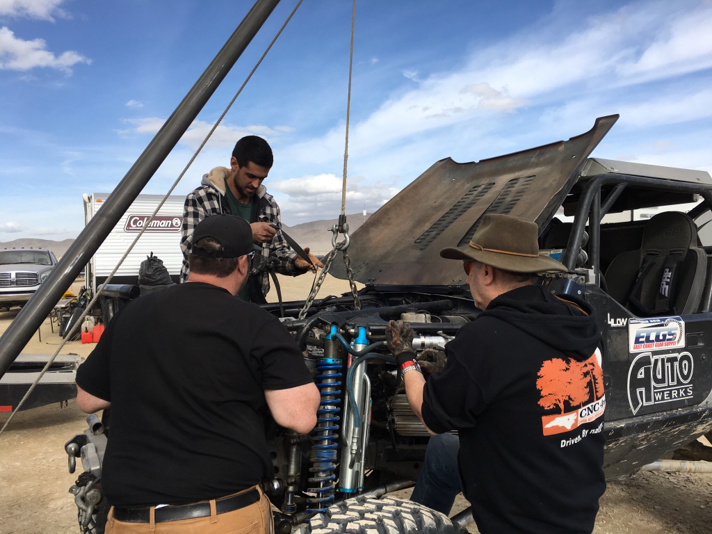

Another racer blew his motor so we helped him remove it with the crane.
That's awesome. What does the jeep crane attach to on the front of the jeep?
I have to small tabs welded to the bumper. A bolt goes threw the tab to a tab on the long poles which allow the crane bars to rotate and become steeper if needed.
I know I could find your thread on the crane, but what material did you use, and the bar lengths? Ive been contemplating one for some time.
thats v2. first version was a stick of 1.5 .120 DOM tubing cut in half and it worked great (till it was bent up from a winch malfunction). v2 is a stick of 2" pipe cut in half. Its a little too heavy. Either one will lift 1k lbs or more.

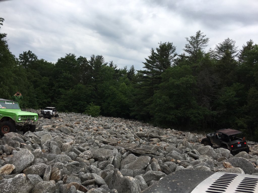

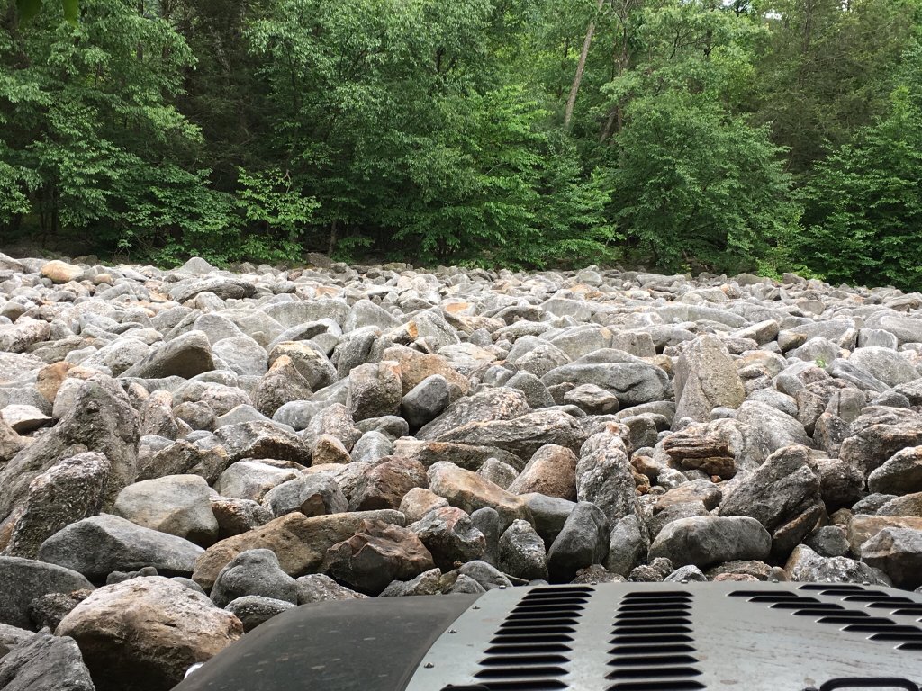

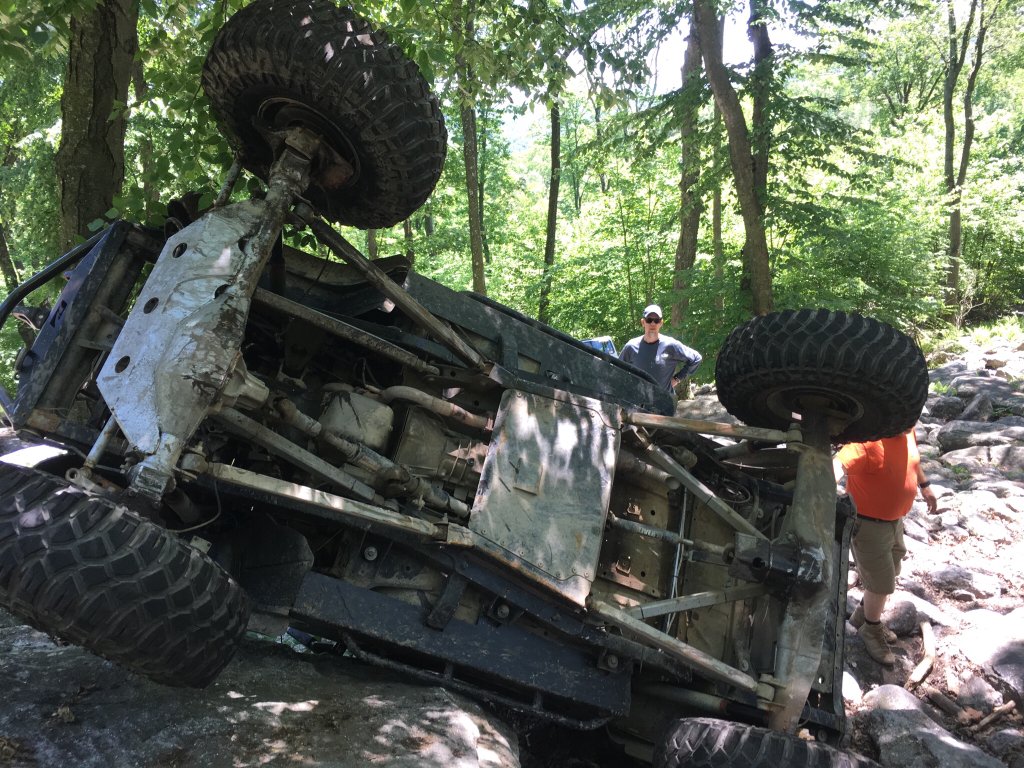

Had an awesome time at Rausch Creek this weekend. CNC4x4 had 11 people trail riding.
We did just a ton of trails I can't even remember all the names and even some brand new trails that just opened this year.

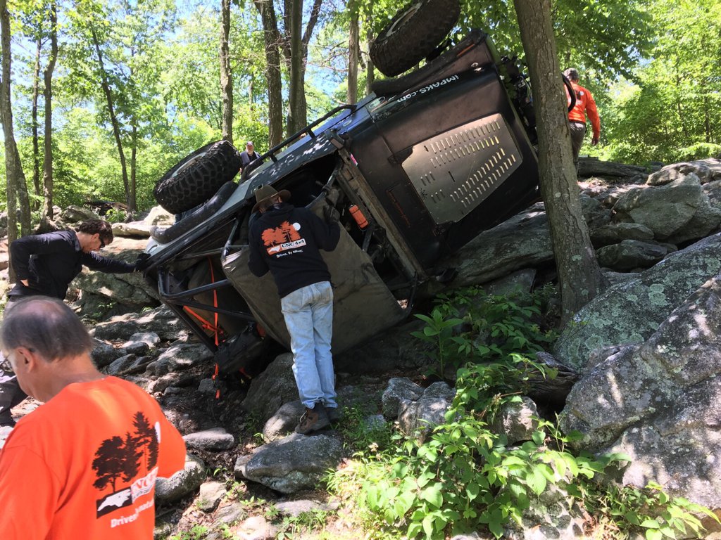

I did have a big oops when I grabbed 4th gear instead of reverse. But jeep is fine and I am fine so no biggy.

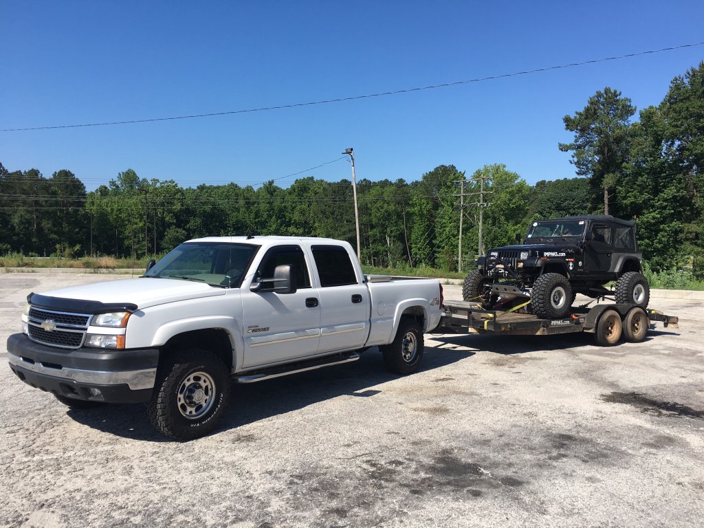

Just drove 10 hrs to Louisville KY to meet up with a few buddies. We are going wheel across KY and end in Harlan then CNC4x4 will show up and I will wheel with them all weekend at Harlan
