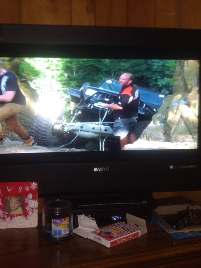

Ha I am watching this episode right now
Sent from my XT1635-01 using Tapatalk
well I watched it and I am happy to say my jeep was in it a lot more then I thought it would have been.. they did a good job of capturing the multi day event

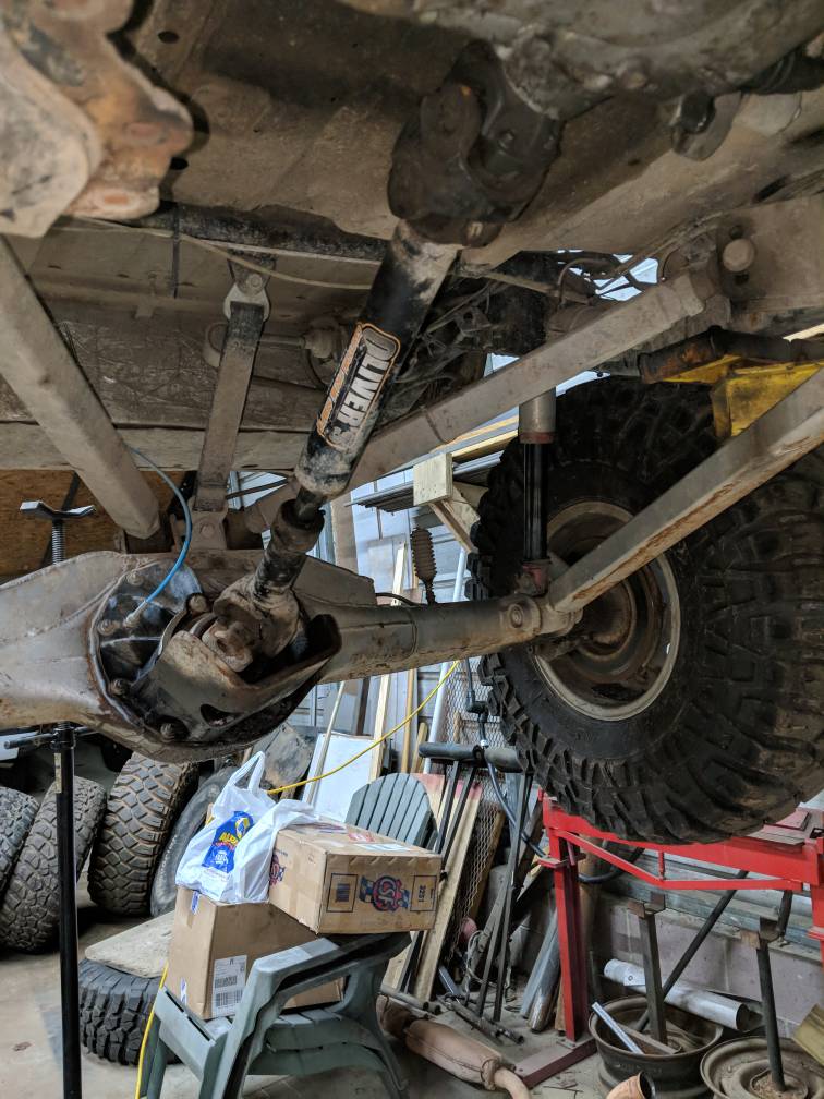

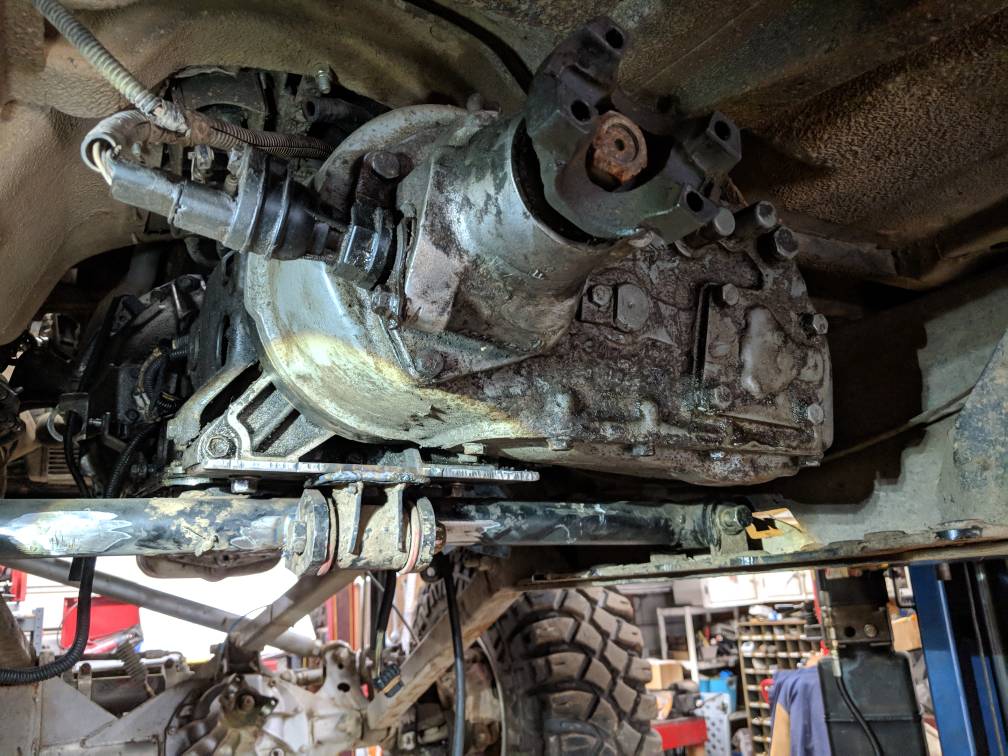

After spending way to much time on the xj time to fix the yj. Clutch went out so started to rip apart the yj yesterday. Hope to get more done today
The beast with out skids

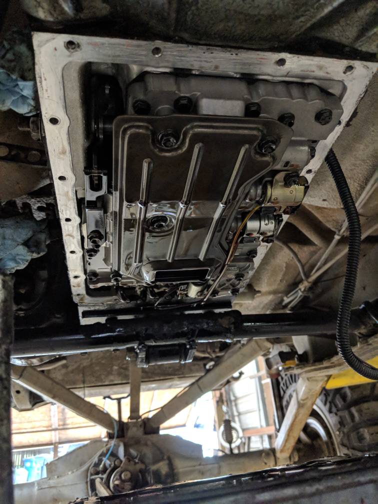

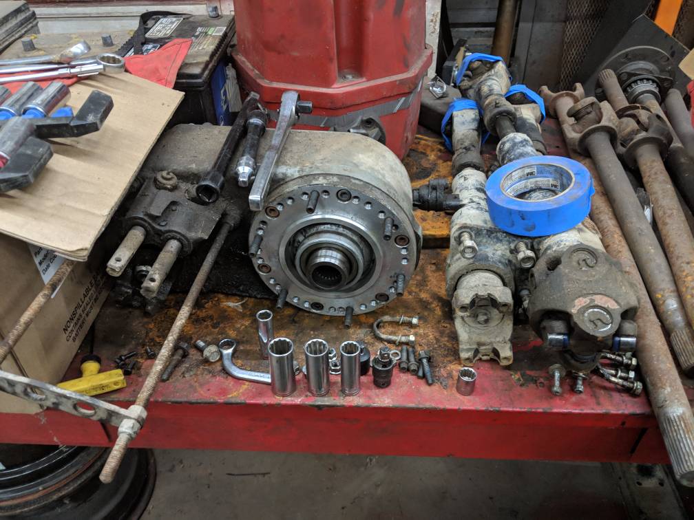

Well got it all out.
And found the damn slave cylinder is bad. I don't think I actually had to take it all out :( clutch looks great.
Oh well. Maybe I will put in an auto since it is all out.

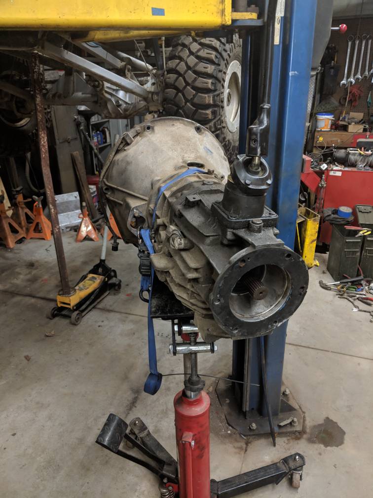

looked at my stash last night and found 2 - AW4 tranny's, flex plate, dust shield, computer, shifter, neutral safety switch, tranny cooler, torque converter.
So looks like I am gonna dive into an auto swap..
wonder how fast I can get this done as I need to get YJ off the lift to get XJ back on it
this should be fun :)

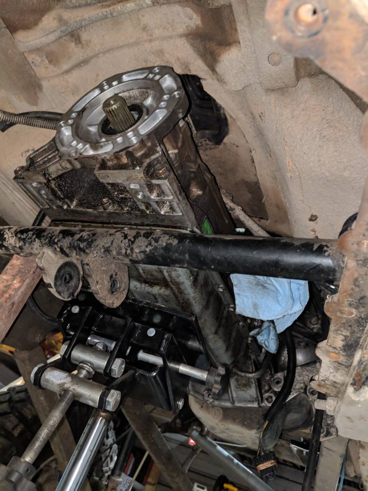

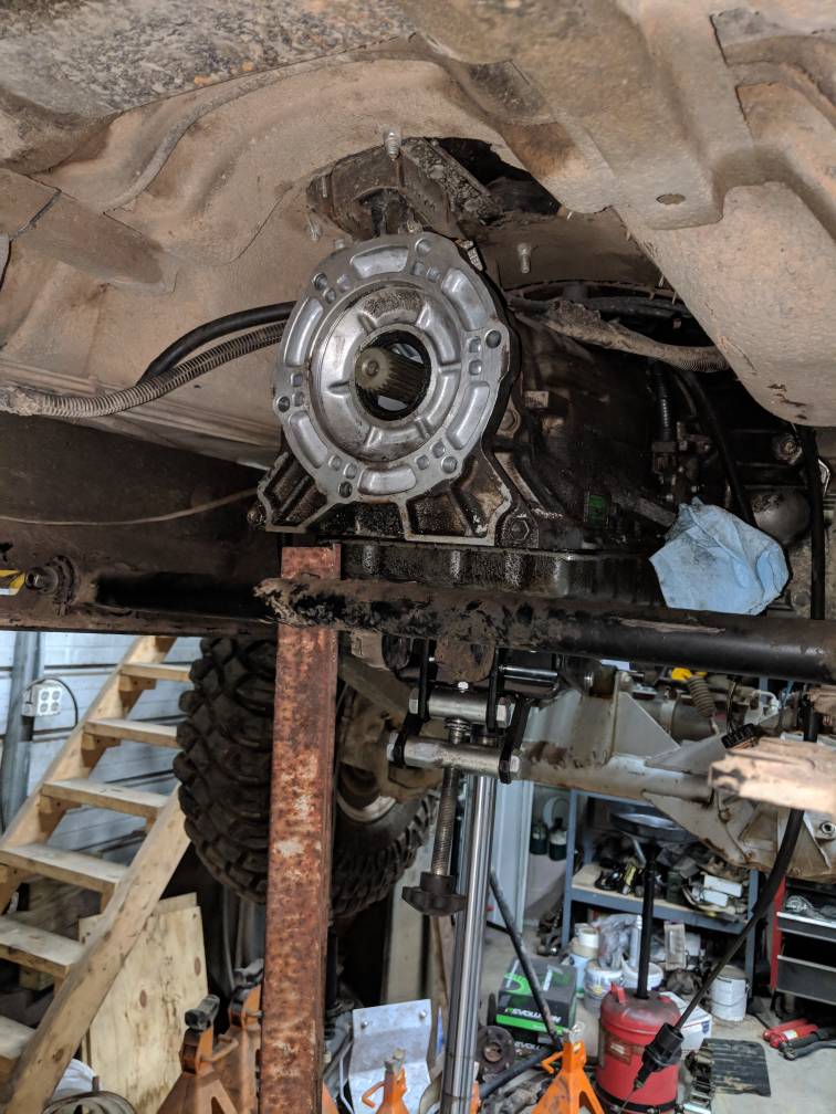

Making progress. Next is to get transfer case in so I can set height for crossmember.
Then I will start on all the wiring.
The transfer case in and tranny mount done.
Also did a filter change on tranny.

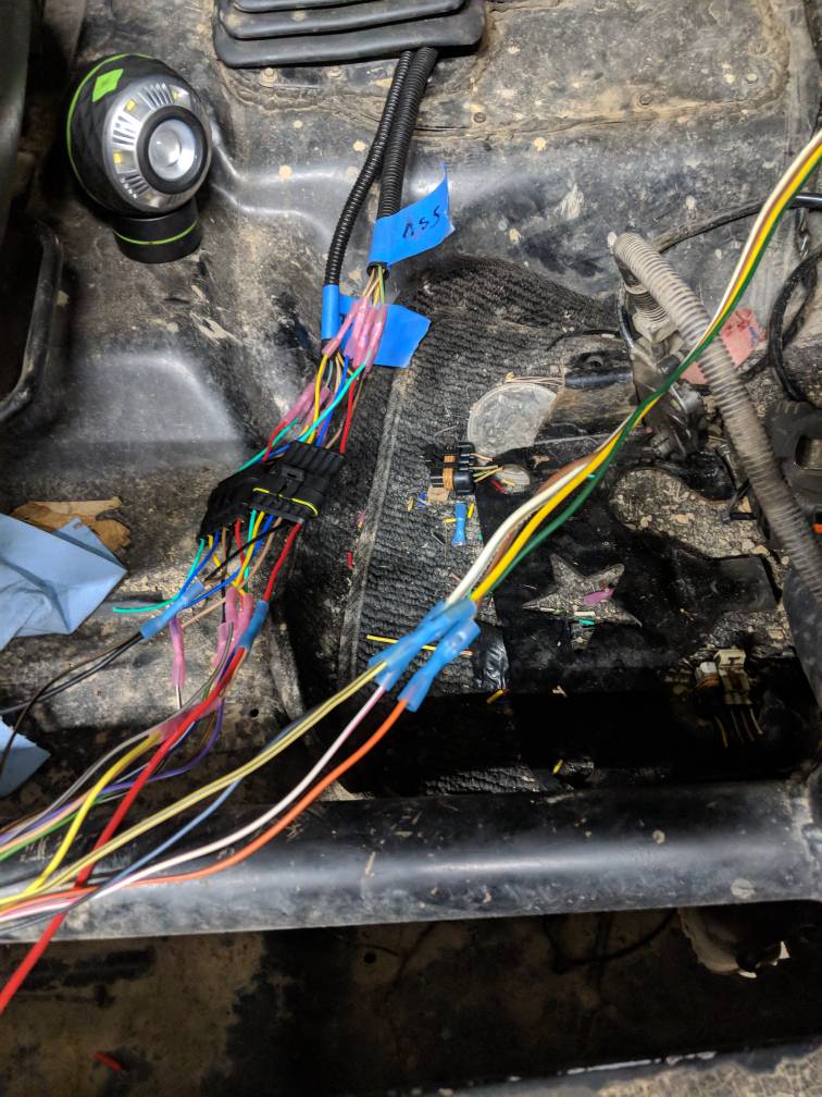

Next is to start wiring it up.

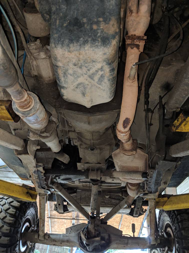

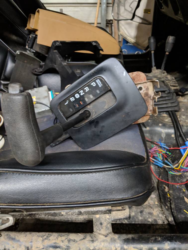

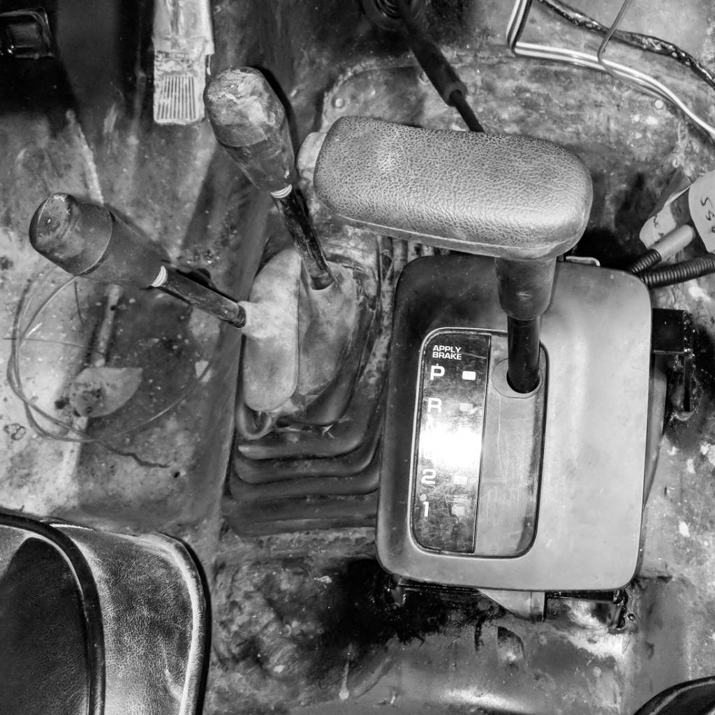

Happy to say we.got the wiring connected and got the Jeep started again. Even got the wheels spinning :)
Need to.mount shifter and clean up all wiring
How is the length compared to the ax-15? Could you reuse both driveshafts ?
it was about 1" longer.. so all my driveshafts worked with no issues.. I did get super lucky and since I have a two piece shaft the driveshaft from transfer case to block I made adjustable when I first did this and I am super happy I did other wise I would have had to make a new shaft for that part.
Was the wiring part difficult or pretty straight forward? Also we’re there any specific write-ups you used or followed for the swap?
pain in the butt and until I drive down the road and make sure it fully shifts correctly under load I am not 100% sure wiring is 100% perfect :)
used stuff we found at stu-offroad.com
I have an XJ motor in my YJ with YJ wiring harness and used a ZJ aw4 with a CJ dana 300 :)
