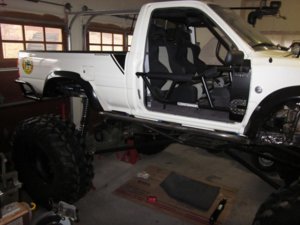

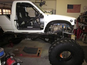

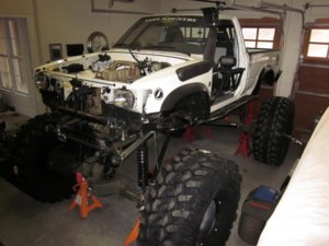

Will brought my tires over yesturday. Thanks Will! They look like they will fit up well... As you can see from the pics I stretched out the wheel base for better stability. Also check out how wide this truck is:
wow....that truck is tall. I would've kept the boggers and lowered it. You're soon going to find out how bad the 49" irocs bring the suck.
Not really my thing, but pretty cool in its own way.
how much are you going to have to take apart to get it our of the garage. I just noticed the doors look lower and not wide enough

Also, the pics are a little miss-leading. I am pretty confident It will clear the garage doors ok. Will and I were looking at it the other night and it should not be a problem. The doors are 8ft tall and 9 ft wide. May have to air down some. Also the truck should sit a little lower in the front. I still have a 250+ pound winch bumper, a 120 pound tranny, and a transfer case to be installed.
I have built several rigs in the past, however nothing this major before. It is hard to predict exact measurements when everything is custom like this. So I was not really sure how the stance would be until I put it all together. You have to rember the only stock parts are the body, frame and dash board. So there is a lot of different variables going on here.

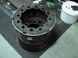

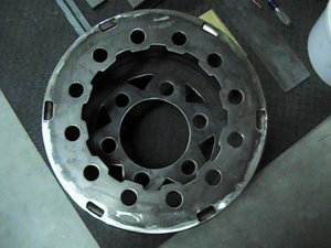

New 16.5 Wheels
After searching around for a while for some Rockwell bolt pattern steel wheels I decided to call Brandon at Rides of Conover.
He advised the cheapest approach would be using H1 military wheels.
I located 8 (12 bolt wheels) H1 wheels on Ebay cheap. I had them shipped to Brandon. We used the insides of the wheels to create four 13 inch wide wheels.
Brandon ordered rim stiffiners and wheel centers from Mud Pros. I was really impressed with the product Mud pros designs and stocks.
Brandon had the wheels welded up and ready to go within two days! His work was out standing. He is also very reasonable on his prices. I would definetly recommend him to anyone needing fab work done! Thanks Brandon! I took the wheels apart this morning and will be delivering them to the powder coater in about an hour......
