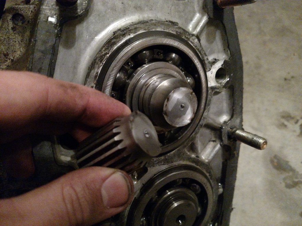

Yup 99% sure I snapped the input on the rear case. I have the cases ready to pull right now but I'm not as young and invincible as I used to be so I'm going to wait for a buddy to come over and help pull them instead of bench pressing them out myself.
The person who bought the gears new is going to see if TG will warranty the gearset with a 23 spline input (I've seen them do that recently) for me. If they will only send 21 spline back I'm going to sell my setup off and build a 23 spline marlin setup. Worst case is they don't warranty anything and I've got to build 23 spline cases out of pocket.

I'm definitely going to go back with marlin. I would have built marlin cases to start with but I bought the truck with stock duals and my old 82 had this 4.70 case in it so I just did some swapping since I already had everything on hand. What I'm unsure of is if I should go through the trouble of swapping tranny's so I can do 23 spline throughout or if 23 spline in just the rear will be good enough.
awww_tacomaworld_com_media_img_20160118_180855858_499723_full_de67642fb1d676ef804ca7c93122e219._.jpg
Not sure about that but I can tell you that your TG 4.7s won't work with the mc 23spl gear.
Yeah I've read that somewhere before hence why I'll sell my whole setup and build another with marlin gears and adapter
