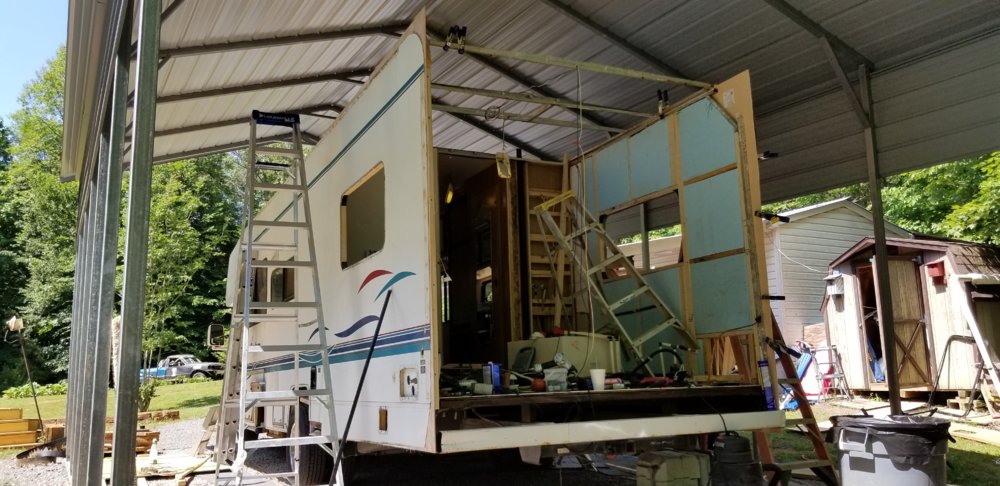

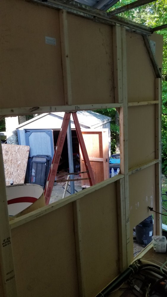

Ok...with all the trim removed, the ladder, lights , and window gone, and and a few wires clipped...
The rear wall should be ready to remove. There is nothing in the way, nothing holding the entire back wall in place, so why is it still standing? Why wont it just fall right down?

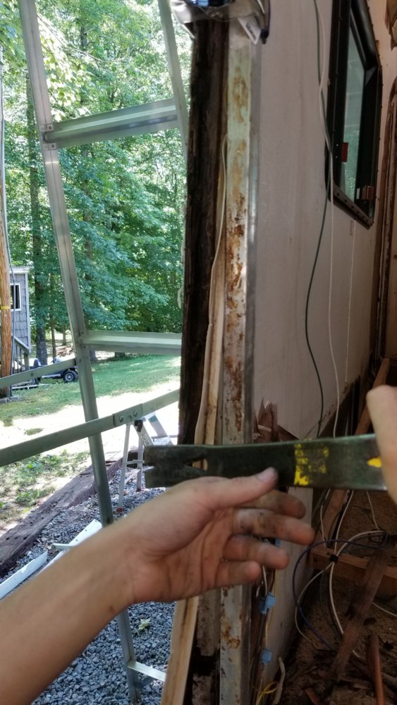

Hand me that prybar..the wood is so swollen, its wedged in pretty good.
What? That's all that's holding it...swollen wood? :confused:

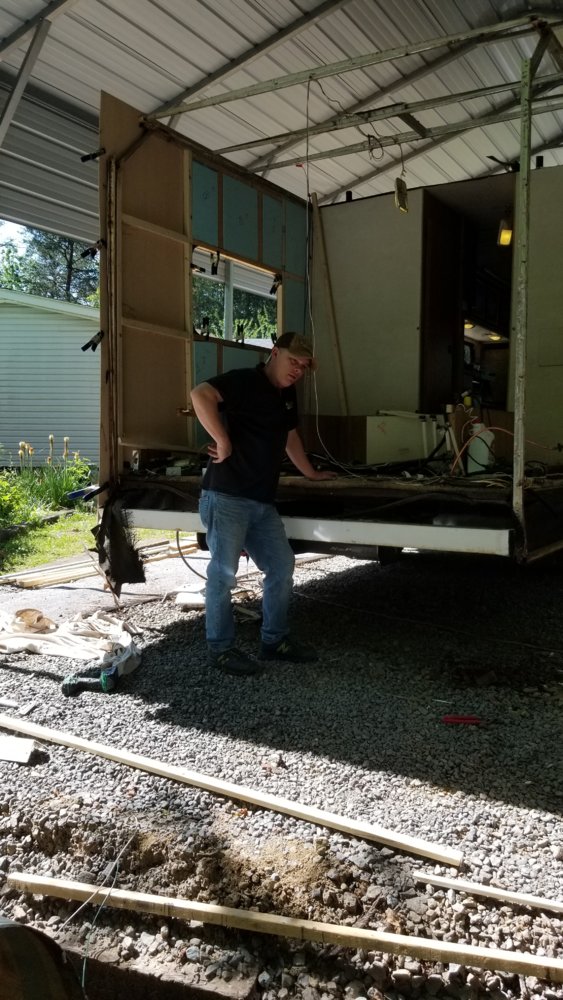

But that last picture of Dylan standing at the back...I mean, how very LITTLE holds these things together :eek:
I think the MOLD was the only binder for this one

Not much holds them together on the best brand new day.
Add 20+ years of life, flex, and water...then you have what we have here. Junk under the skin.

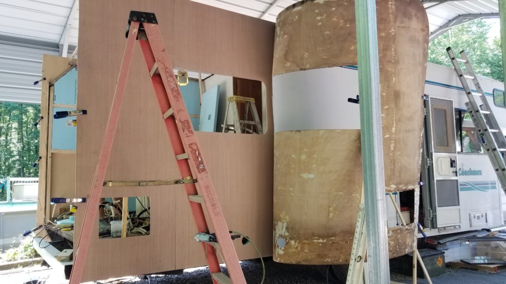

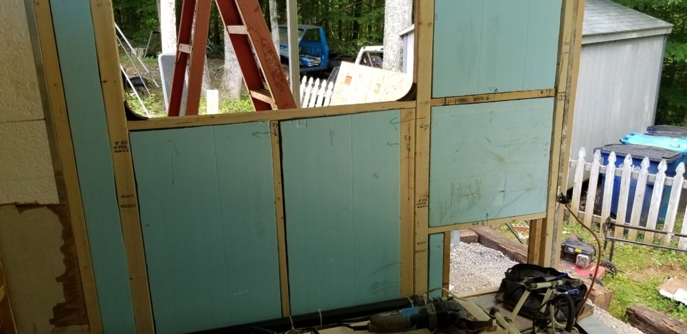

Alot of work has been accomplished, but it's mostly the same stuff/different wall. Passenger side bedroom wall this time.

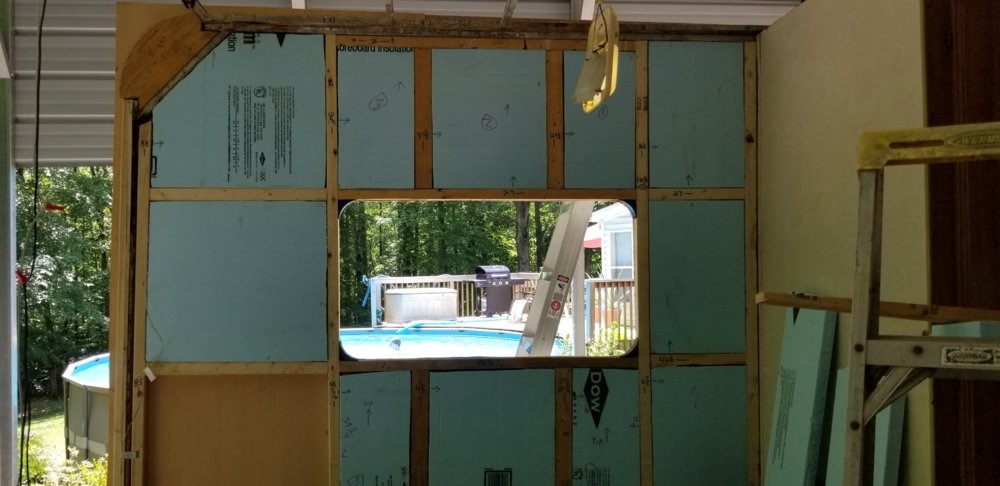

Got her all peeled back with new luan going up. We just roll back the wall skin, hang luan(just a couple tacks to hold it) then roll the skin back into position..trace out windows and outdoor boxes etc..., then pull the luan down, jigsaw the holes, place it back into proper position, then glue, screw and staple them into place.
Then it's time for wall studs, window frames and cutting and gluing up foamboard.

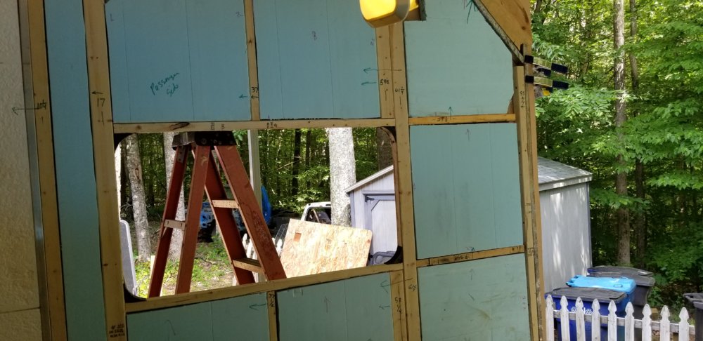

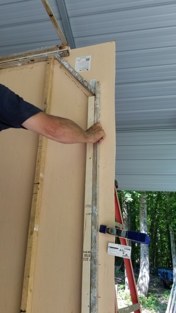

Both rear sidewalls are rebuilt and ready for inside paneling .
Look carefully..these photos will serve as my stud blue prints. Lots of measurements that I will need later, seen here, in these pics.
