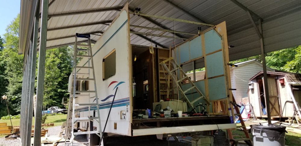

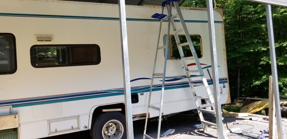

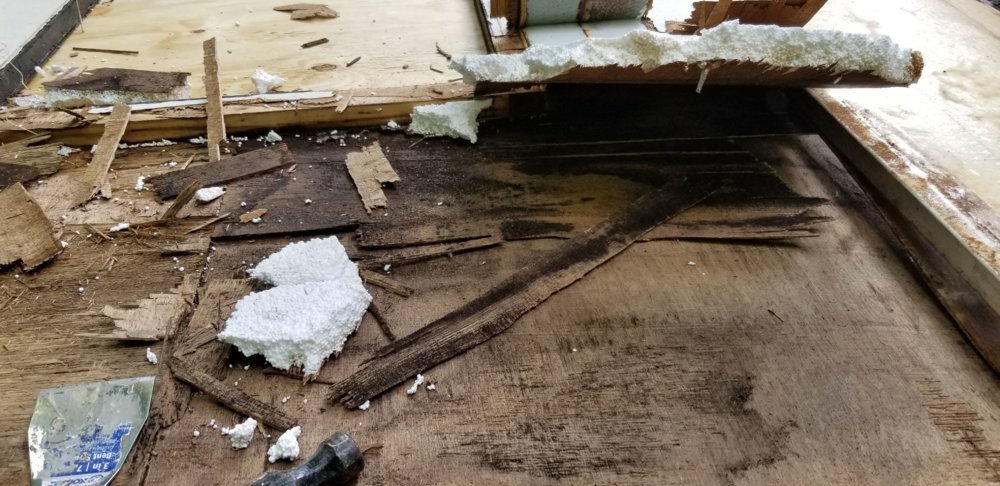

Started digging into the back wall. Was going to strip all the foamboard and rotted panels off of the fiberglass, but it didnt take long to decide that I'm going ALL new. New frp shower panels already purchased.

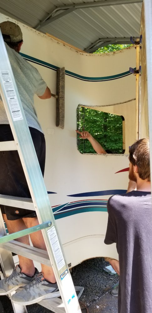

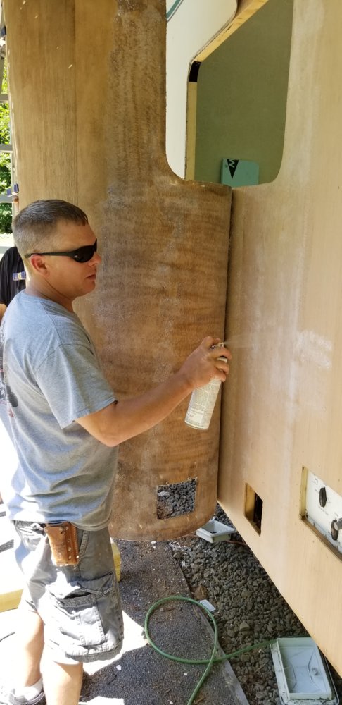

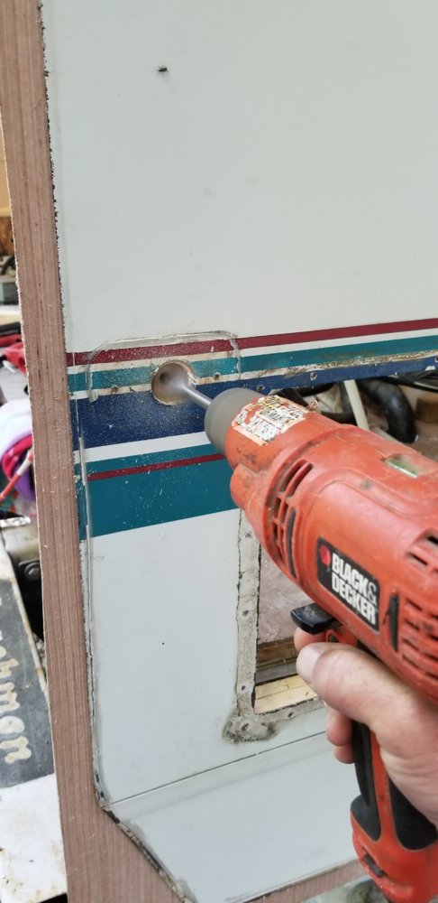

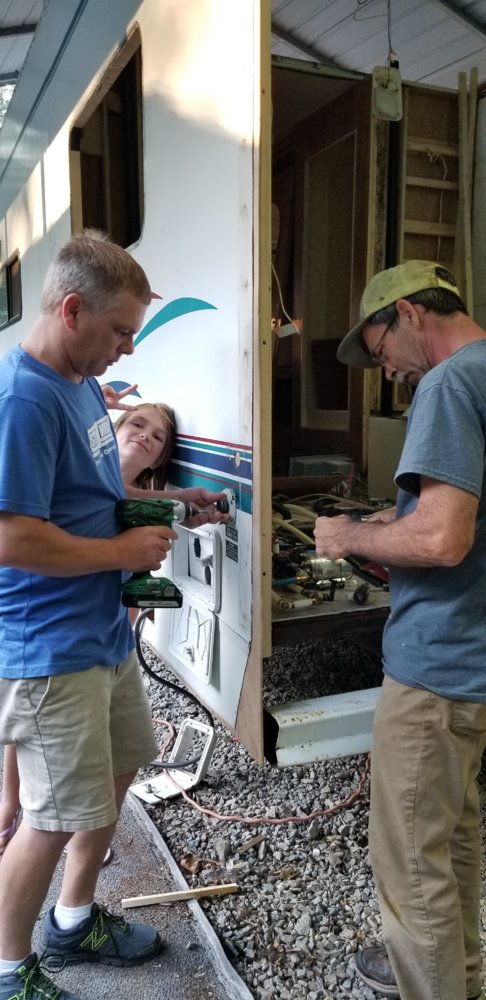

We broke out about 60 bucks worth of stay-put glue and got the drivers side fiberglass stuck back to the side of the rv. Gluing a couple feet at a time, and using a push broom to mash it as we went, seemed a bit safer than gluing all of it at once.

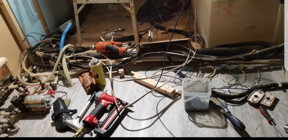

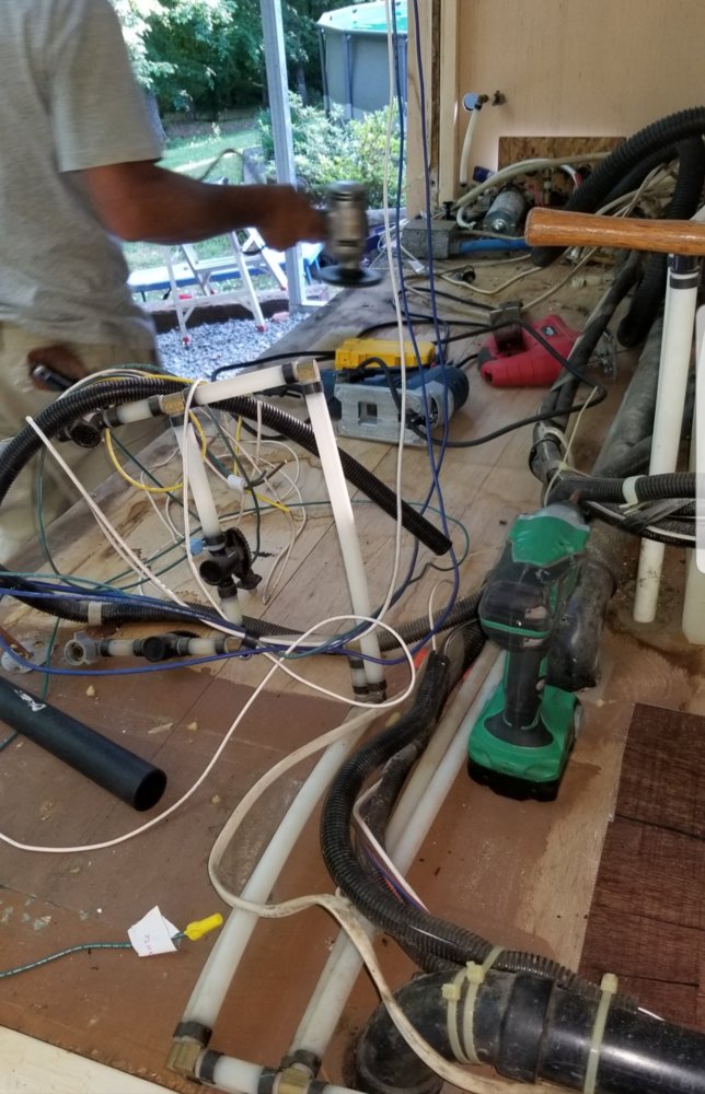

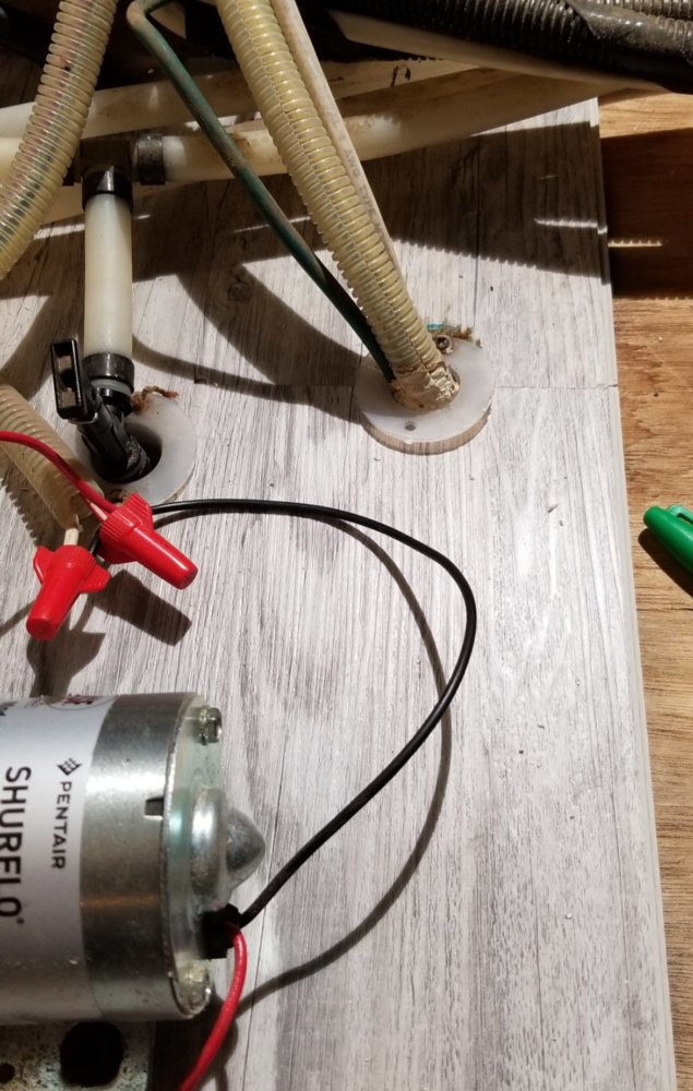

This is at the back, under the bed hidden from everything. Plumbing,water pump,waterheater, drain lines, fill lines. This is essentially the heart of the plumbing. Its filthy under here. Old musty carpet is under everything. This process will be a real pain, but im going to take it all up and remove the nasty stuff.
carpet removed

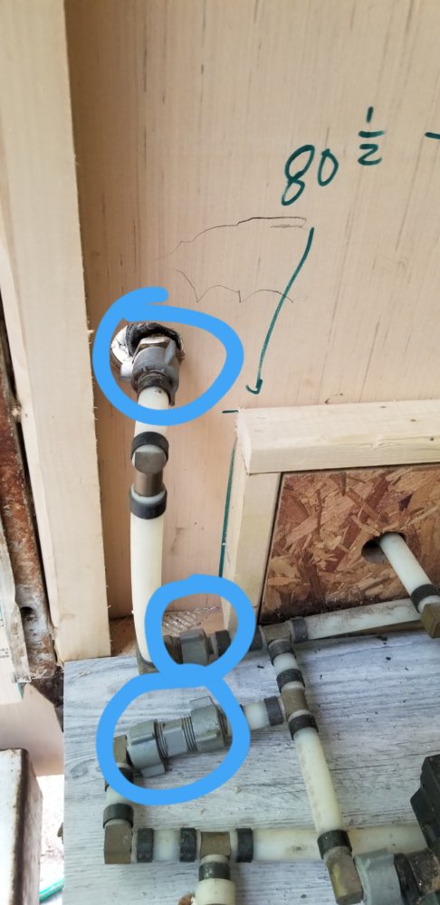

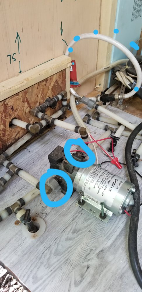

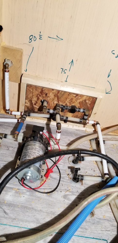

Im worried about some of these plumbing swivels and some of the repairs that were made along the way. Since I have perfect access, I figure its best to make repairs now.:D
This waterline (blue dots)was added during a repair, it did the trick at the time, but im gonna make it all better now. Also, these fittings(circled in blue) have seen better days. Im adding shiny new ones to help insure there's no future leaks. Its a peace of mind thing.

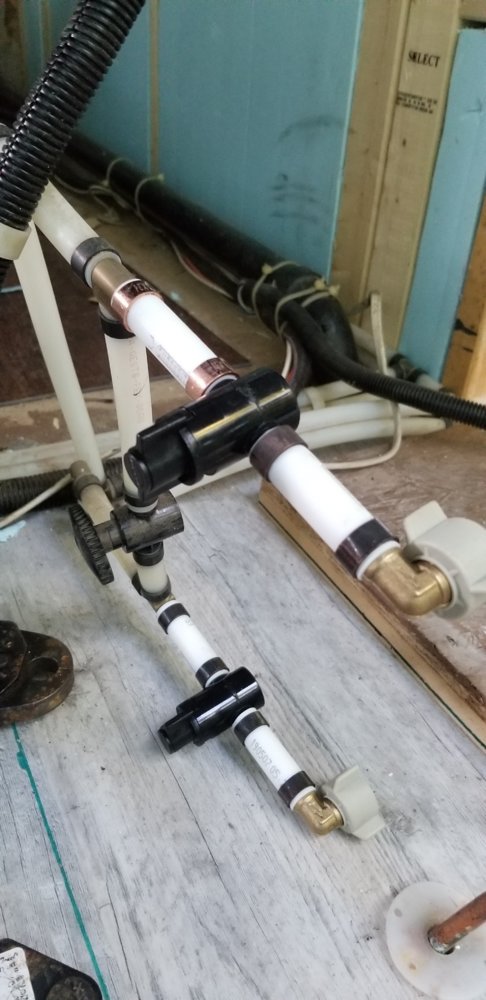

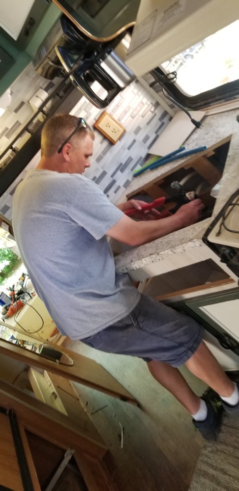

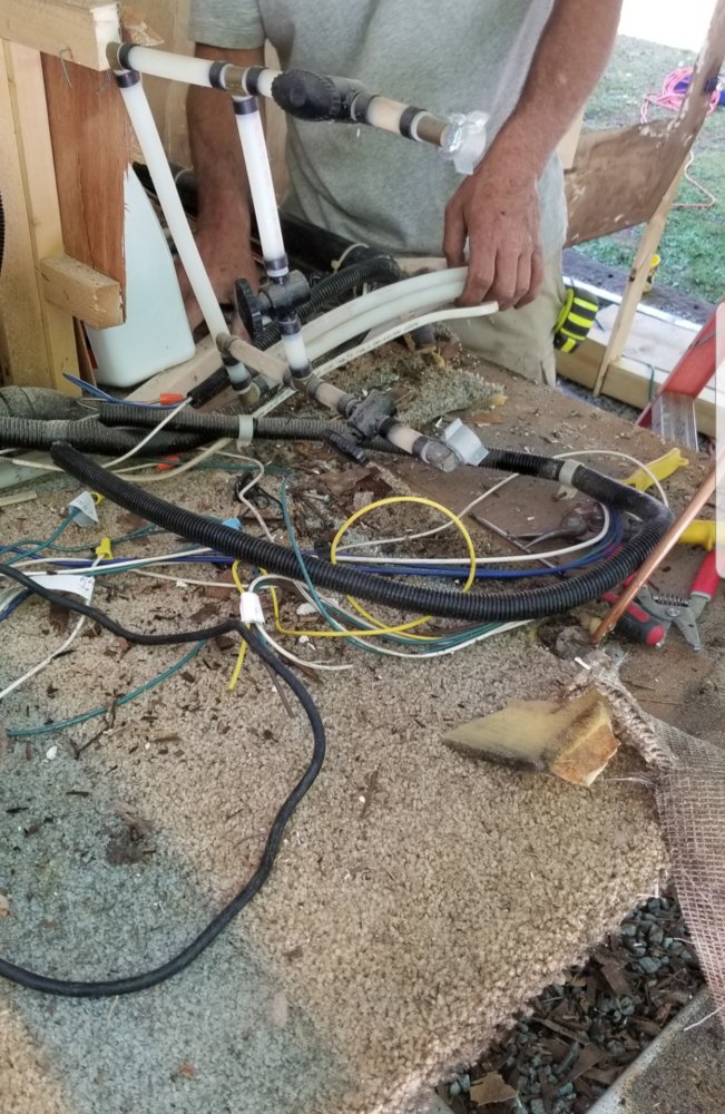

My buddy Brad stopped by. He's a plumber and that makes him a good buddy to have. Seamingly, without much thought, he just started cutting pipe and busting rings. He had everything I could need right there on his truck.
And before long, he had replaced most all of trouble spots.
New cutoffs and swivels. These go into the hot water heater.
And we replaced all of the swivels and made a permanant repair where the water supply line had been added.

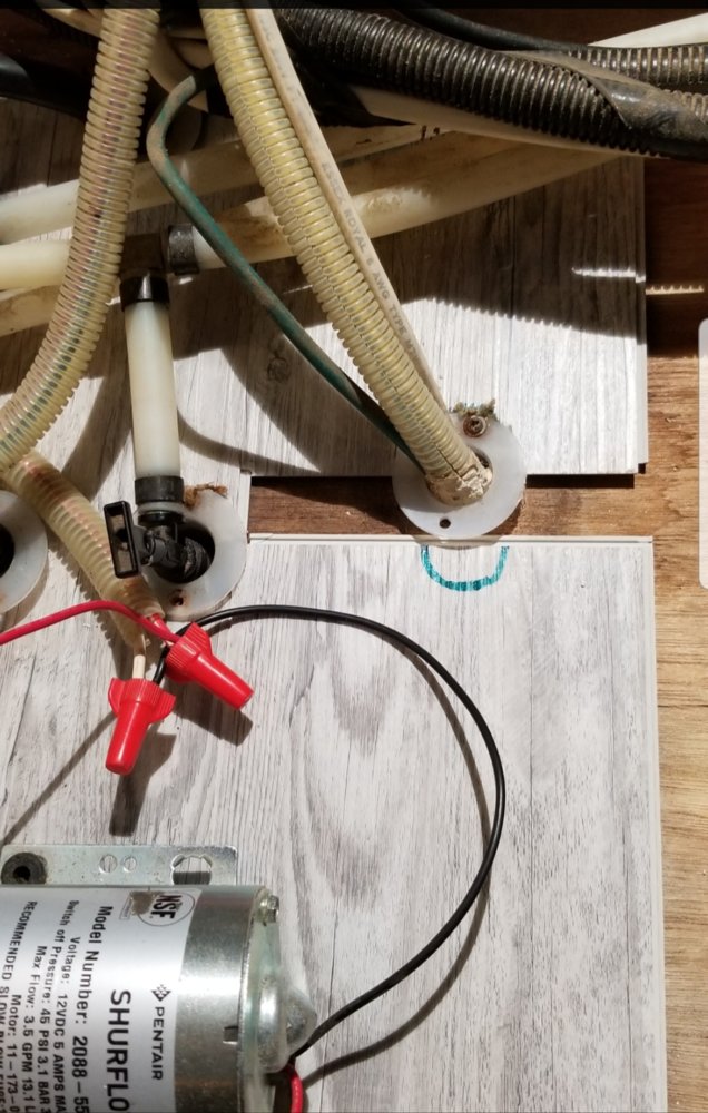

Don’t forget a pulsation loop in the plumbing coming from the pump discharge. Looks like that long loop may have been it even though it looks like a repair of some sort.
Repairs are looking good.
Ummm..pulsation loop? Never heard of it. Please explain.
So..i need a loop in it?
The loop that was there was a simple water supply line. It wasnt factory at all.

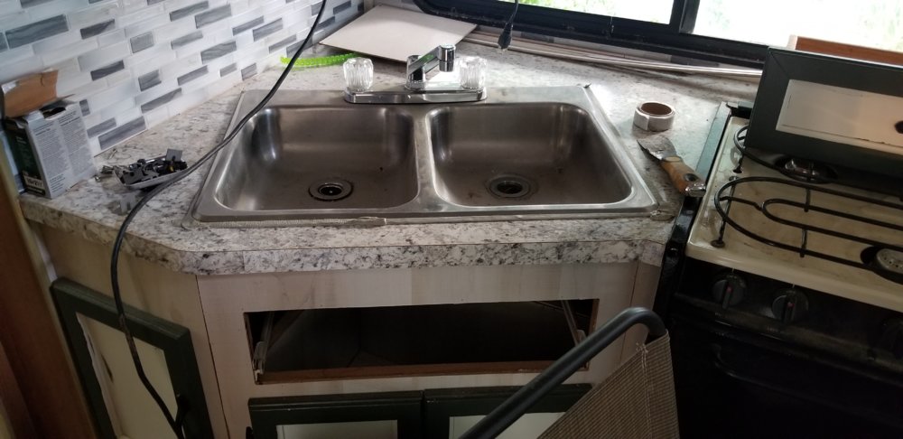

Heres another little project that happened.

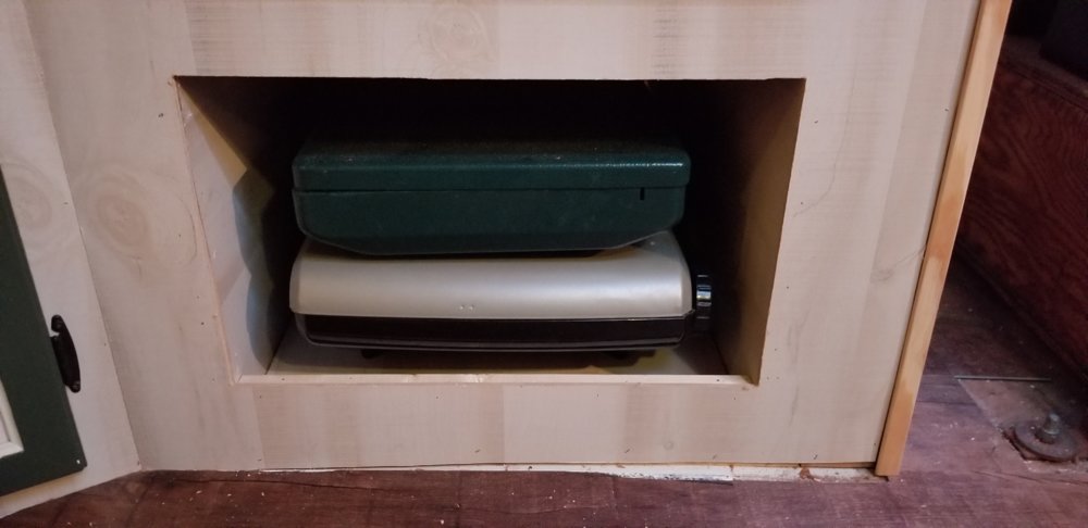

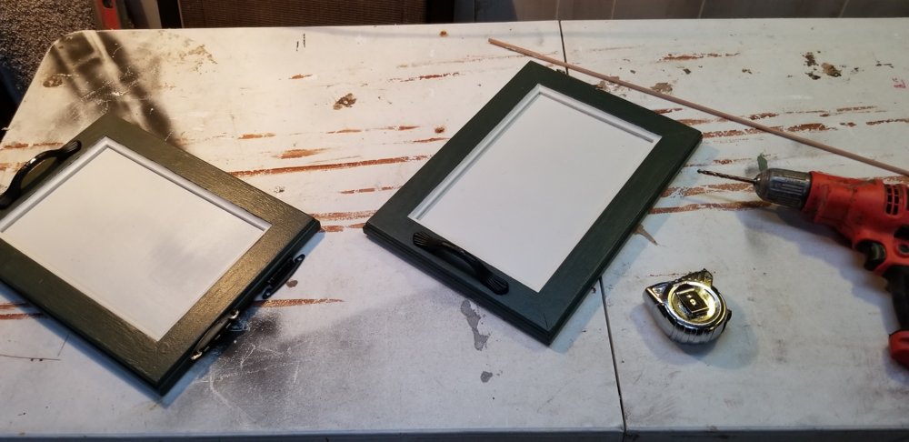

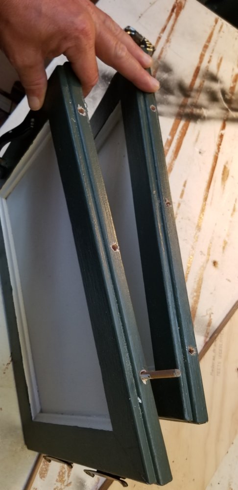

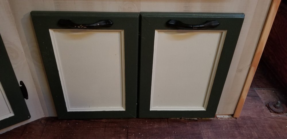

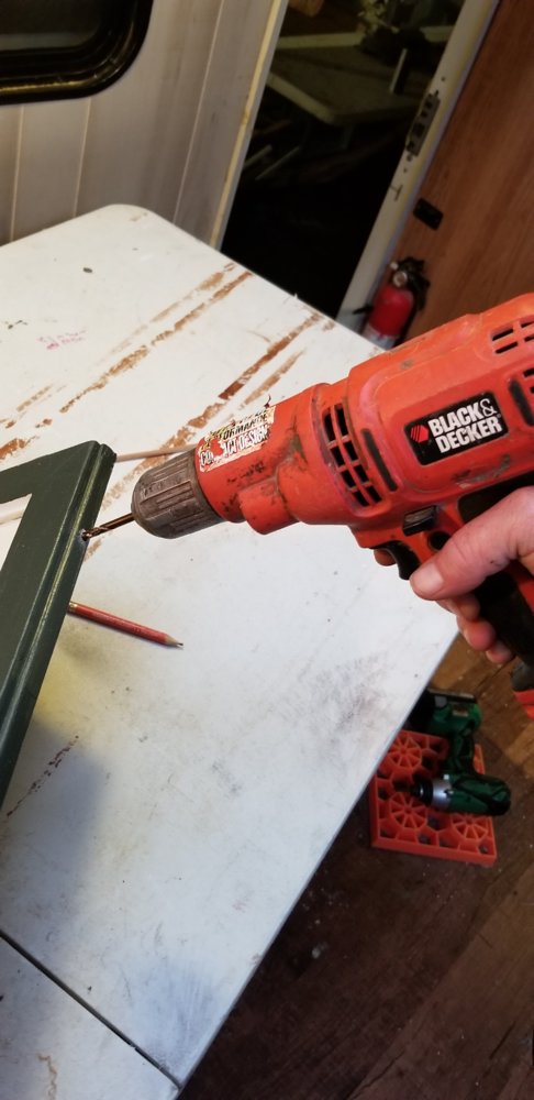

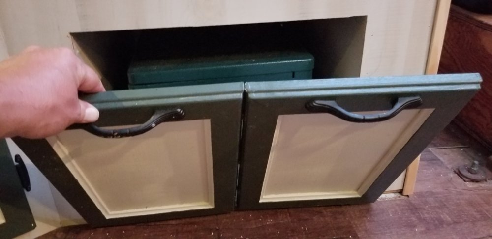

These doors were removed from the bedroom cabinets. I wont be reusing these in the bedroom. So I repourposed them to cover my custom storage space under the stove. One door by itself is not large enough to cover the hole, so I used both of them.

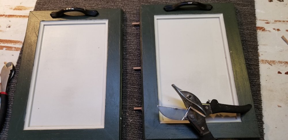

Measured and drilled holes in the sides, added glue and dowels. Now my 2 doors move as one. They're perfect!
Mine doesn't have a loop.
I'd recommend adding a small pressure tank if you have the opportunity. It'll act link a hammer arrestor when the pump kicks on, and will hold a small amount of water to keep the pump from kicking on so much.
