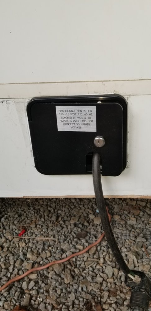

To save money, alot of class C's will have a plug in the compartment that the shore cord is hard wired in. When you want shore power you take the cord out and plug up. When you what Gen power you 0lug the shore cord into the receptical in the compartment which is powered by the Generator. No transfer switch.

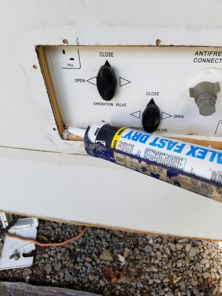

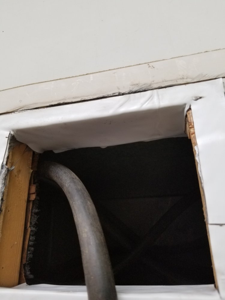

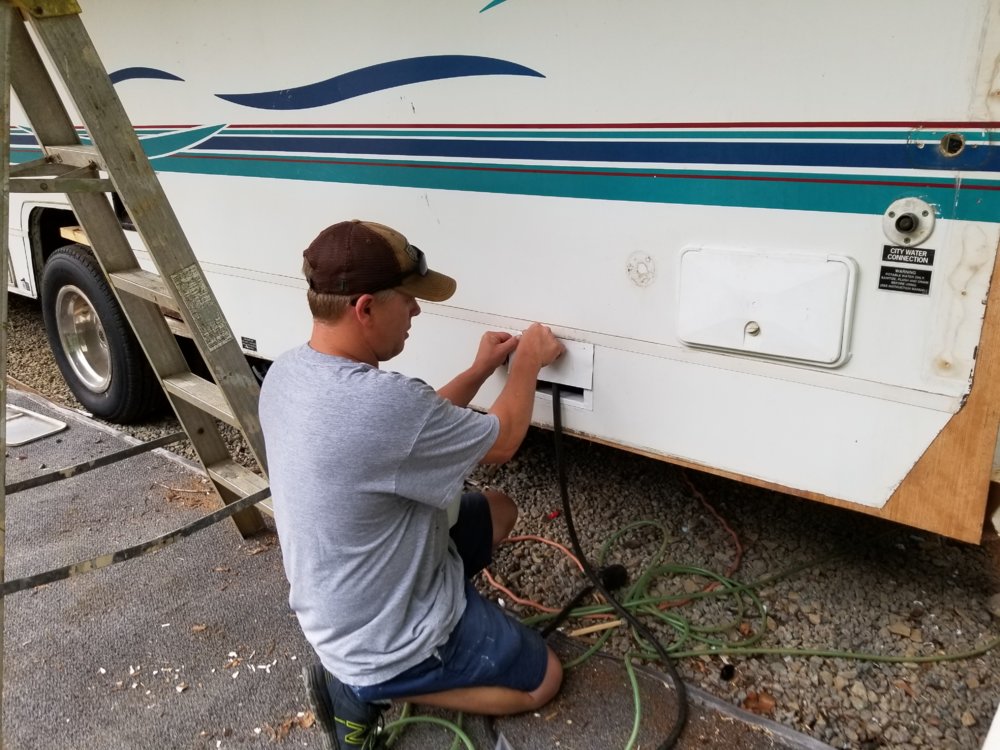

This was never sealed from the factory. Sure, it gets a plastic cover that fits over the wood...but..
I'm adding plenty of silicone just in case.
This is the electric cord box. I'm going a step further than the factory did. I'm adding Eterna Bond waterproof tape around the inside, covering all wood framing.

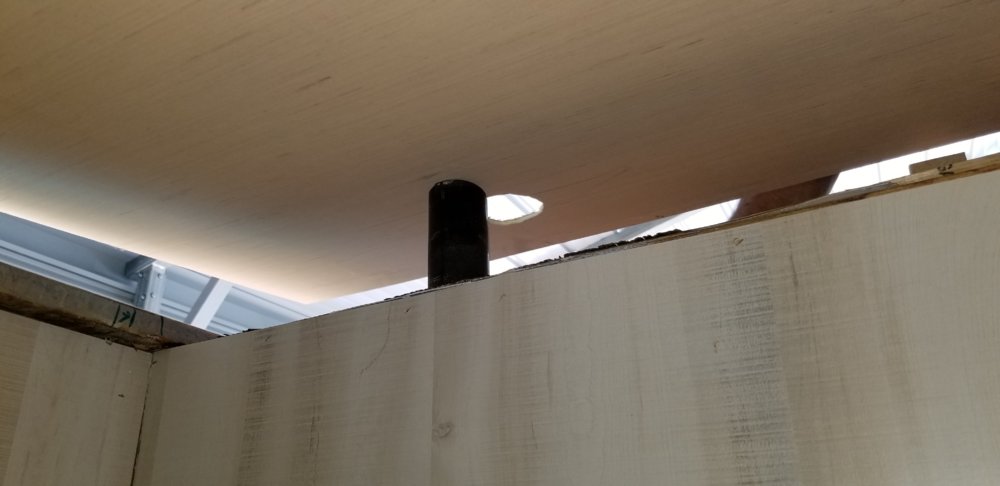

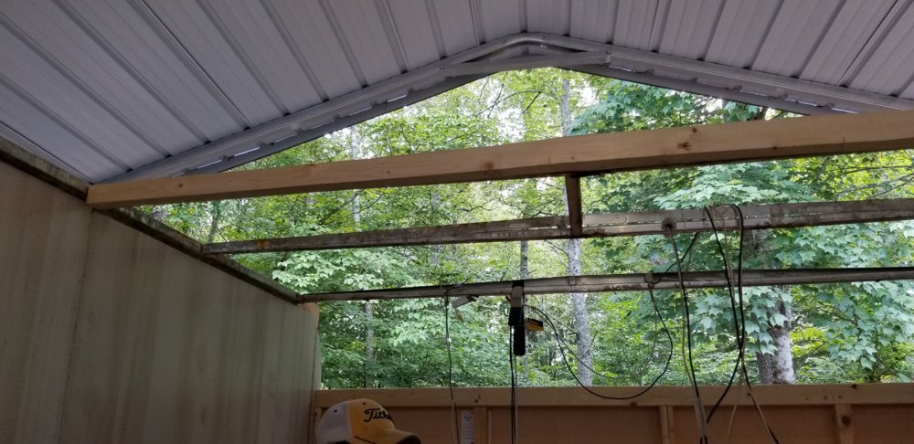

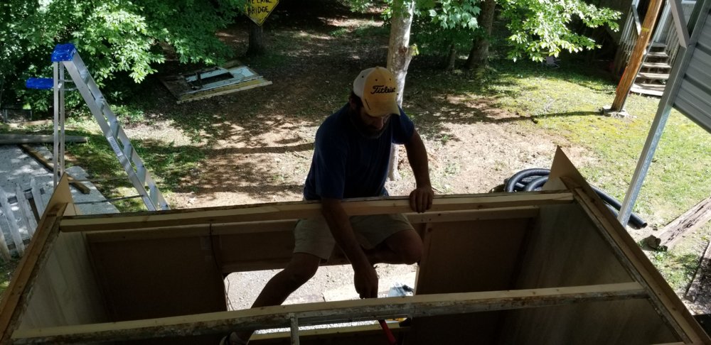

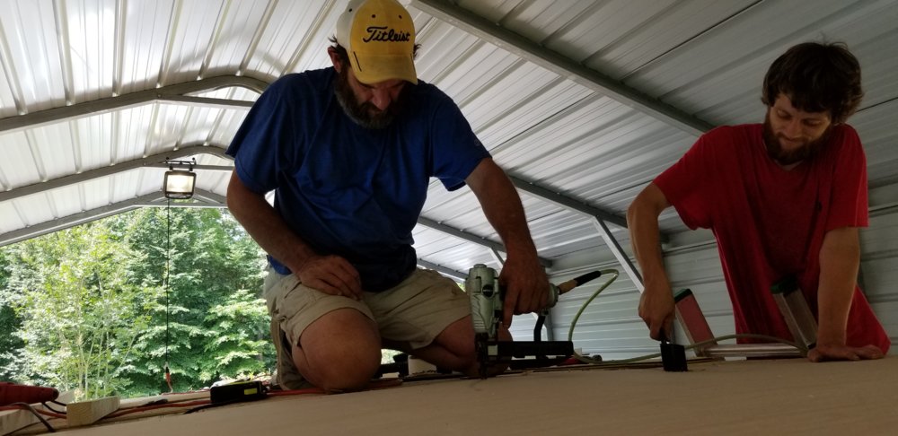

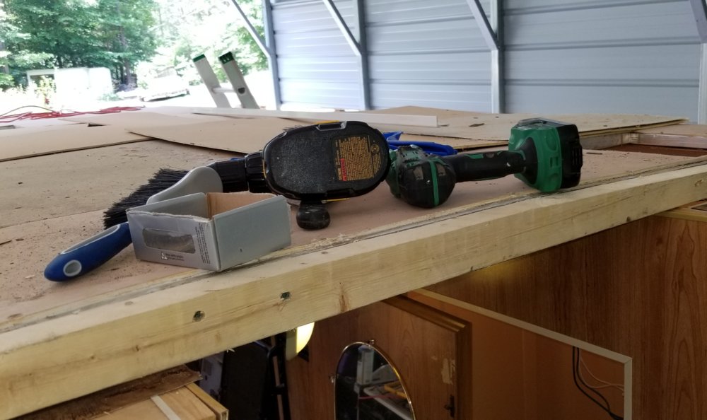

Next it was time to start on the bedroom ceilings.

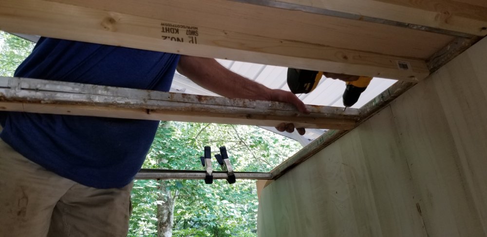

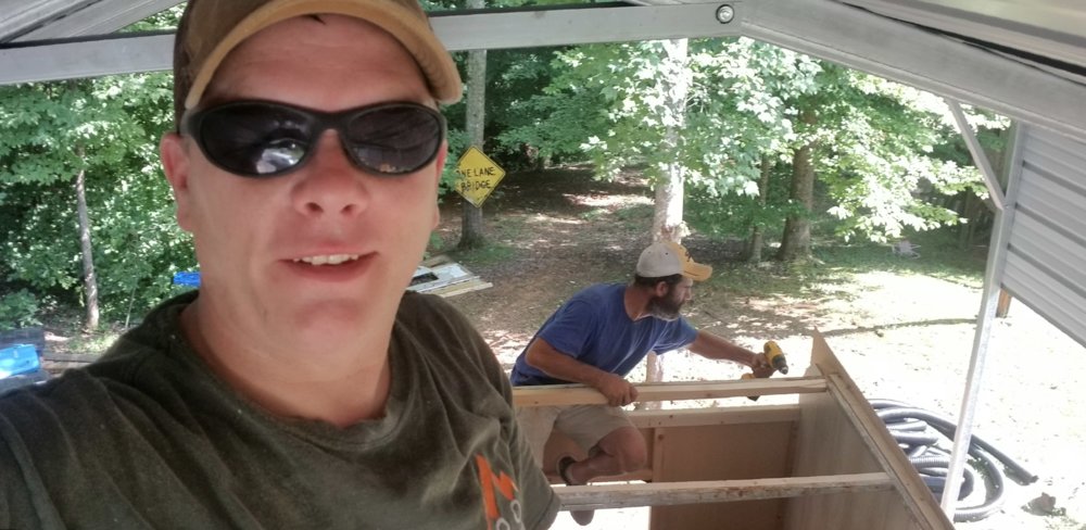

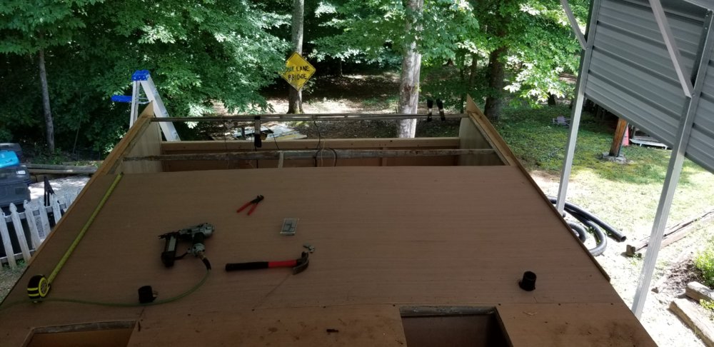

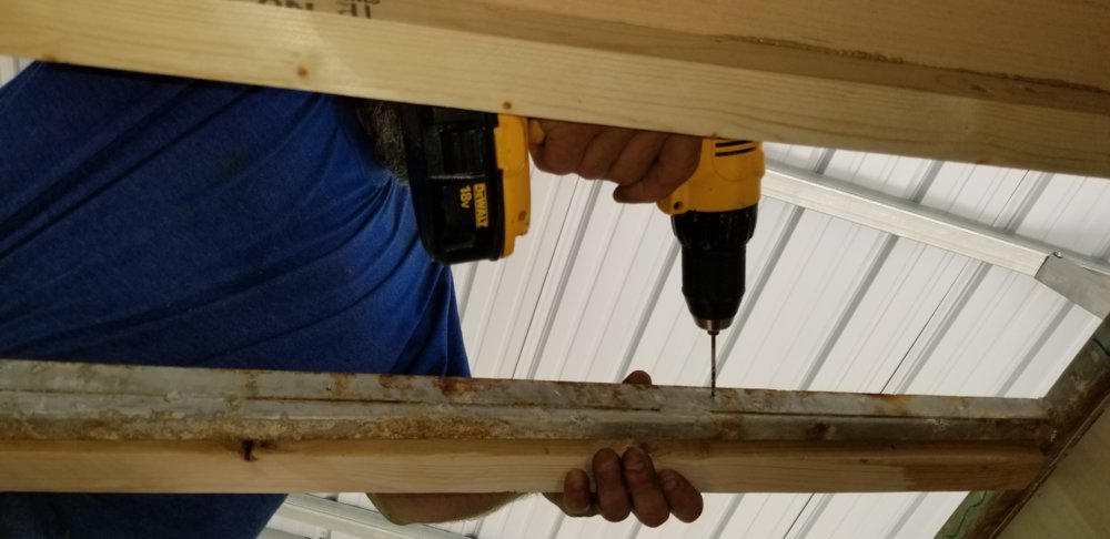

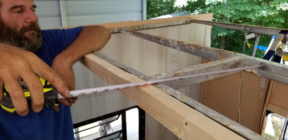

I learned from doing the front section ceilings that extra rafters were going to be key.
Extra rafters will make the roof stronger and make it much easier to install ceiling paneling. I can now staple my paneling to wood instead of screwing to aluminum. Easier to trim the seams too.

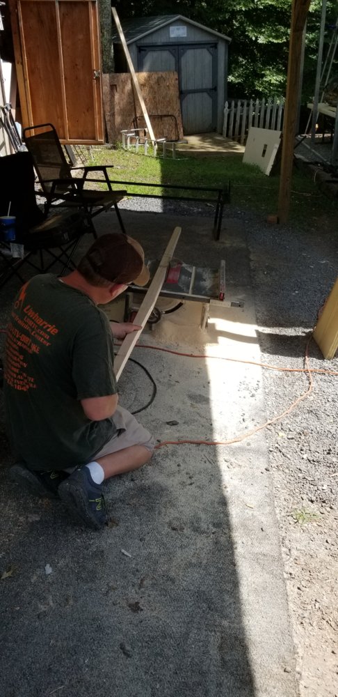

So...I cut some rafters with the correct arch to mimic roofline.(same as up front)

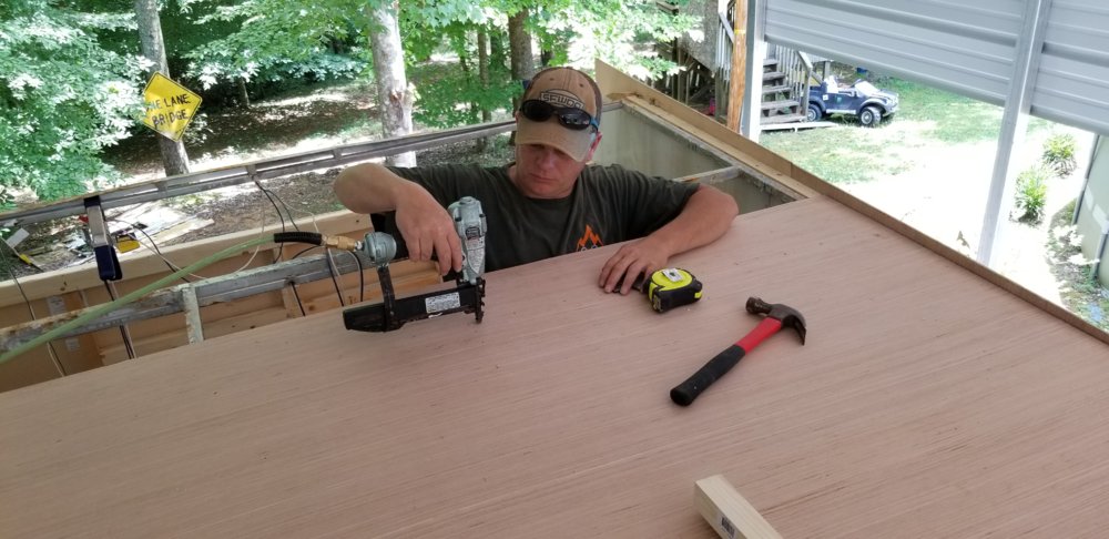

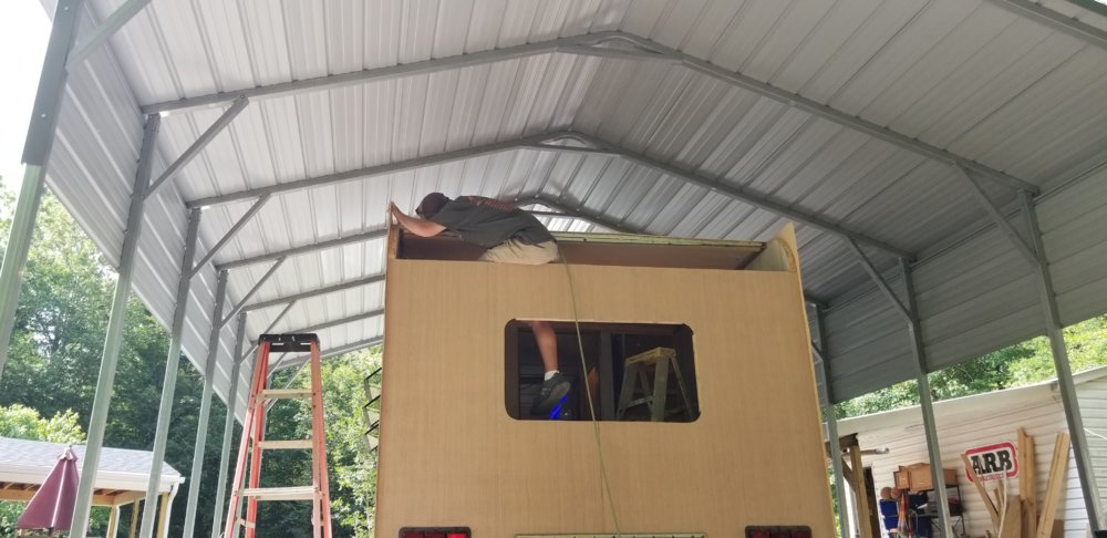

Then we did some measuring, and started intalling. Here's a bunch of peektures.
Pre drilling and running screw through aluminum rafters into new wooden rafters.
I guess the back wall is pretty stout!
