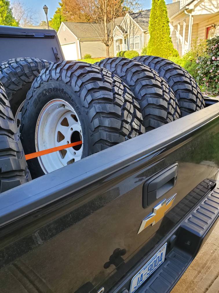

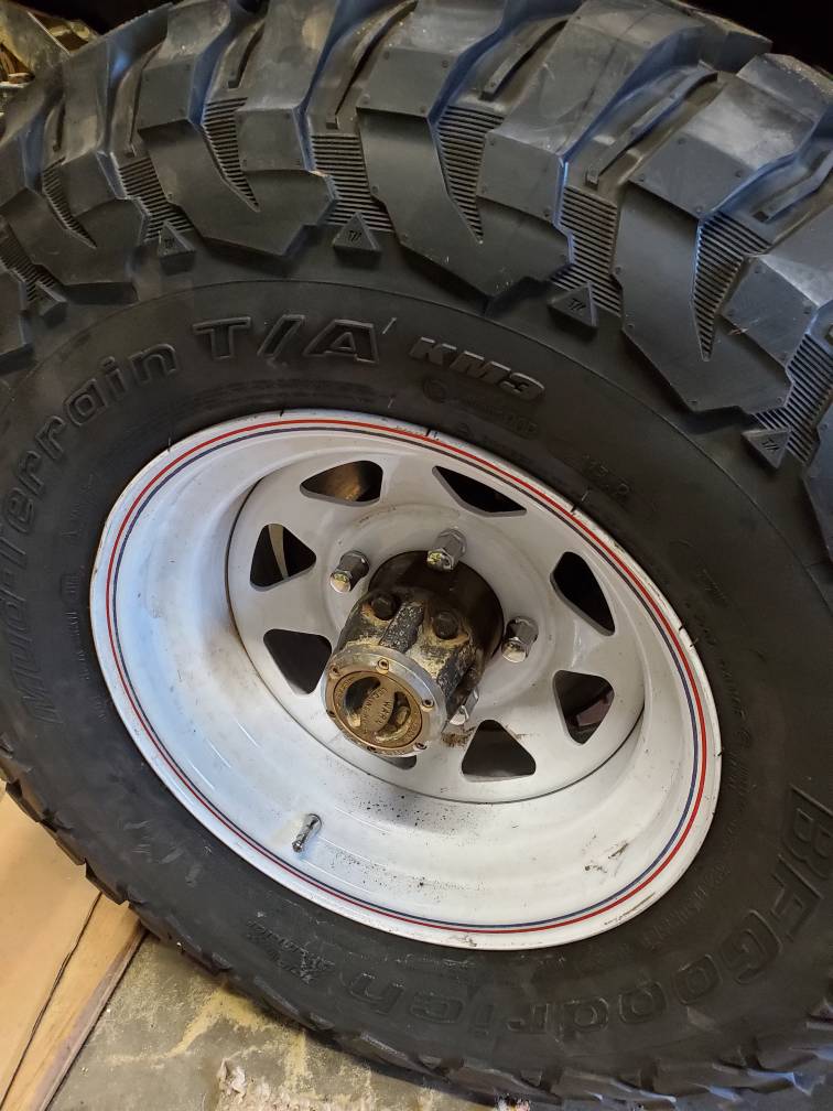

New shoes
Also blue loc tite on the hubs
That's not much of an upgrade....
Bigger/stronger housing than the D30, 30 spline RCV's are quite a bit stronger than D30 chromo's, bigger brakes, plus a marginal gain in R&P strength. It'll last until I transition to a 60/14 bolt.

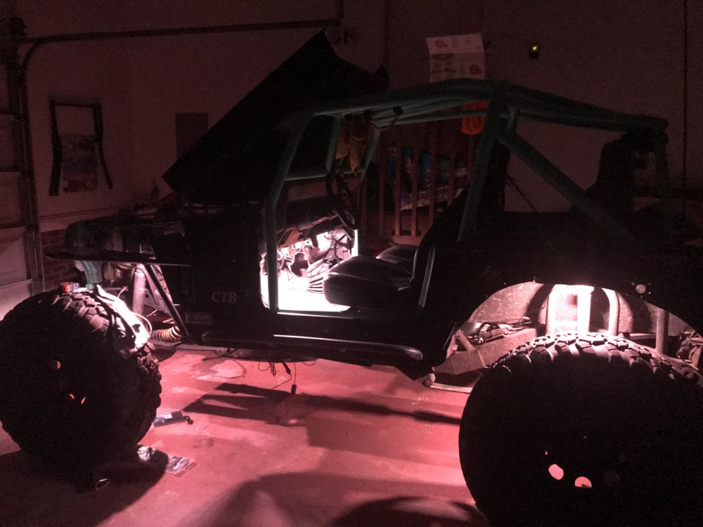

Truth, on a side not I really want to build a buggy and leave the TJ as a TJ and not full on buggyify it. Even though my progression will prob be TJ to Buggy, then shit buy another TJ that will get turned into a buggy. Rinse lather Repeat.

How heavy is that tin box YJ of yours with the tub split down the side? :D I believe weight to be the real killer.
Light a nimble, low and wide. That’s how I ride.
