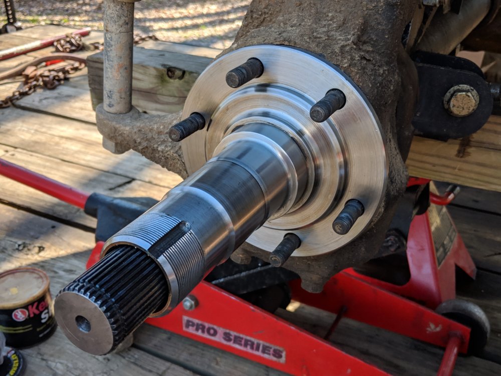

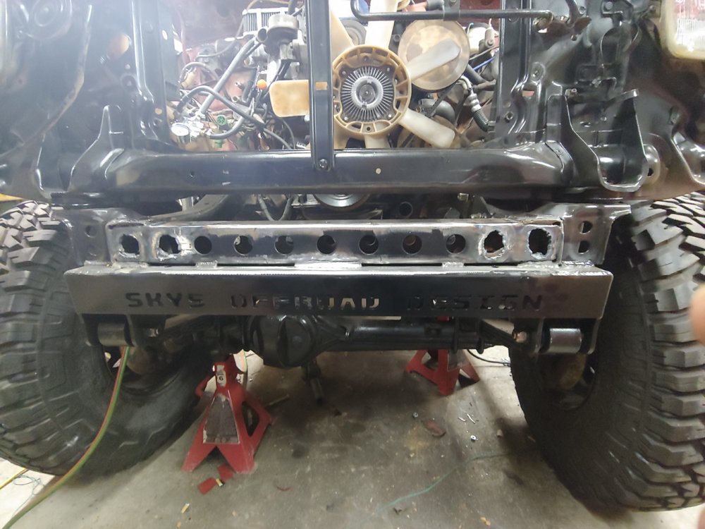

ECGS order showed up. Slapped the front back together. Technically she's ready for another round but I'm going to do the other side first.

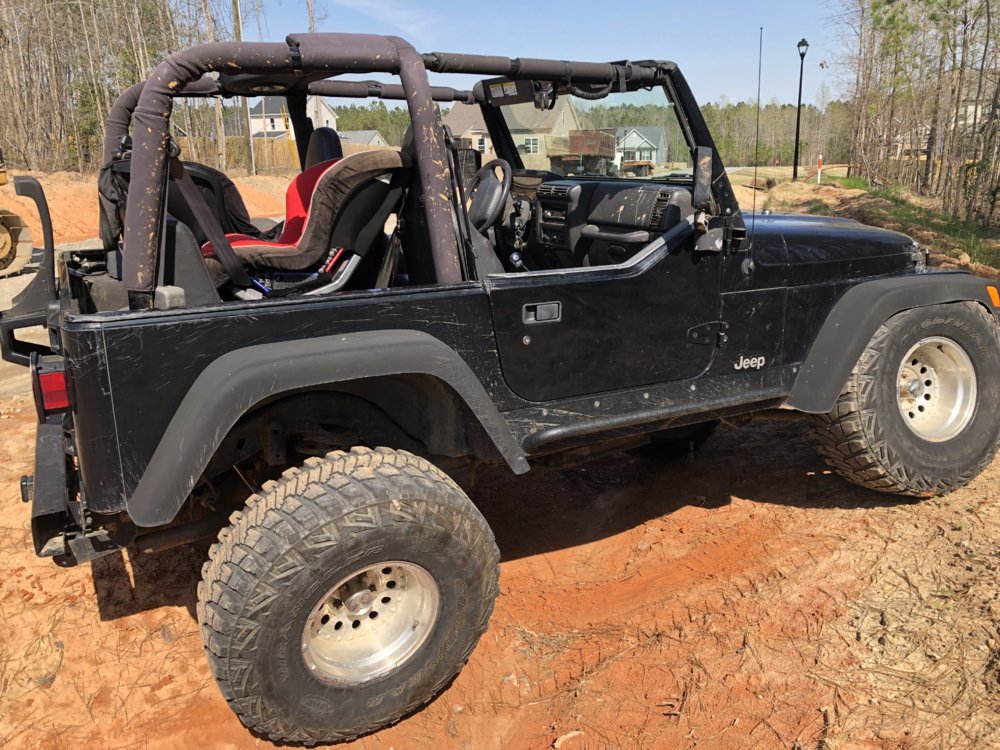

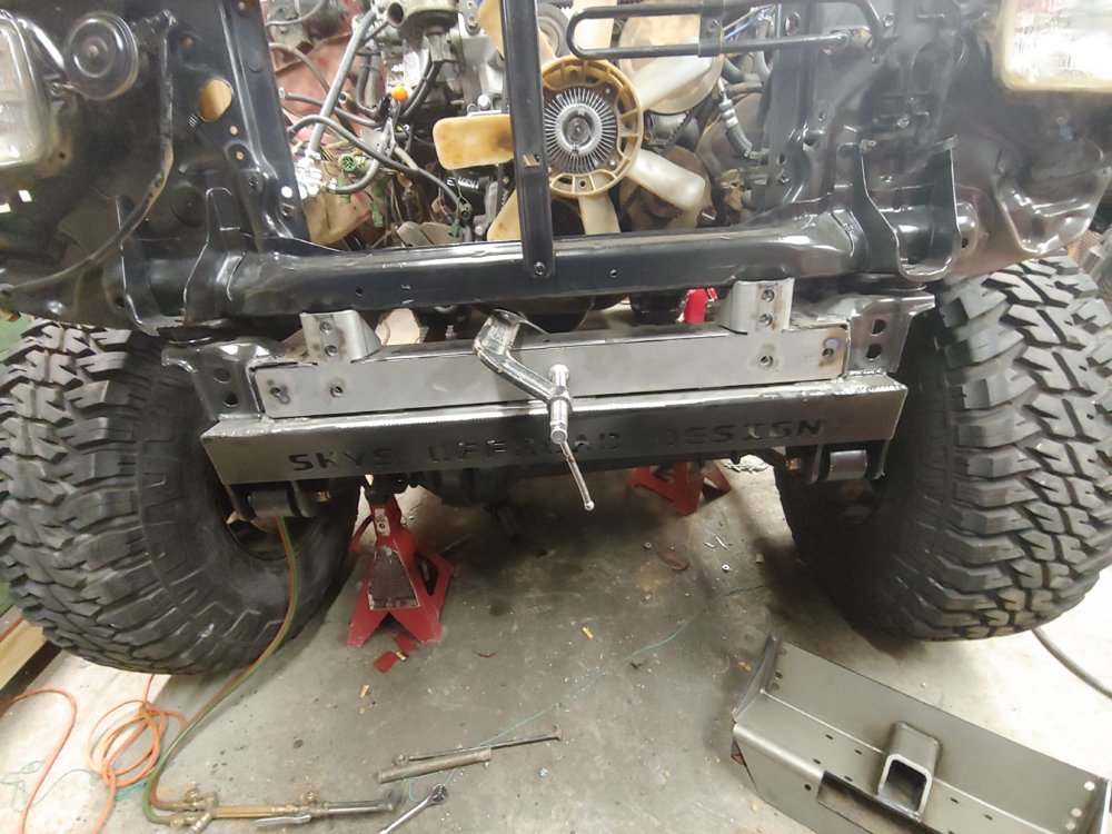

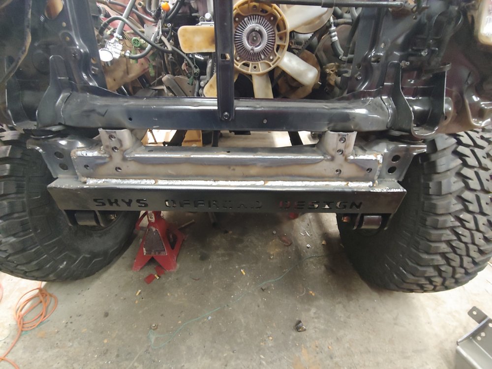

Finally got around to welding reinforcing into my winch plate, now I can use it without worrying about it flying off! New fenders, old camper shell, put the seats in (ratchet strap to hold driver seat in). Drove it around the yard, ripped out the plastic inner liner on the new bed first thing.
Debating on ordering the new seat brackets, steering, or putting a new windshield in, BUDGETS SUCK!

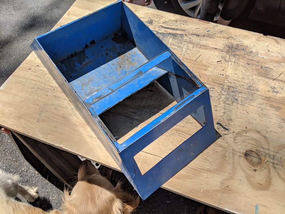

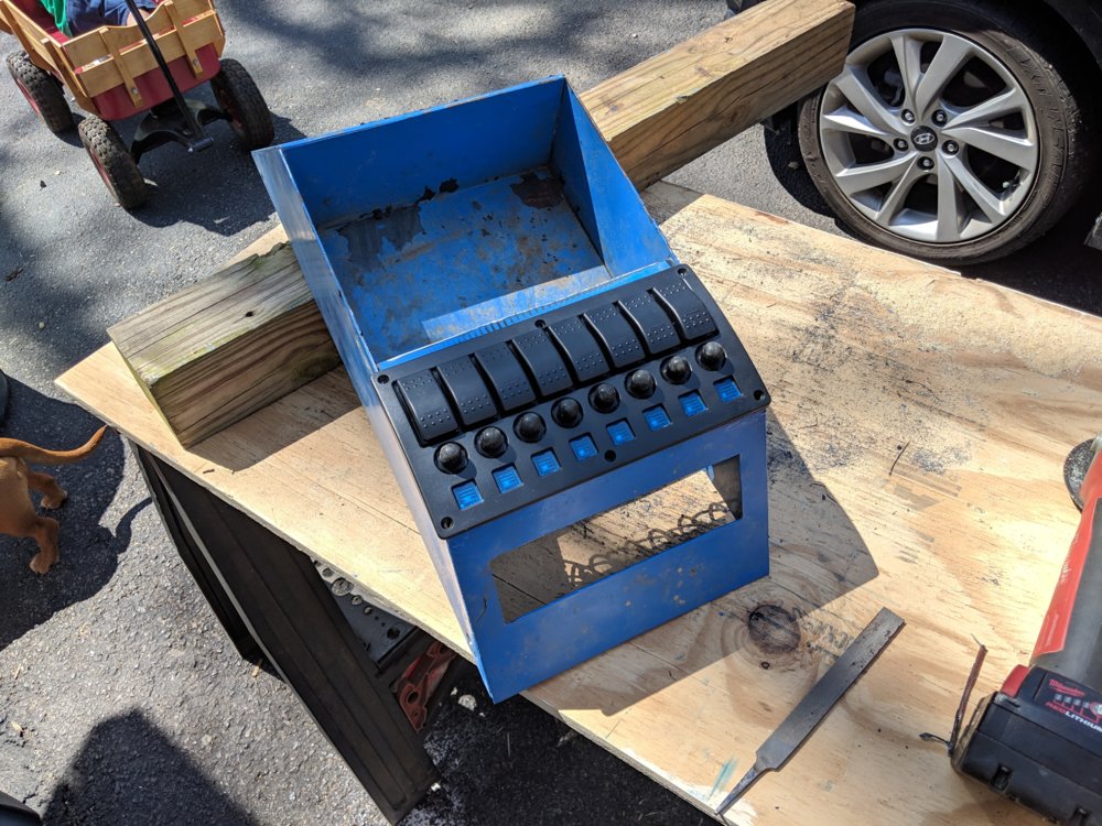

Started cutting my center console up to fit my new light panel.
And yes I'm aware it hangs over a tad. It's between the seats so you'll never notice it and it beats having to fab up another console. I did some more grinding and it actually fits better now and doesn't hang over the front. At some point I'll post a pic when I'm finished with it all.
