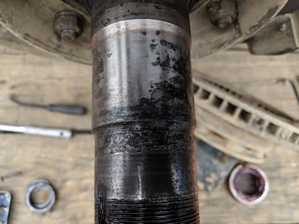

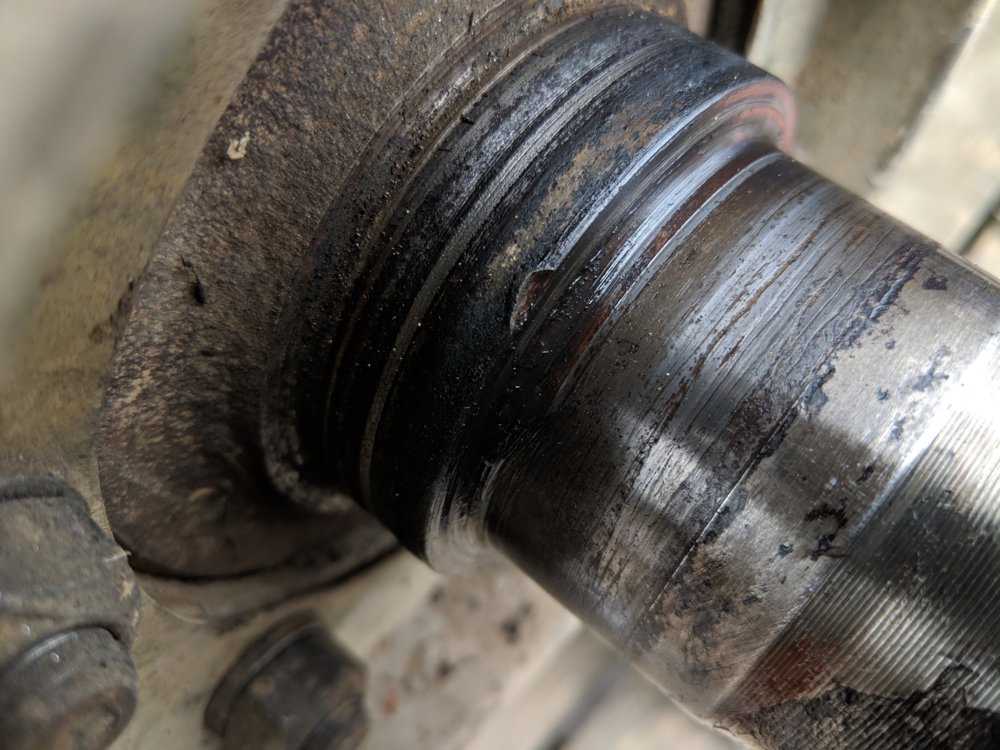

The wheel bearings were next. I took the driver side apart and found the spindle to be cherry.
So I called ECGS to get a spare :rolleyes:. It'll be here tomorrow and I can throw it all back together. I went ahead and put all new races and bearings in too while I was at it. If I can remember to have everything tight and put the spider in correctly I should be golden for a while.

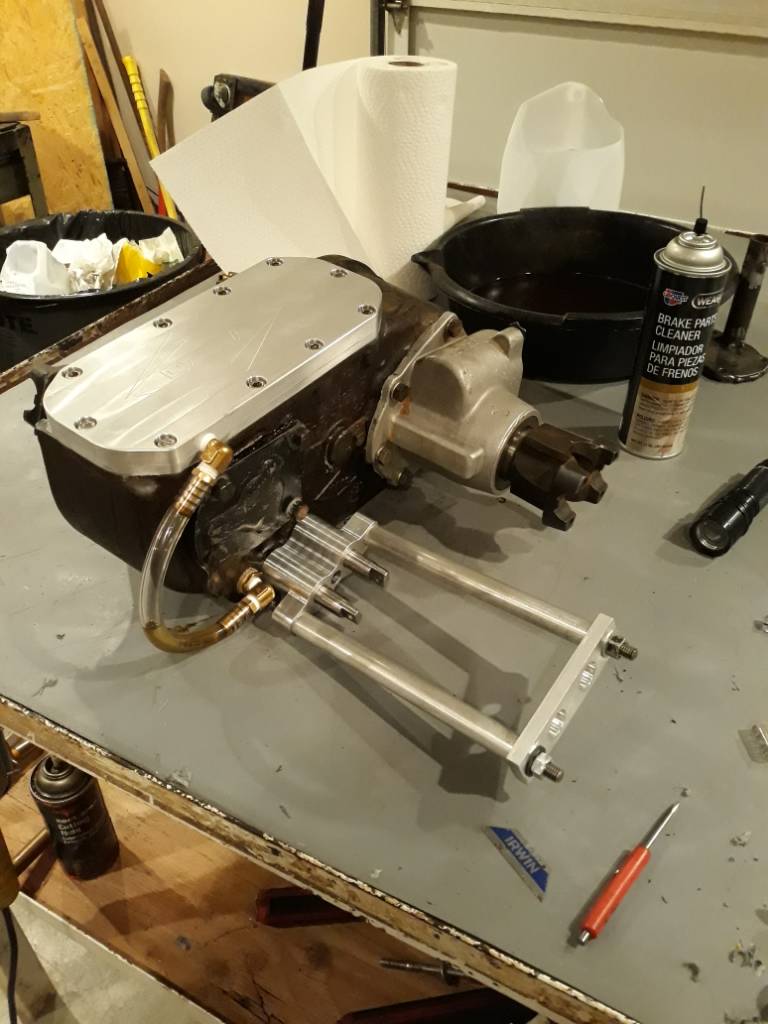

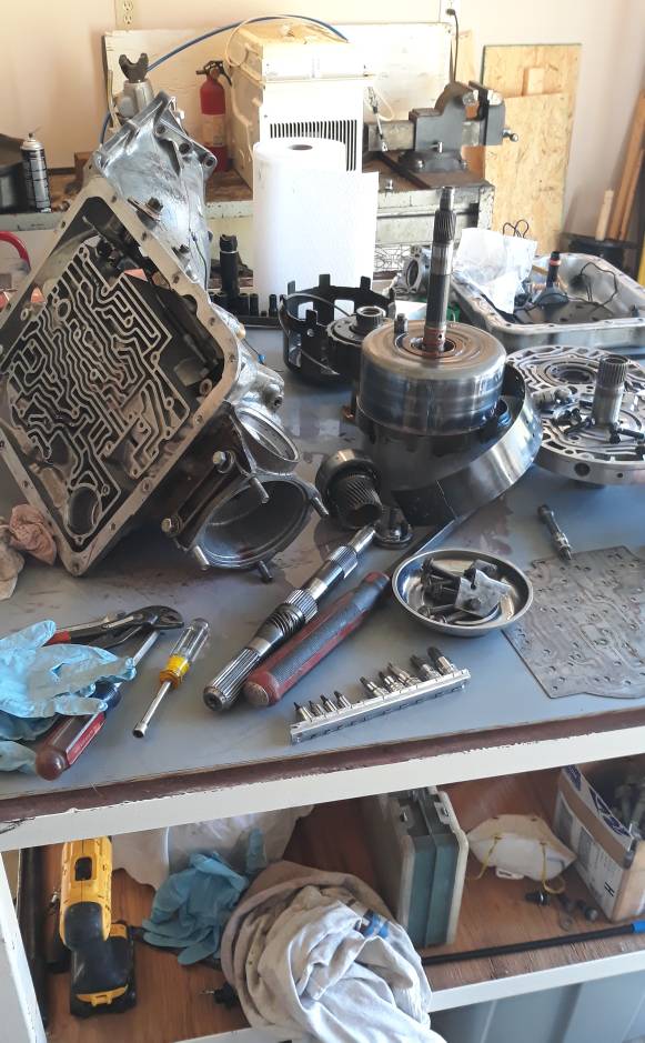

Was having issues, so I pulled this one a part. Found a broken spring and some trash in the pump. Decided to take my unknown condition spare to a shop to be built. Should get it back this week. Tore my 300 back down. Seems I created a hydrolock the way my shift rails were capped. Pulled them out and ground a groove that should let oil escape. Reassembled and ready for the trans when it gets done.
