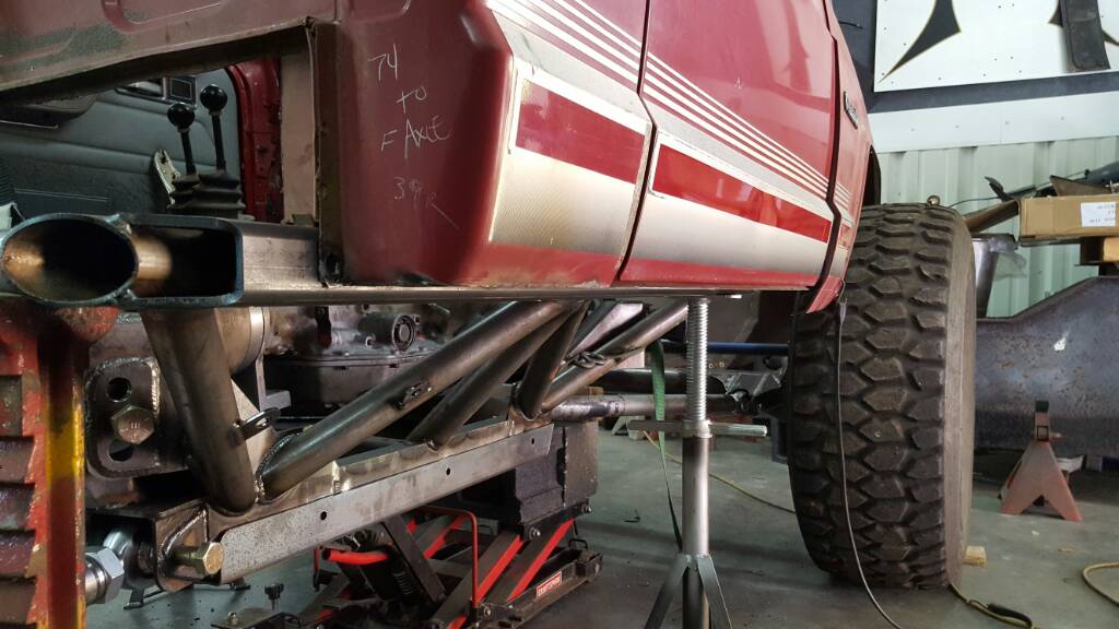

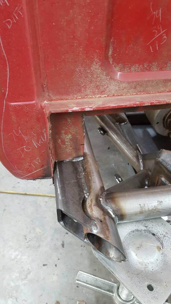

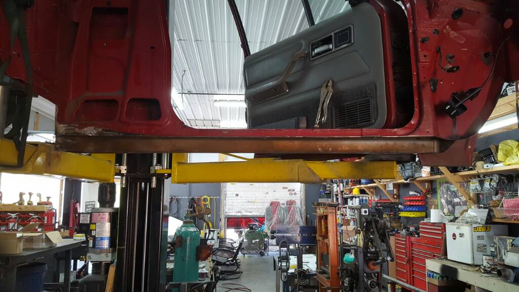

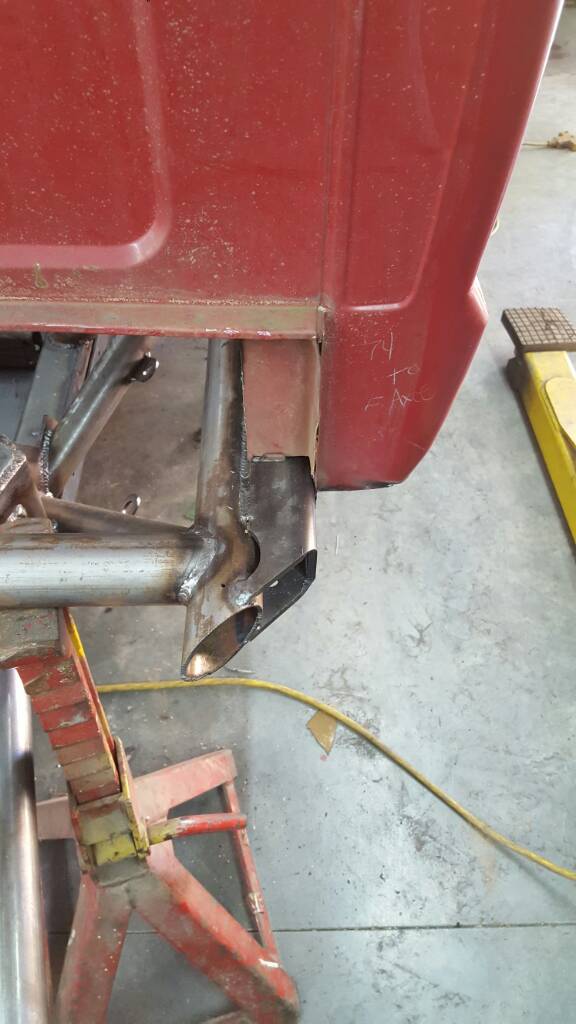

Was able to get the rockers cut out today and get the cab sitting on the subframe. Amazingly, the outside of the rails was the exact measurement of the inside of the pinch weld on the rockers. You can also see how the interior side rests on top of the rail, 1.75" higher than the bottom of the door. Over-all, a very good fit.
Matt
This thing sure is a ton of AWESOME! That subframe assembly is super clean.

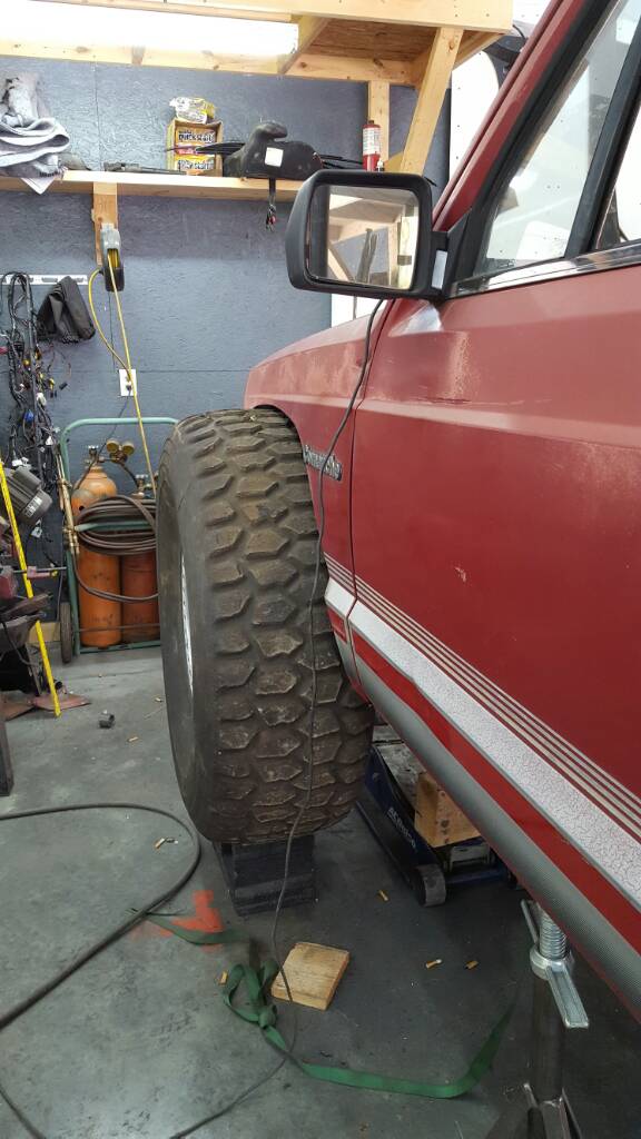

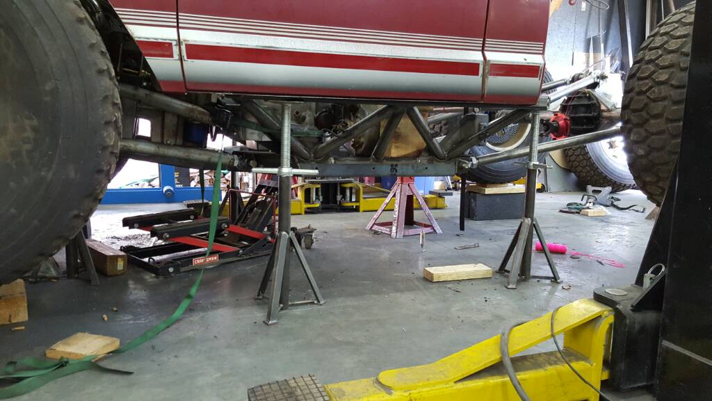

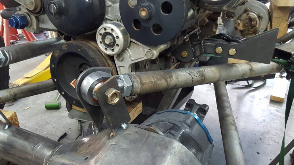

Good progress today. Got the front axle and link locations finalized. Cycled the suspension and cleared/trimmed the cab sheet metal. Also got the rear link lengths nailed down, aligned and cycled.
The truck is now sitting at full bump. 8" up in front and 10" up in rear.
Managed to get 40 degrees of steering, with the lower links being the limiting factor.
Matt

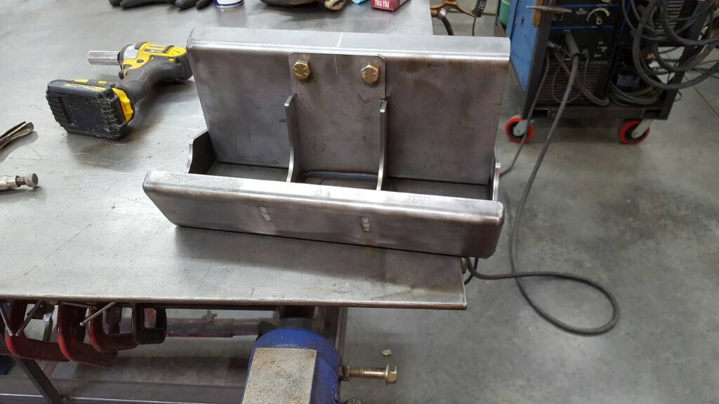

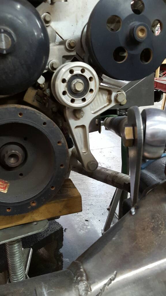

Also started assembly of the Goatbuilt ram mount for fabricated housing. The upper links will mount off the back corners of this. A very simple, yet effective design with a removable skid for ram service.
Matt
is the 18 inches at belly at ride height?
Yep, 18-19. I know sounds low, but I like low. Buggy was 19 belly at 117 wheelbase, with 43 sx. Should be fine with this set up, I have the roughly the same differential clearance as before, roughly same belly, but shorter wheelbase at 115. If it drags, I picked the wrong line, so I'll drive faster....[emoji41]
Btw, low belly is a sacrifice for great fast or slow speed, and stable geometry.
Matt

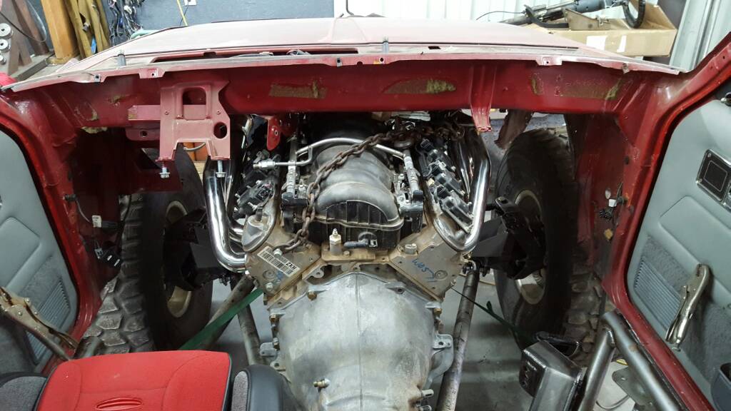

But what does it look like with a sasquatch in the seat? Gonna be warm on the legs/feet.
Actually I think it will be cooler than my buggy was, with the headers up and forward rather than down and back. My side firewalls in the buggy would scald you with shorts on. Fortunately, if your not 6'4" like myself, it's not nearly the problem anyway.

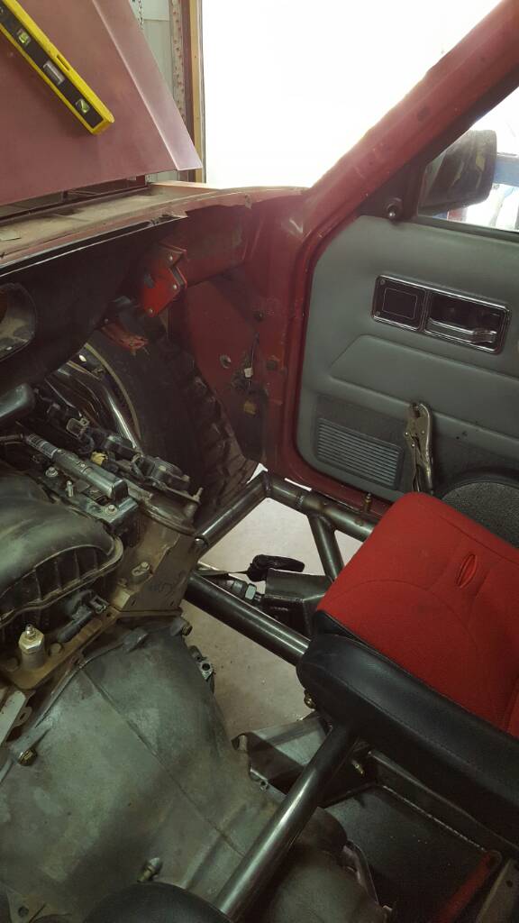

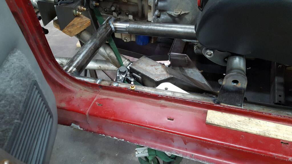

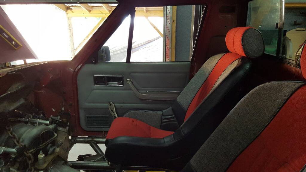

Finally some noteworthy progress.
Seats finalized, front mounts anyway. Will get the rears in once I start the floor. 54" at widest point of seats. Leg room appears tight and awkward, but it's more comfortable than it looks. Definetly no less tighter than my buggy was. Can finally get this cage rolling.

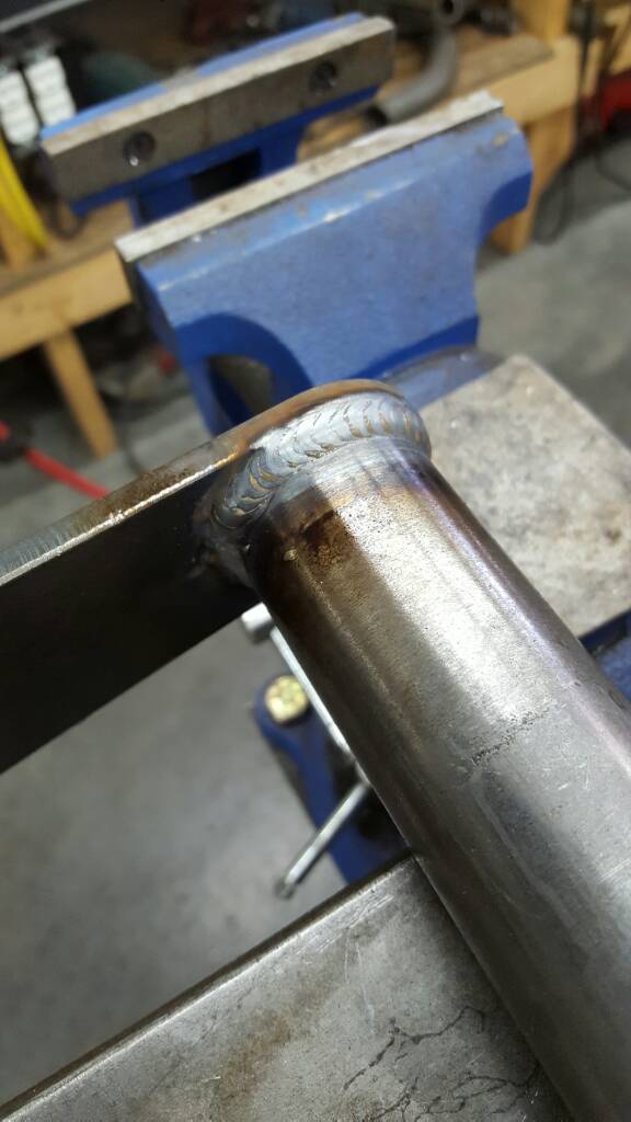

And the obligatory weld close up...
