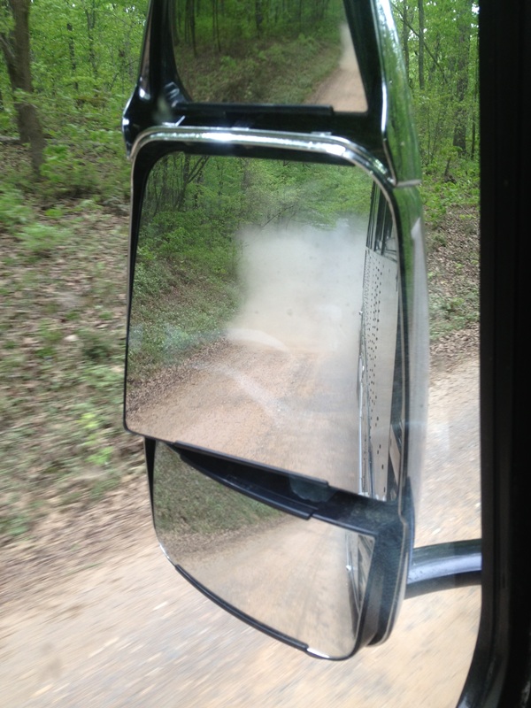

Well got the drivers side mirror installed last night and hope to work on passenger side tonight
If you don't mind me asking, where did you get the mirrors. I'm purchasing an older motor home that has pretty shitty and small mirrors and I'm having a hard time finding better mirrors.

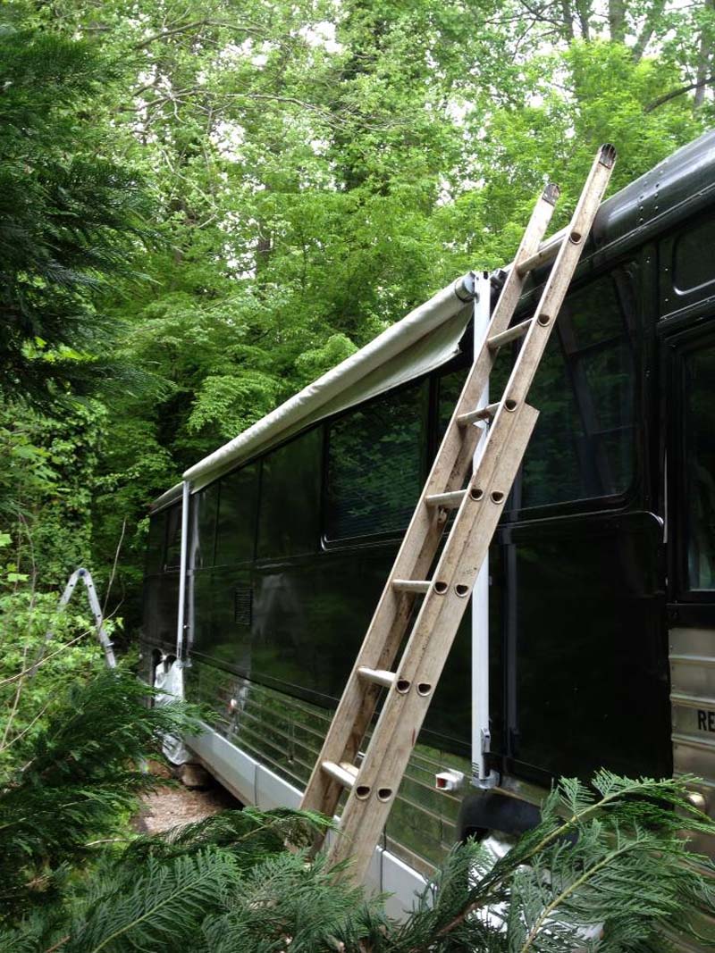

Well finally found a good deal on an awning.. but had to get it it late the other night to get the deal.. and I did not want to tow the trailer.. so I wedge the 20 foot awning into my avalanche :)

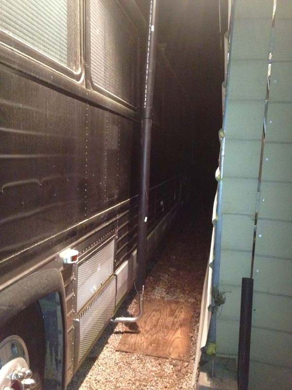

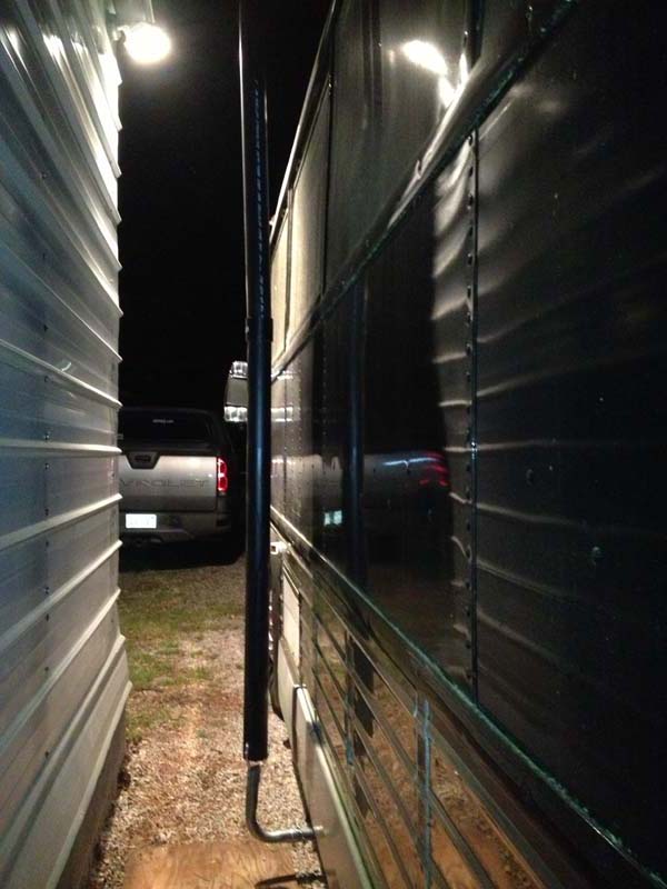

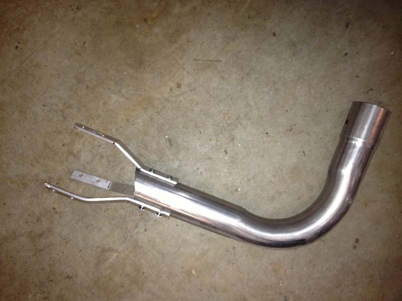

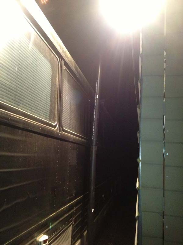

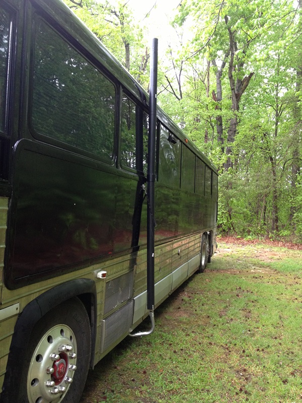

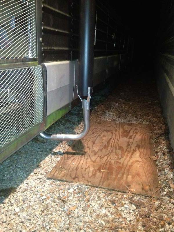

I also have been working on generator and I am pretty sure I got it all working and plan to test it this weekend..but wanted to get the exhaust up and over the bus roof line so not to burn the ground or bother others.. found a thing called Gen-turi, but for $140.00 I said screw that and built my own for $40.00
here is piece that slides onto exhaust
here are the other pieces connected.
Is the plan to put that on the Gen exhaust every time you use it?
yes, it slides off and stores under bus when in travel.. then when you park I slide it on put a pin threw the metal and connect the black pipes..
thats what i figured, just havent noticed it on RVs before. Does it really make that much of a difference in noise? Most generators or small engines i have run, the engine is louder then the exhaust.
It doesn't really make a difference in noise. It's just to get most of the exhaust up and away from ground level.
I'm actually thinking about rerouting my generator exhaust back to the rear of the trailer for similar reasons.
yup, no noise reduction with this..
reasons: get hot exhaust off ground especially if in grass, and to get exhaust fumes up in the air so people walking around are not breathing it.. I will test it friday AM to make sure it works.. if it works correct and I set the gaps correct then you can take a piece of paper and put it pipe at bottom and you will see paper fly out the top.. that means it is sucking fresh air in from around gap and mixing with exhaust fumes as it goes out the top..
some nicer camp grounds that have no power hookups require these
While both of your situations wouldnt be applicable, I would think that tieing it into the engine exhaust might be a nice option on most RVs
