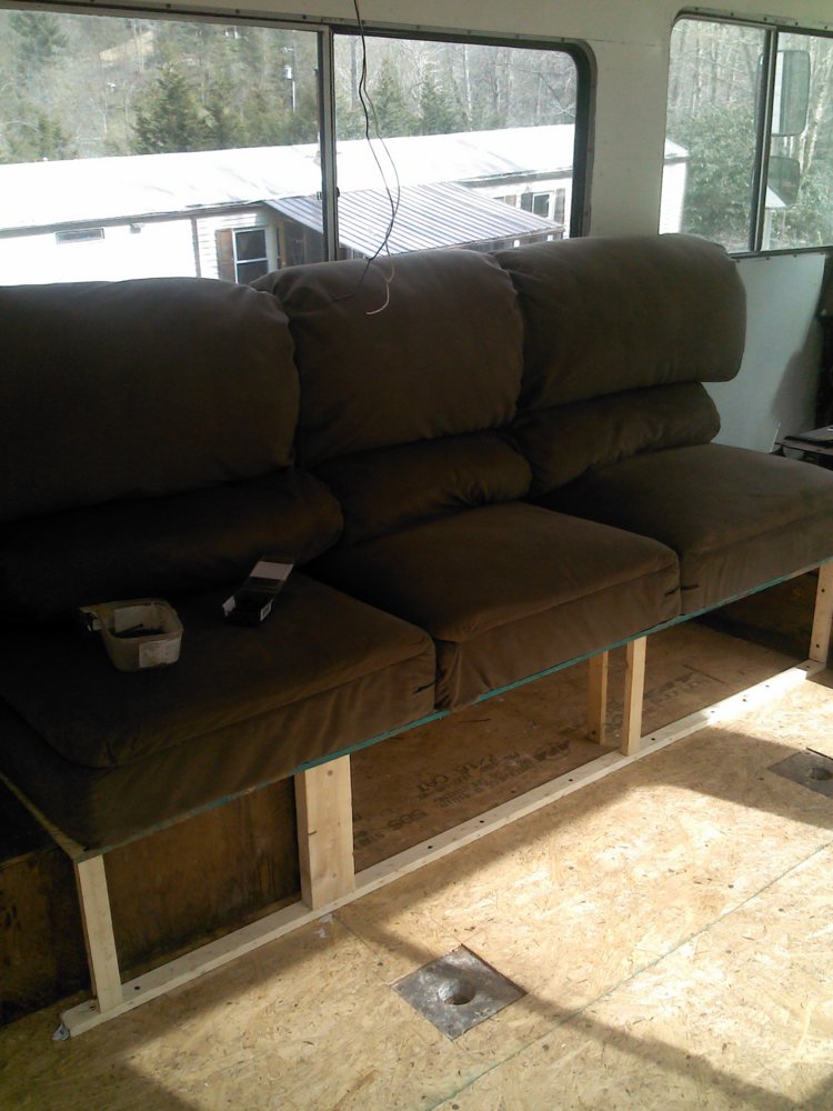

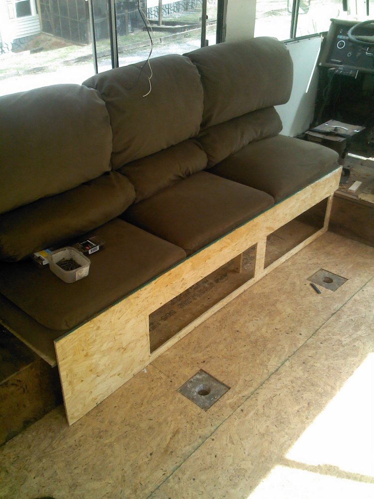

got to do some little work on it today...started on framing the couch on one side and the storage drawers underneath and pretty happy with that progress. I found a stupid good deal on a nice loveseat for the house so I took the couch from the house that I'd been wanting to get rid of anyways and cut it to fit in the RV...worked out pretty good and it's way more comfortable now since the cushions sit tighter together and on harder platform. so here's that progress...

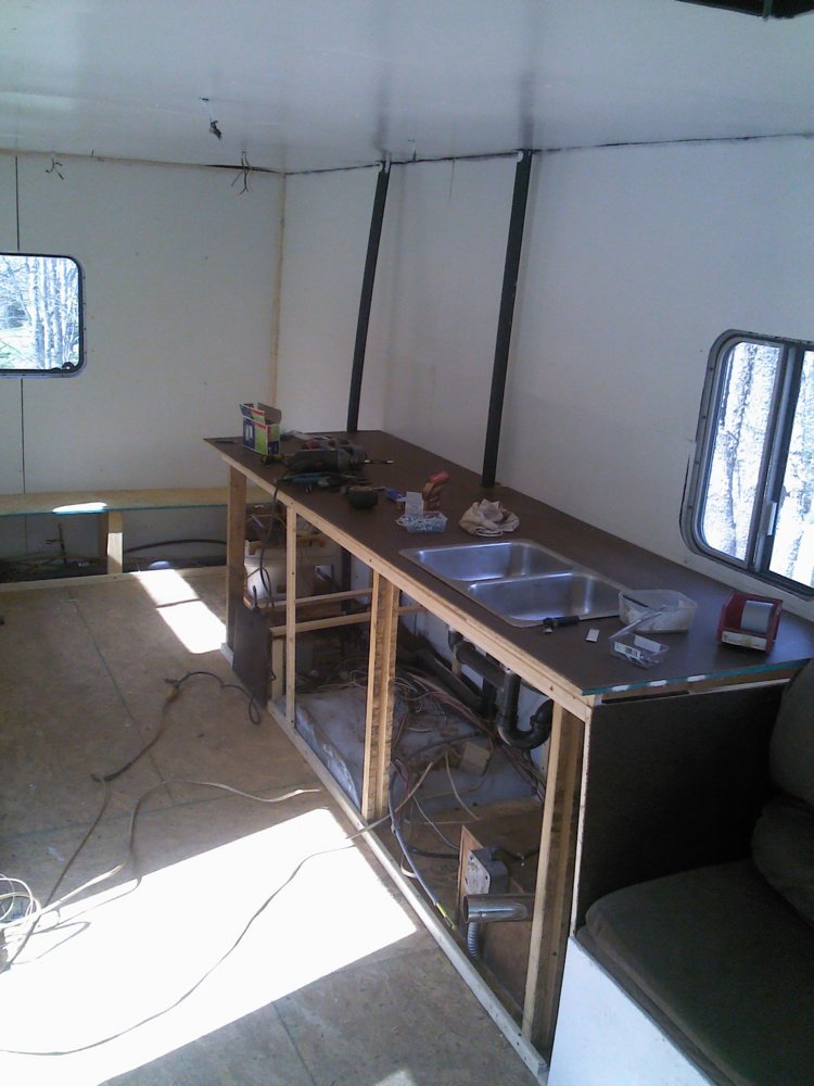

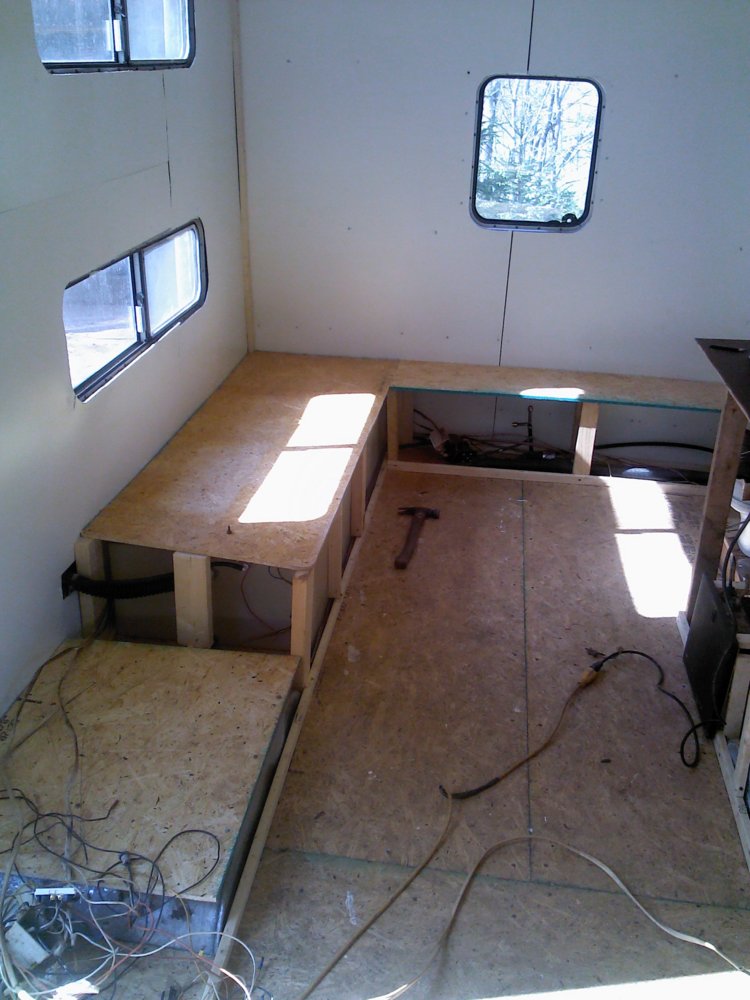

well, I've made a little progress...Kitchen counter and the water tank mounted with new fittings and filler tube and filled it up enough to check for leaks..all good! I got the framing for the "bench bed" done and the back wall entertainment stand bench done too...can't wait to get the entertainment center setup, it's gonna sound good in this thing!! (now that spring is here, lawn care/landscaping is back in the work so not as much free time but still getting it along).

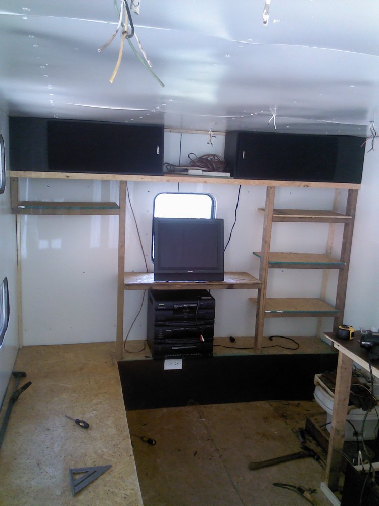

well I got some awesome work done...finally got the "Entertainment Center" framed with some shelving...I LOVE IT!! SOUNDS AWESOME! At half volume with those 1981 Fisher Cabinets, it was rockin it. I can't wait to be at a stop light next to some kid with a car system....at 3/4 volume he won't know what hit em LOL. (yeah, I'm still a little kid at heart). I love vintage stereos. I have these Fisher 10" Cabinets and in the house I have 15" Fisher Cabinets that would blow out every window in this thing. The 10s sound really really good and clear being mounted up top and the bass isn't as overpowering so it is amazingly clear crisp sound even 20ft away I could understand every note.
